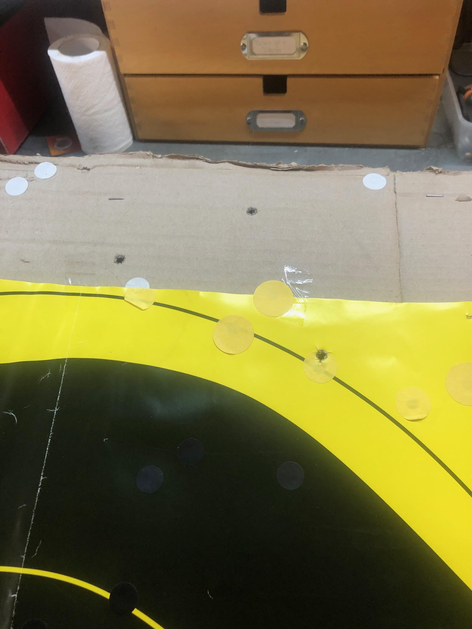

Post by Vince24 » 24 Aug 2025, 9:30 pm
yeah but mine is shooting WAY too high.
With the rear sight setting at 100m, I took 3 shots at the military target placed at 300 yards. It was still 50cm too high ;)
Look at the pic below. The group was good though, for 300 yards!
Given it's the same discrepancy at 100m or at 300 yards, I wonder the barrel might be bent...
Thanks for the advice, I will see what Trail Boss does with this Mosin.
