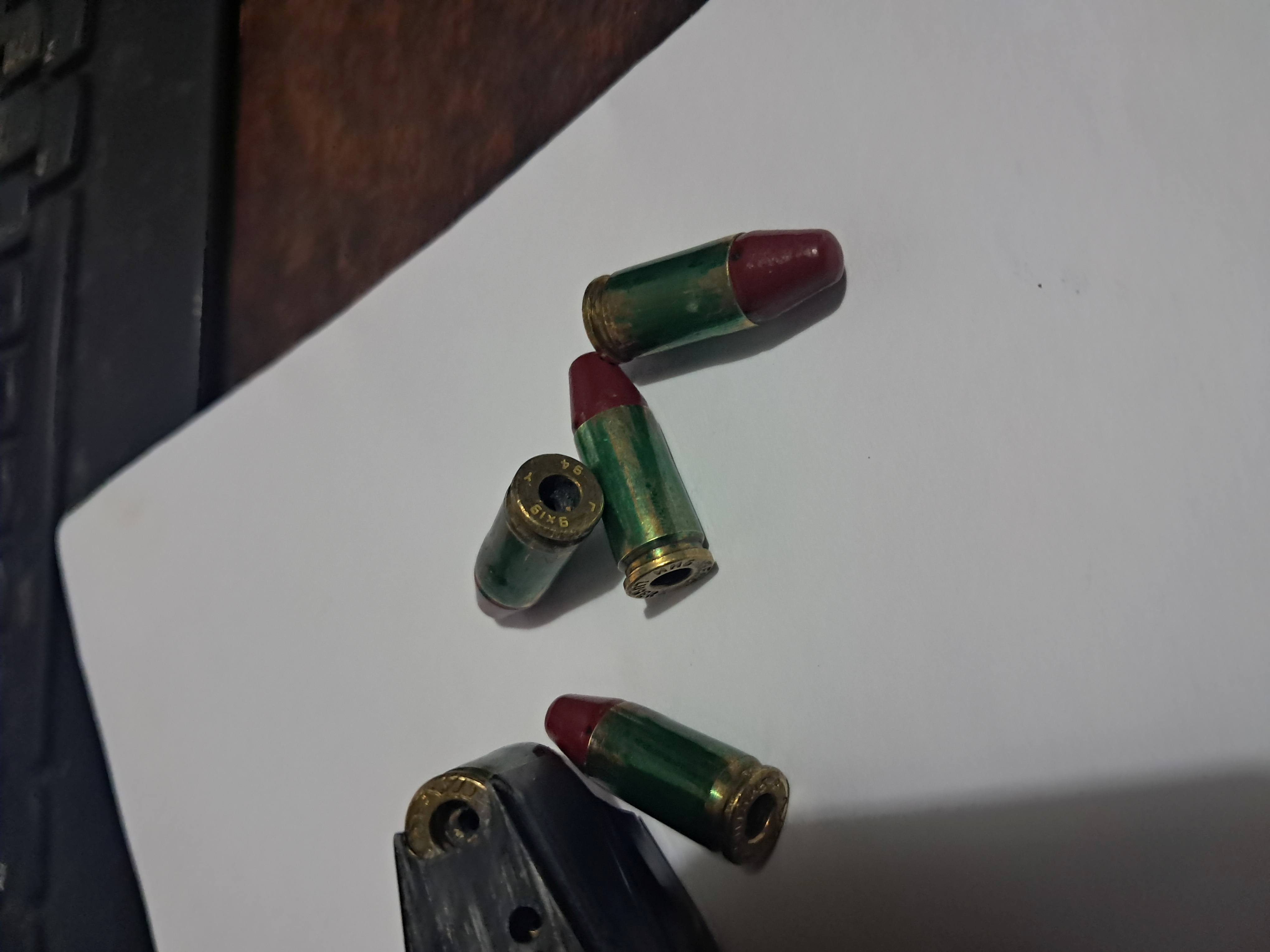

I made up some of these as well..Power factor 0...

Great work! I'm really surprised that ADI have 3.2gn listed as max as it's a fairly light load in my opinion.
The dummies are useful for malfunction drills, stick one or two randomly in each mag when you're practicing.

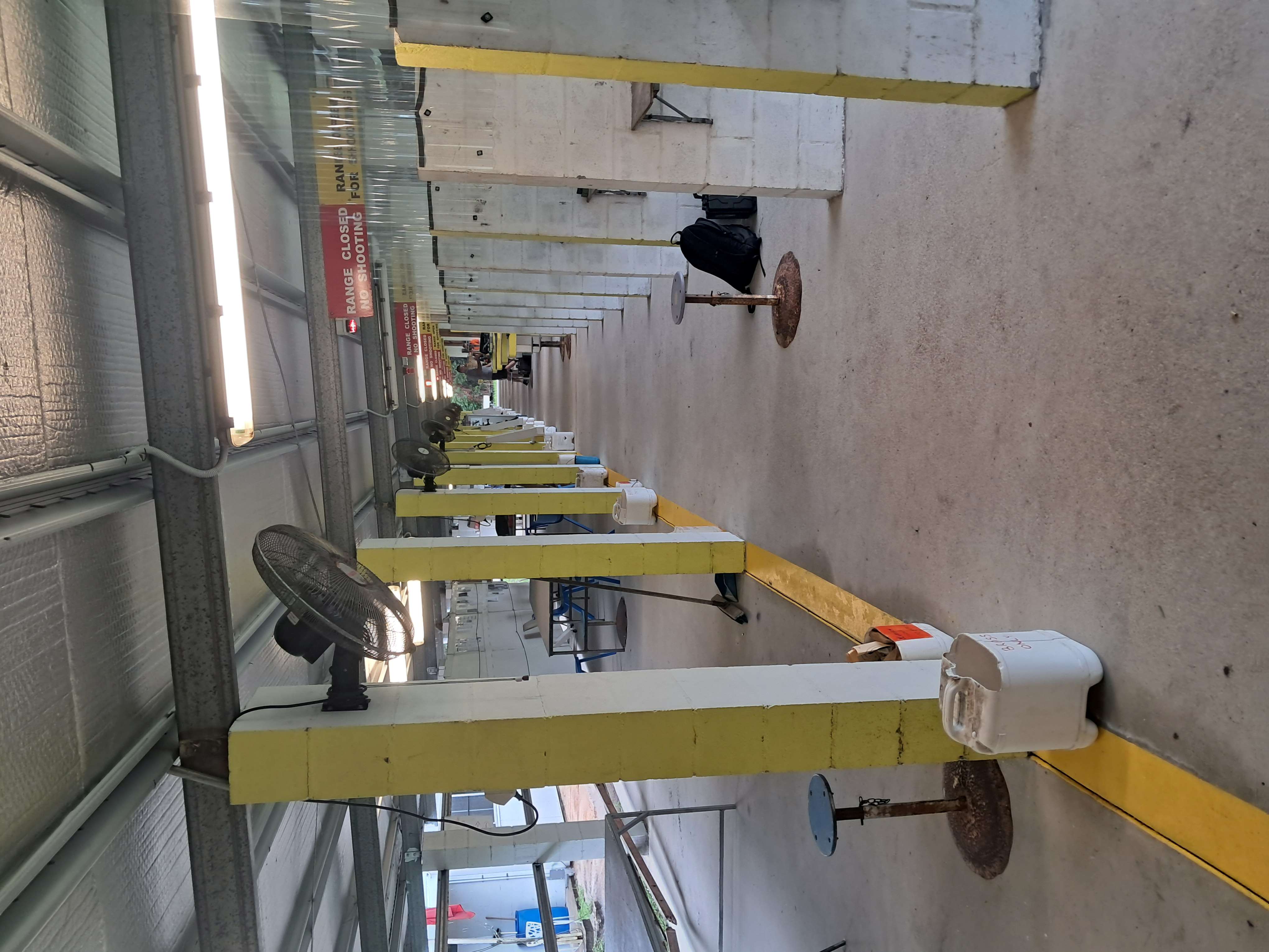

Also pic of the fan set-up. at our club..you can chose a stall or bench close to the fans or in the middle of them a bit further away like I did on the weekend because I was I wanting concentrate on doing some testing and dint want my hair blowing around..lol....

Those fans look good, but I'm shivering at the thought of switching them on for three-quarters of the year down here :-) Right now it's pretty much a sweatbox still, especially in the air-pistol ranges, but in the winter it gets icy in there. Good looking range there. We only have nine shooting bays, which is bad for Rapid Fire as we can only have three shooters on the line.

I didnt think about your climate challenges there regarding fans but we can turn them down if needed which is never up here...you definately need some type of breeze from behind to clear the air in the pistol bays I reckon though..
