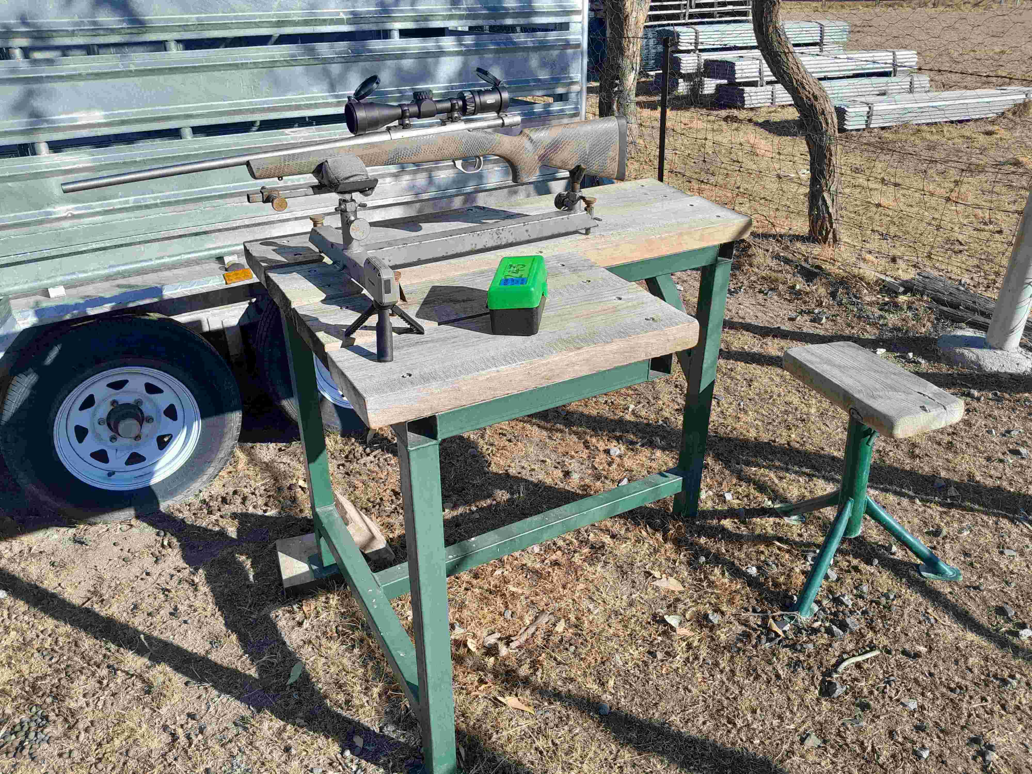

The set-up. Cheap Meopta scope, 2-10x, see you can shoot tiny groups with a scope that actually has field of view and is bright as any on the market.
I suggest checking out The Barn, they bought all the distributors stock of the European-made Meoptas because Chinese scopes out here are not thought of kindly. Prices are incredibly good for Zeiss performance.
Home-made bench rest, made 25 years ago before those cheap spongy Lead Sleds were even invented. Made them for all my mates.
Home-made benchrest, from a throw-away box section frame that was for transporting cattle panels.
Top of warping pine sleepers, doesn't matter cost the benchrest has 3 feet.

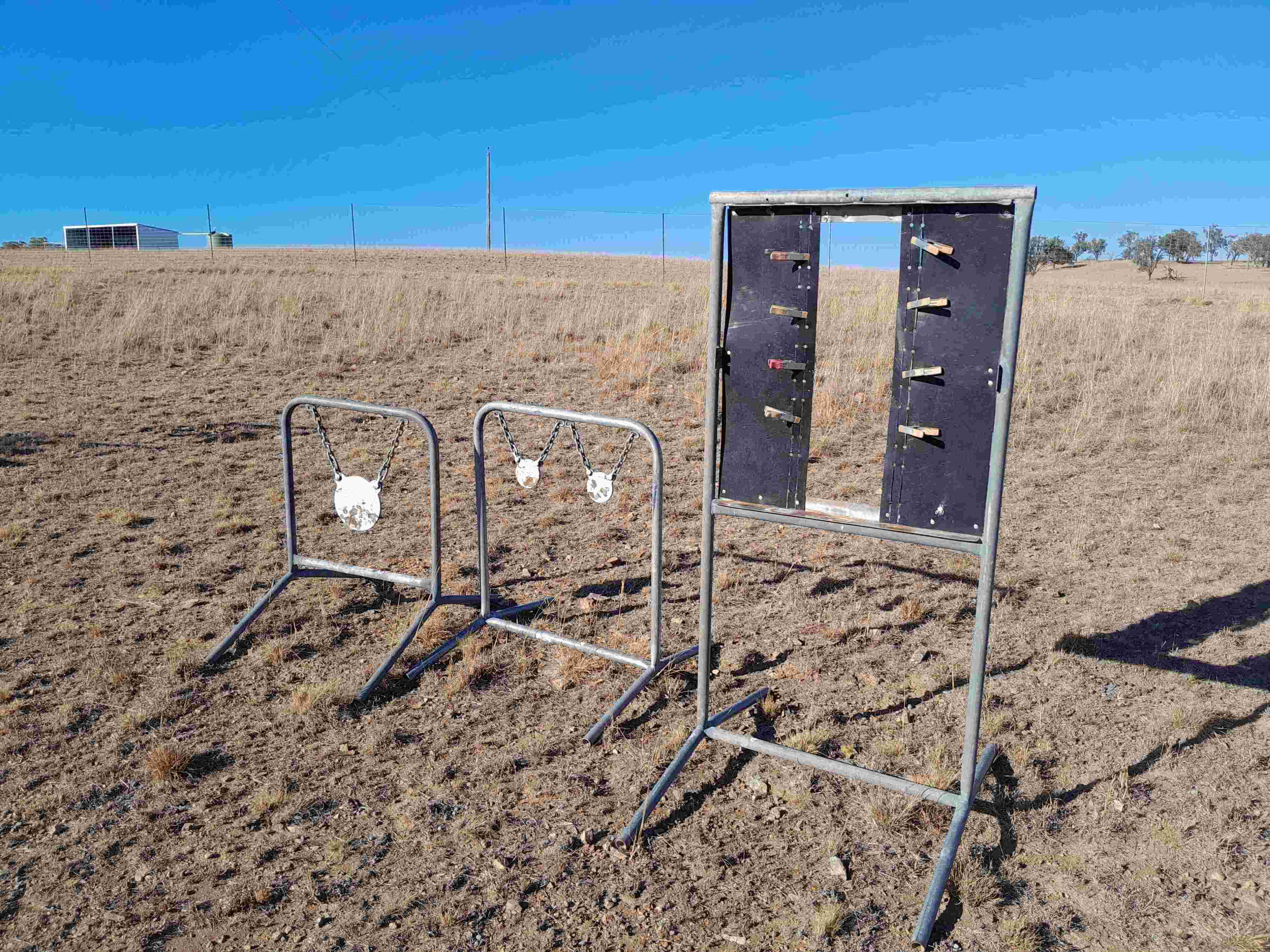

Everything homemade, target frames, targets from Weet-bix boxes inside-out, with cheap Ebay Shoot-N-See sticker spots to aim at.
All made from scrap, except the AR500 gongs, which I got off Ebay for half the gunshops price, posted to the big farm letterbox.
