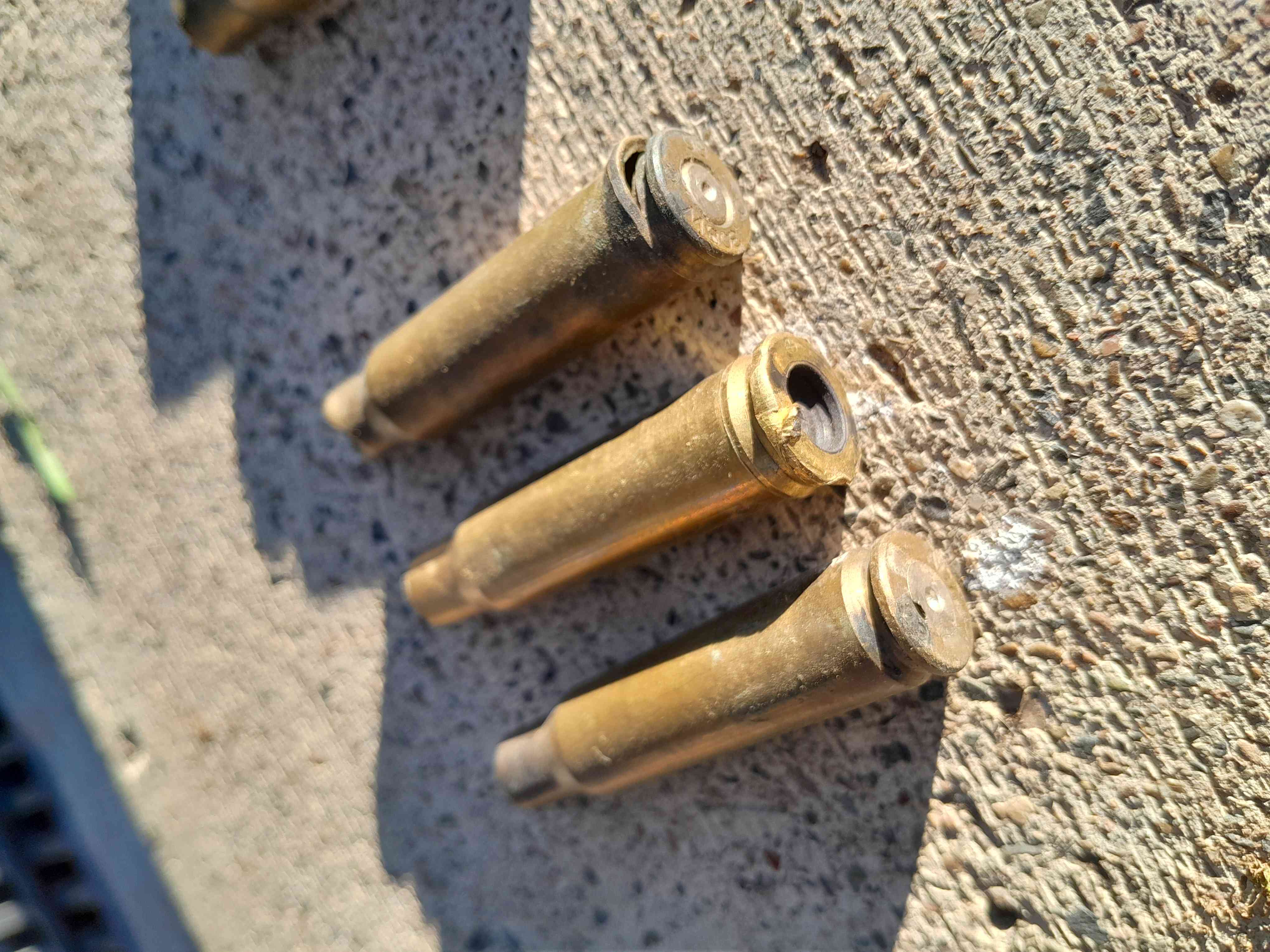

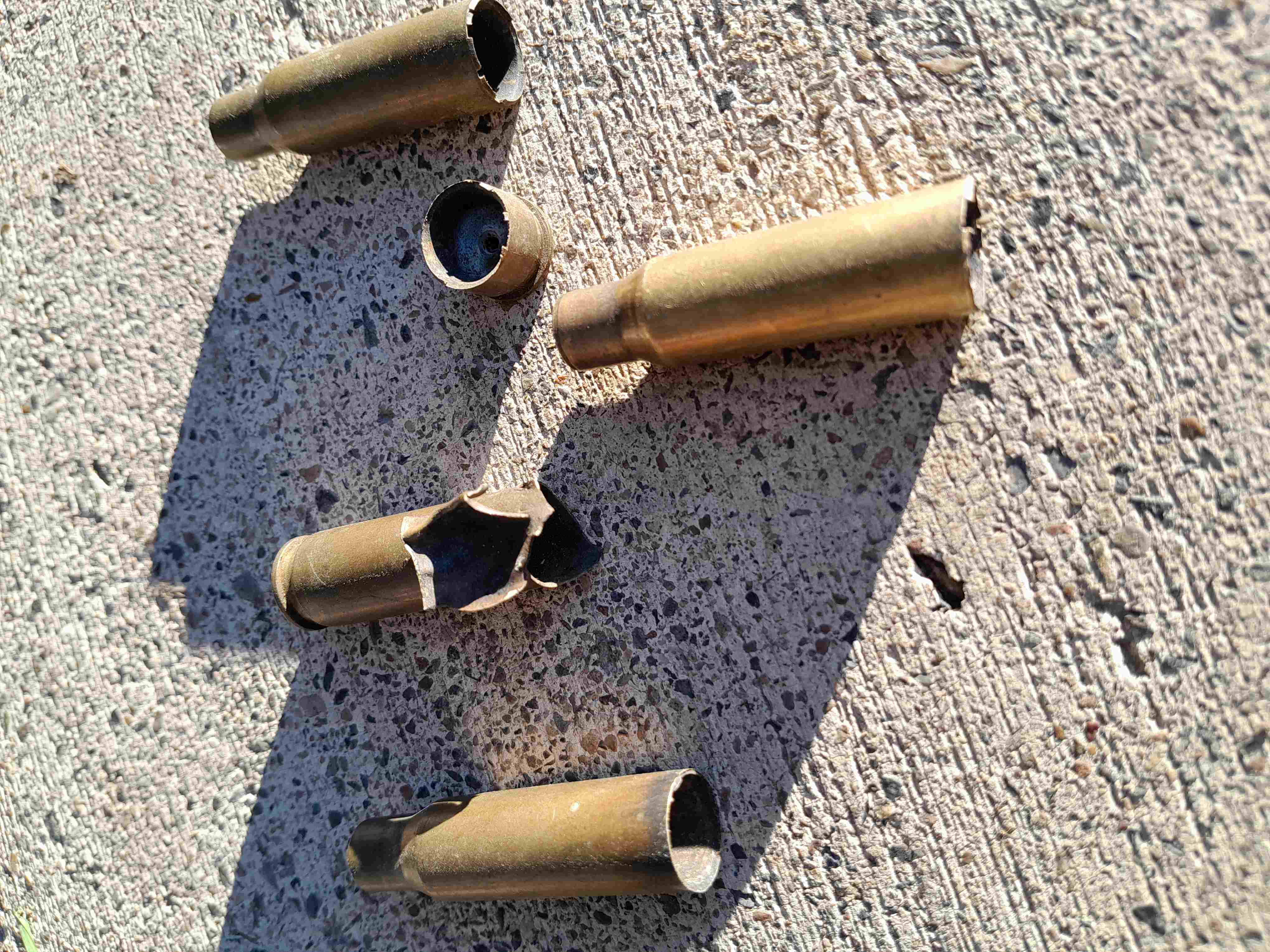

Post by Wapiti » 22 May 2026, 6:35 am
Some cases where the brass has failed.
One on the left has pierced the edge of the very flattened primer, from a very thick ex-mil case used with quite a hot load which in commercial shells is acceptable, but obviously right on the edge.
Middle one is from a factory cartridge of dubious make, this case a Winchester factory white-box 135gn Sierra HP made in Winchesters military ammo plant. Pulled rounds with powder weights measured show an over-hot load to start with, then too much variation (sh*t QC") in powder charge.
Right case is one of those WMA headstamped Winchester cases that didn't fail initially, on it's first reload. The base gave way just where the case head sticks out of the chamber and sits in the bolt nose counterbore.
But this is a tiny percent of the failures I always have, that I'm trying to find if someone knows a solution for.
Posts: 2370

Post by Wapiti » 22 May 2026, 6:40 am
This is the issue I am trying to find some advice on, if there is any.
Head separations.
Usually, I never find the base. It ends up far away as the cartridge extracts and ejects, and the body of the case always comes out.
Almost exclusively, this happens in autoloading field firearms.
I can never tell when this is going to happen. I NEVER use a case where you can see the bright ring around the base.
Any ideas to spot these failures before reloading the case?

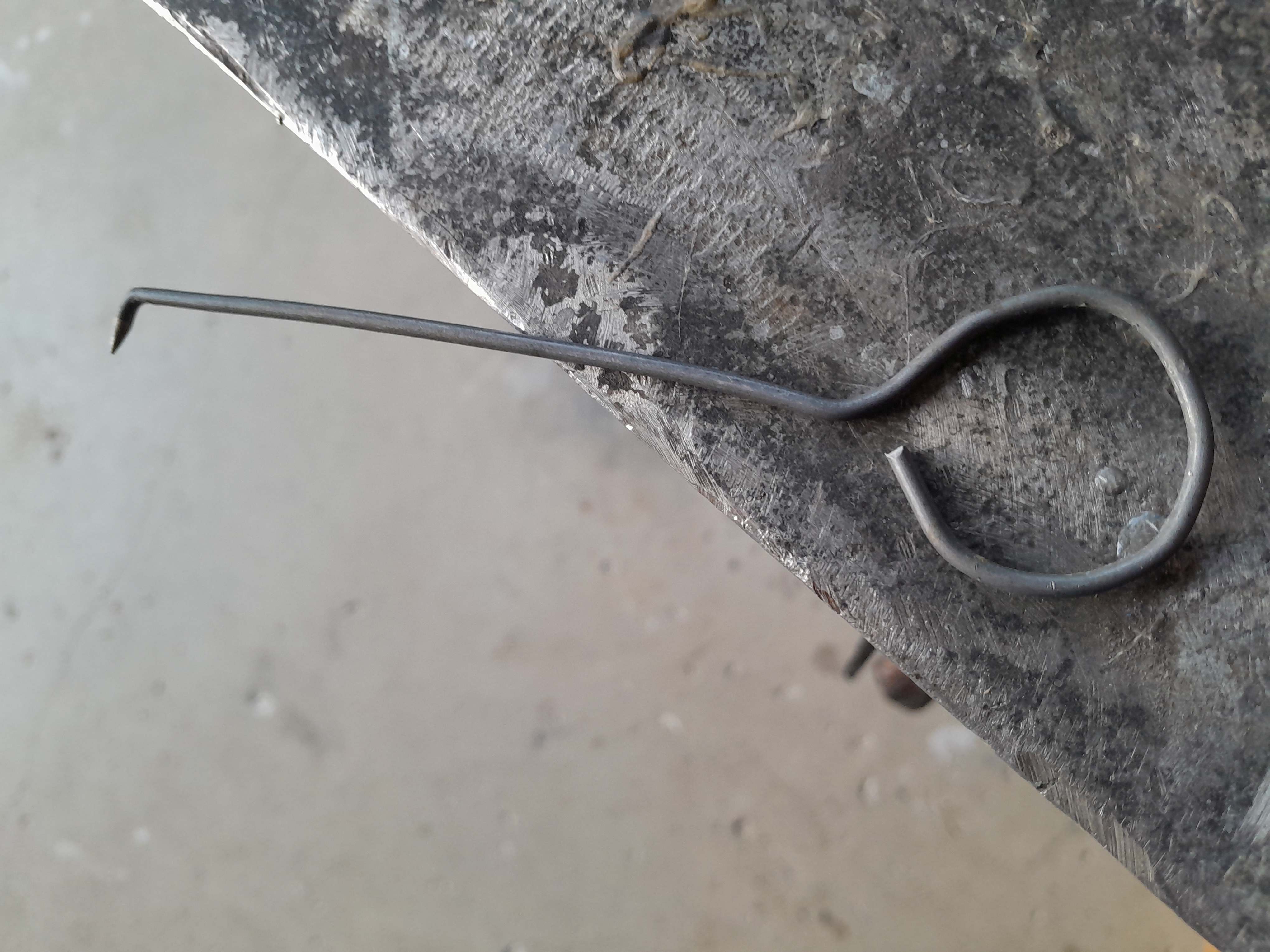

Post by Wapiti » 22 May 2026, 10:00 am
Hey Blade, Thanks for your as always, useful and knowledgeable info and the time you take to write all that.
I wish there was more like you prepared to detail info like that here.
I have tried the pick idea, I enclose a pic.
I made it from impossibly hard old extra 2.5mm HT fencing wire.
I've ground the tip with a chisel end so, hopefully, it drops into any internal ring from an about-to-separate case with that myth of the internal ring from brass moving forward.
I have felt some rings in some old brass prior, but this stuff that separates here has no ring inside that I can feel whatsoever, it's just hardened from FLS a few times I suppose.
Yes I am a XXXL size handed ex-boilermaker, but I could still feel this stretch-ring if it was there.

Post by morerams » 22 May 2026, 6:05 pm
Visual inspection of the outside of the case, there can be a groove on the inside long before case failure and I have found it hard to detect with a pointy tool even when I could see it.
morerams
Posts: 13
Re: How to avoid reloading issues of the dangerous kind?
Post by Wapiti » 22 May 2026, 6:20 pm
Yeah I can't feel a crack, a groove forming or anything with a few styles of pick I've made.
Sounds like a great trick when I read it when Uncle Nick talks about it, but never has it worked for me.
I've laughed when I've checked this in a batch of old cases collected from the passenger floor of the buggy and then fire them out in the paddock after recharging them again and see out the corner of my eye two pieces flying in different directions.
Oh well, no solution but I must just be hard on brass just as I am so good at finding the failure point of anything else out here pretty quickly.

Something I also noticed with your case separations is the cracks are closer to the base.
Mine were a bit higher by the looks. NFI why, but a pattern may mean something.

I throw out any brass that has any sign at all or doesn't look right.
2nd thing is the paperclip test. I find an unfolded paperclip has the perfect tension. Insert and drag one end of it along the wall of the case. If you feel a depression or especially hear/feel a click then you are probably getting ready to have a case separation.
