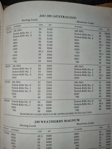

smlekid wrote:Hi guys I'm looking for any load Data for a No1 Mk111 Lithgow in 303/243 I can't seem to lay my hands on my older loading manuals I guess I have put them somewhere safe. We run a classic sporter event that is open to No1 rifles in any calibre based on a 303 case. It's a good fun shoot targets can be anywhere out to 300m
Nick Harvey's first edition has a page for it.
Interestingly, he doesn't say to reduce the data 10% for Lee Enfields (as he does the other .303 wildcats), but I still would.
303-243 data.jpg (129.06 KiB) Viewed 81 times
Personally, I would use AR2206H (H4895), start low and work up. I'd start around 28gn behind an 87gn bullet.

Post by No1Mk3 » 31 May 2026, 1:22 pm
243-303 Waterworth 2.JPG (500.95 KiB) Viewed 75 times
243-303 Waterworth 1.JPG (520.95 KiB) Viewed 75 times
Page from Waterworth
