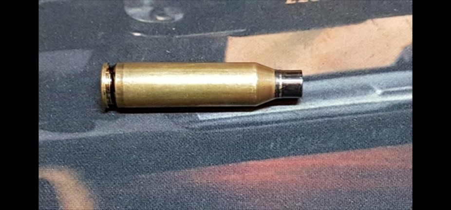

bigrich wrote:i've been using a hornady dry media tumbler for years . does a good job . emptying the media out of cases and wiping media dust with a cotton cloth is a bit boring , but they come out nice and shiny after about 2 hours . i think the media is crushed corn cob or something . i'm too ocd not to clean my cases deye243 :D
I used to be but suppose I'm getting old and lazy now I've posted this pick many times here it is again the case just had its 16th firing neck size only I don't even clean a primer pocket not been cleaned once granted it is good quality brass

Post by bigrich » 07 Jun 2026, 3:44 pm
hey mate , if it works for you, it works . what brand of brass are those cases out of curiosity ? cheers :thumbsup:

Post by deye243 » 07 Jun 2026, 5:58 pm
bigrich wrote:
Lapua ...... for my 223 long range rifle I use ADI I have found it to be just as good as lapua and it all gets the same treatment so far up to 11 loads with two batches of brass on the ADI 223 all just neck sized .
