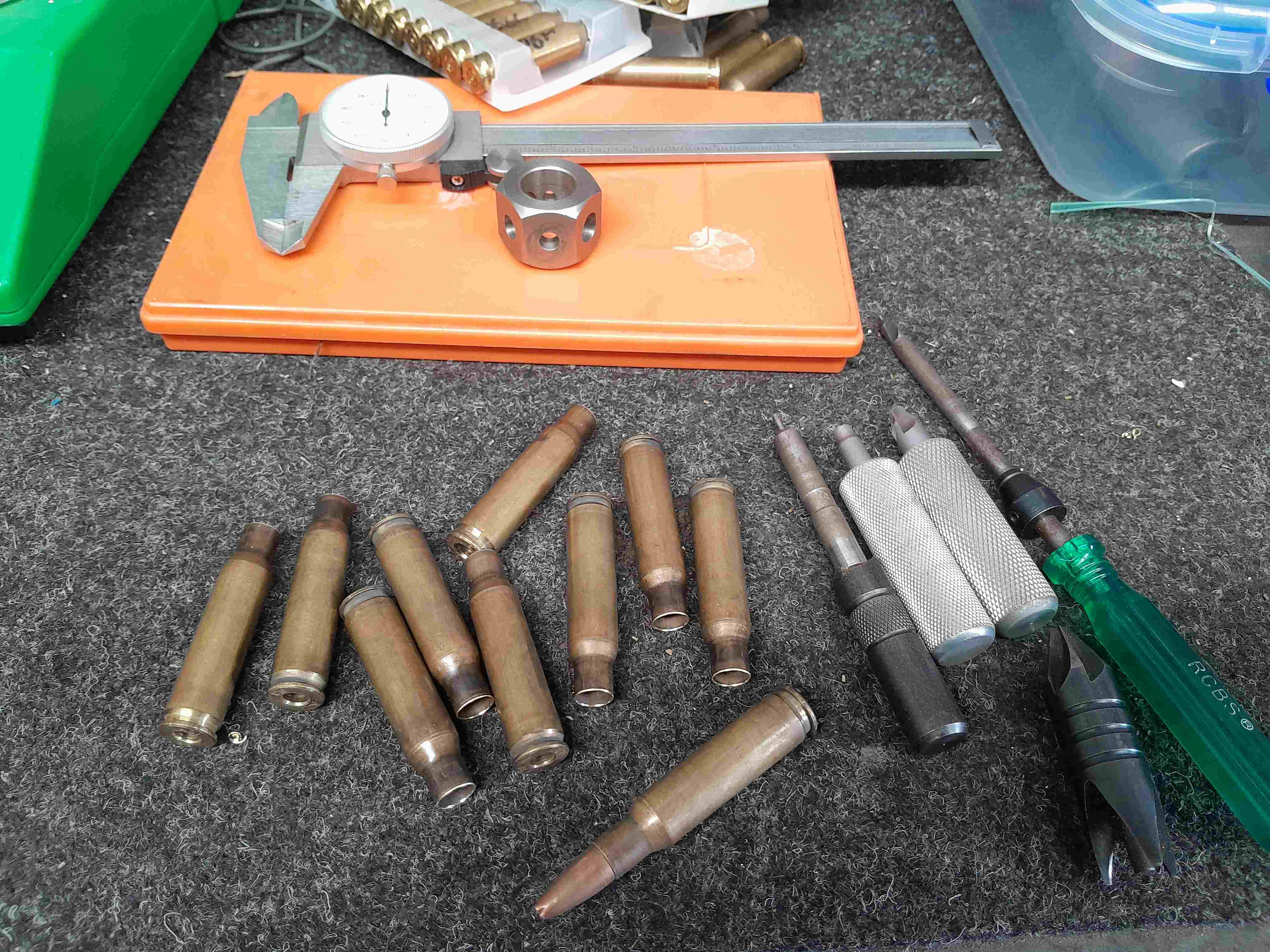

I don't specifically care if the primer pockets are spotless. I wet tumble before depriming. Wet tumbling with citric acid and pins gets the brass shinier than new brass for me. You could use a Lee Universal Decapping die to decap first if you were concerned about the pockets.
I have to do a bunch of brass when I get home tomorrow. I'll try to remember to get photos of them before and after cleaning, and the pockets after decapping and sizing.

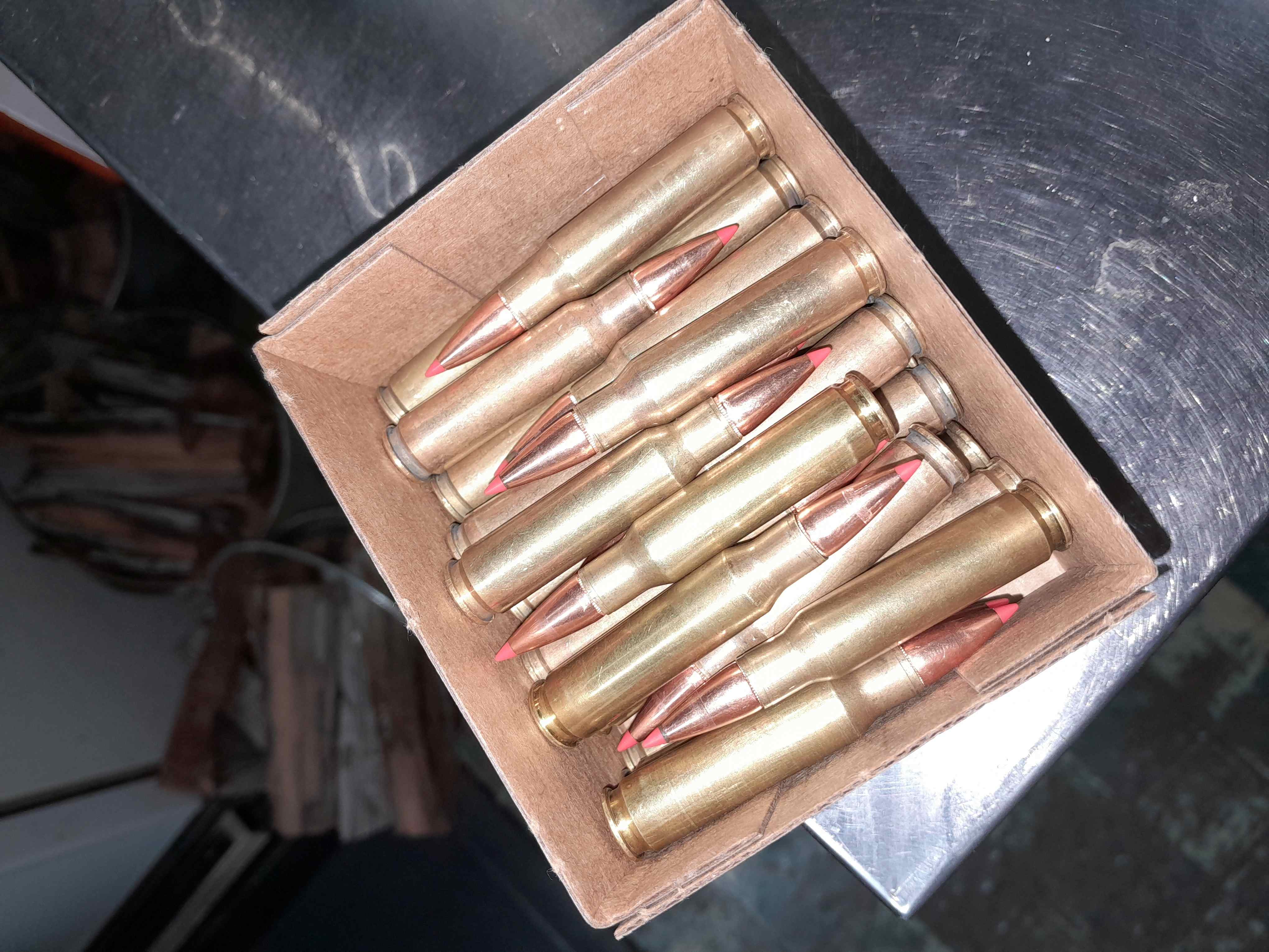

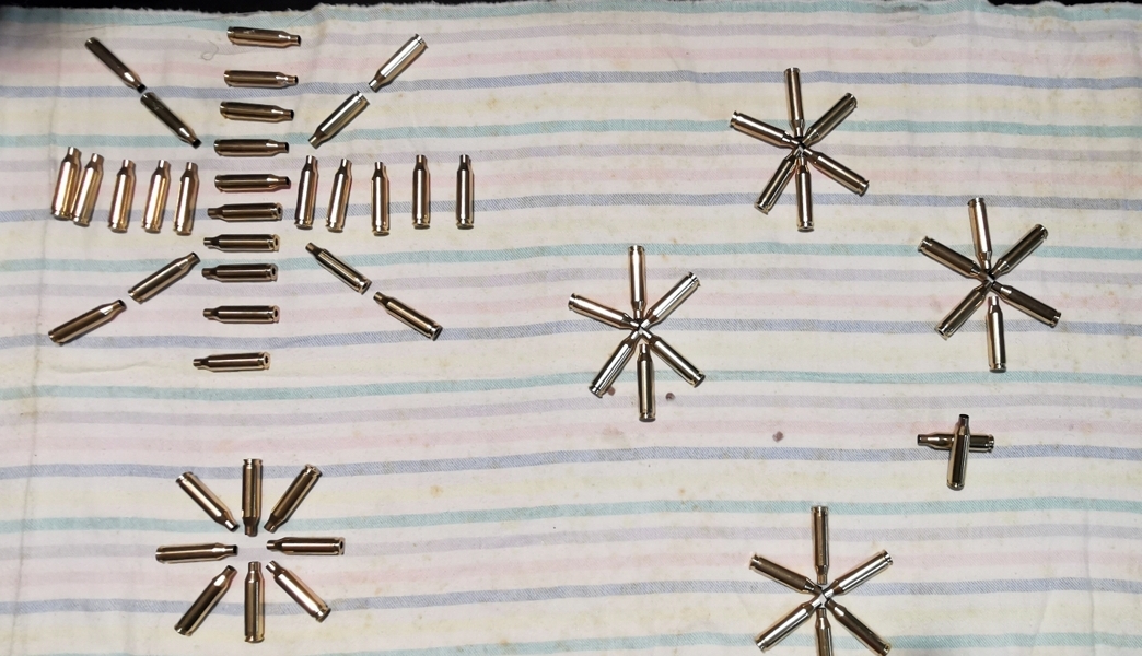

I used to be but suppose I'm getting old and lazy now I've posted this pick many times here it is again the case just had its 16th firing neck size only I don't even clean a primer pocket not been cleaned once granted it is good quality brass

hey mate , if it works for you, it works . what brand of brass are those cases out of curiosity ? cheers :thumbsup:

Lapua ...... for my 223 long range rifle I use ADI I have found it to be just as good as lapua and it all gets the same treatment so far up to 11 loads with two batches of brass on the ADI 223 all just neck sized .
Now having said I don't tumble it is a little bit of a white lie as I only buy Once fired ADI brass off a couple of people that I know that is sized with the smallest amount of resizing fluid I can use then it gets tumbled to remove the sizing fluid that gets loaded and shot the way I do it .

Same, that's all I'm using. I got home at 0150 and haven't unpacked the car yet, but I'll try to remember some photos when I get to it.

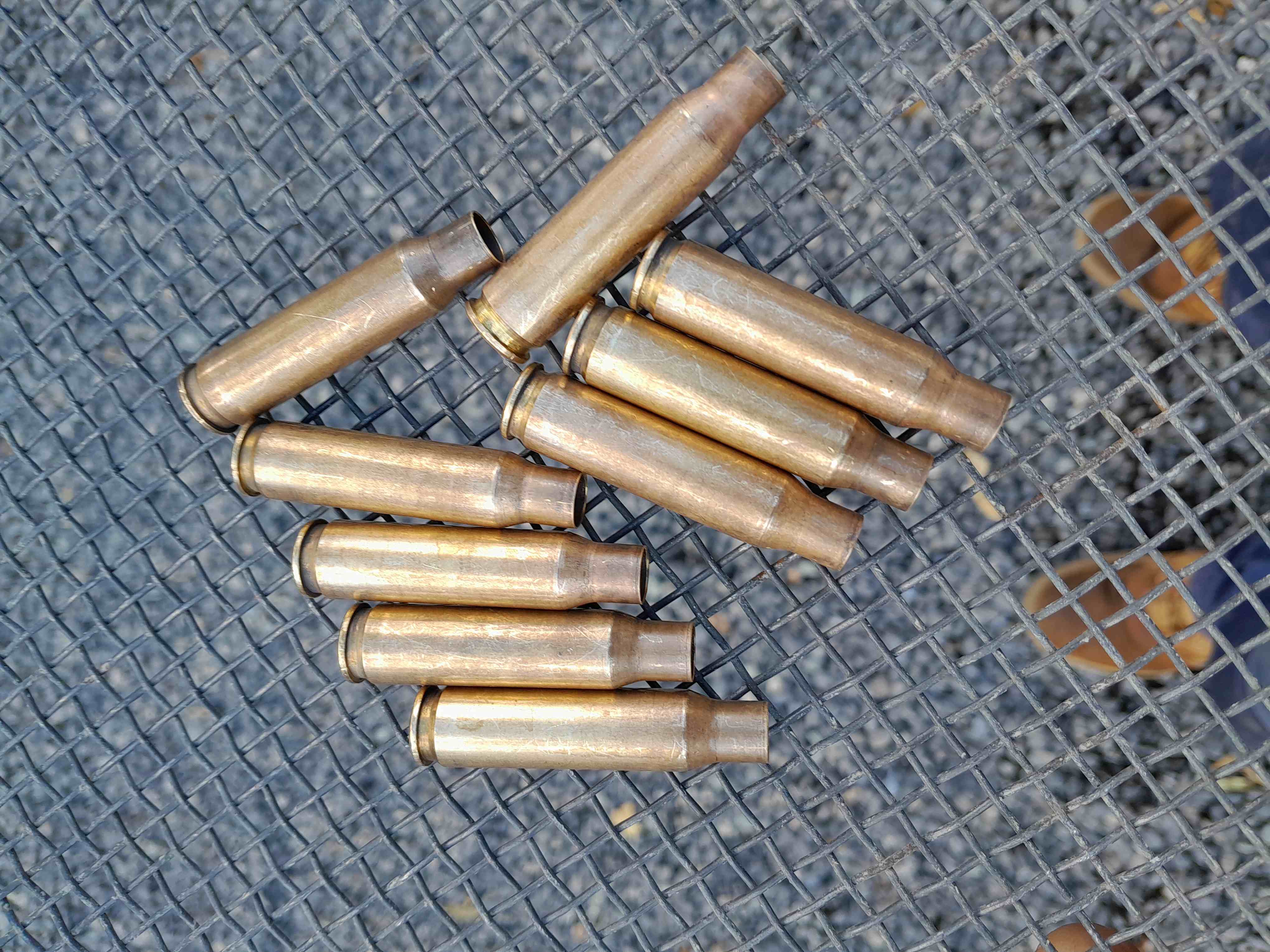

It started to rain this morning, so I'd thought I'd knock up a few cartridges for a yard shoot for the late arvo days end.
These cases were used in the field a few times, and are on their last legs. Dirtier than I like...
All the flaky sh*t on the inside is not good getting blasted up the bore by an already scouring 60,000PSI blast of gas. Wht's in the primer pockets is also in the inner case walls to a lesser degree.
That's why if I have a big batch, I'll pin-tumbler them all and clean all that crap out.
But with a small handful, that's silly.
I thought I'd size and deprime them, and chuck them in a small bucket with a teaspoon of citric acid, and another of Cream of Tarter. From the baking section at Woolies.

Post by Wapiti » 08 Jun 2026, 6:13 pm
Left them in for about 2 hours, whilst I went for a run with the tank trailer to fill the lick tubs with Tru-Graze.
They came out perfectly good enough, not "new" shiny, but bloody good.
No expensive tumbler, so stuffing around. Dried them with a few swipes of a heat gun. Ready to load in 5 minutes.
Edit: quite a bit of scaly crap came out of the interior of the cases, it was obvious in the bottom of the white yoghurt bucket. Getting rid of that is never a bad idea.
