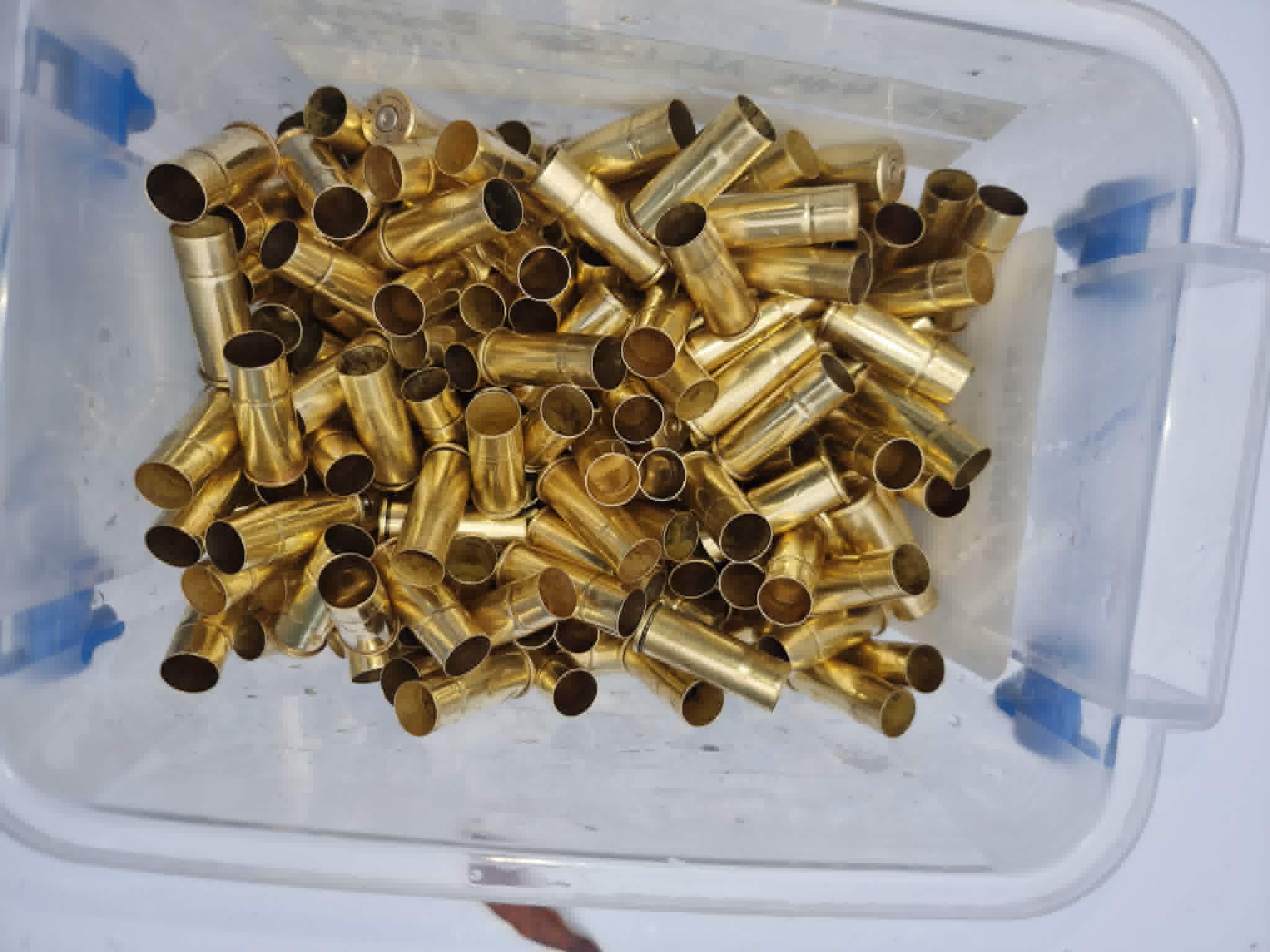

I used to be but suppose I'm getting old and lazy now I've posted this pick many times here it is again the case just had its 16th firing neck size only I don't even clean a primer pocket not been cleaned once granted it is good quality brass

hey mate , if it works for you, it works . what brand of brass are those cases out of curiosity ? cheers :thumbsup:

Lapua ...... for my 223 long range rifle I use ADI I have found it to be just as good as lapua and it all gets the same treatment so far up to 11 loads with two batches of brass on the ADI 223 all just neck sized .
Now having said I don't tumble it is a little bit of a white lie as I only buy Once fired ADI brass off a couple of people that I know that is sized with the smallest amount of resizing fluid I can use then it gets tumbled to remove the sizing fluid that gets loaded and shot the way I do it .

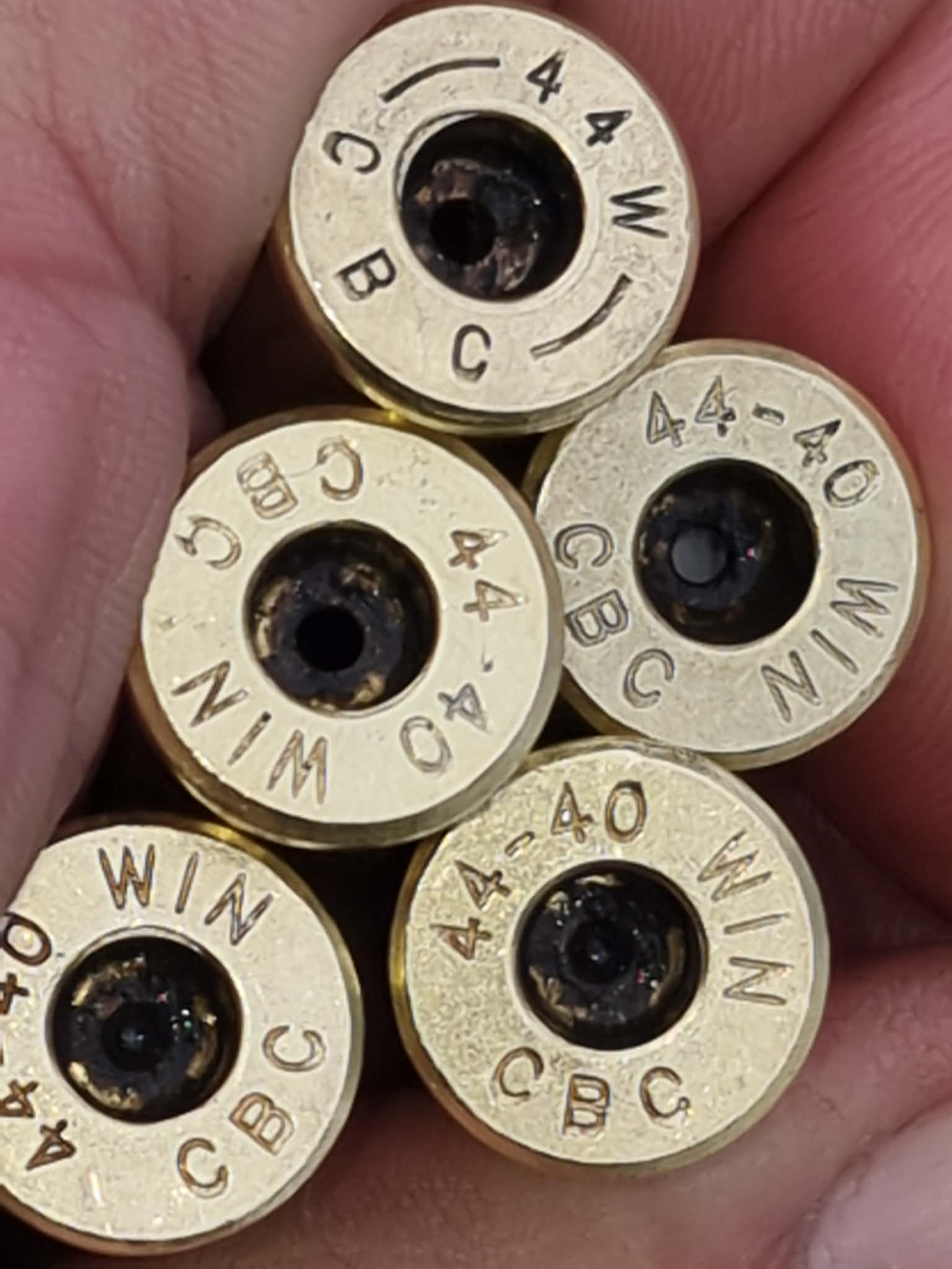

I started with the small Chinese perspex tumbler and went for many years before recently buying the bigger 5KG version.
They copied one of the shooting brands, so the bigger old type got a good price drop to under $100 from memory.
The only problem was the primer pockets never really cleaned well without running it for hours.
I now go about 20 min in an ultrasonic machine with citric acid, then the 60m tumble.
Next level shine, 96% have pockets like new and inside the cases as well.
Any spots of carbon left just fall out when I touch them with a scriber.
The machine saved me buying any dry tumbler machines, so saved money really.

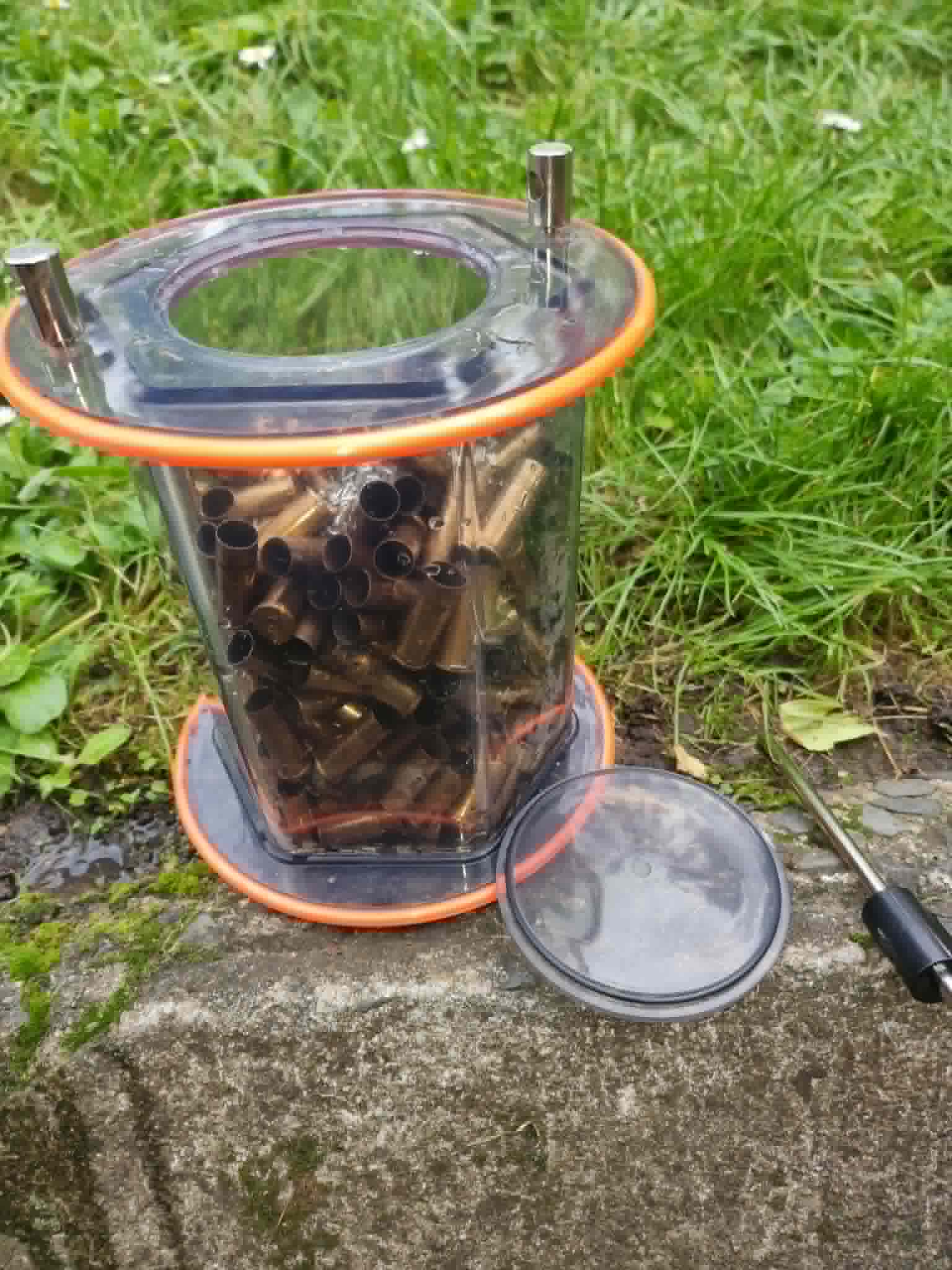

It started to rain this morning, so I'd thought I'd knock up a few cartridges for a yard shoot for the late arvo days end.
These cases were used in the field a few times, and are on their last legs. Dirtier than I like...
All the flaky sh*t on the inside is not good getting blasted up the bore by an already scouring 60,000PSI blast of gas. Wht's in the primer pockets is also in the inner case walls to a lesser degree.
That's why if I have a big batch, I'll pin-tumbler them all and clean all that crap out.
But with a small handful, that's silly.

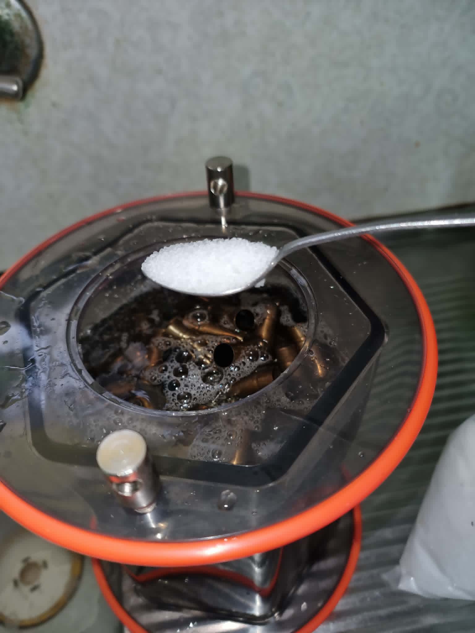

I thought I'd size and deprime them, and chuck them in a small bucket with a teaspoon of citric acid, and another of Cream of Tarter. From the baking section at Woolies.

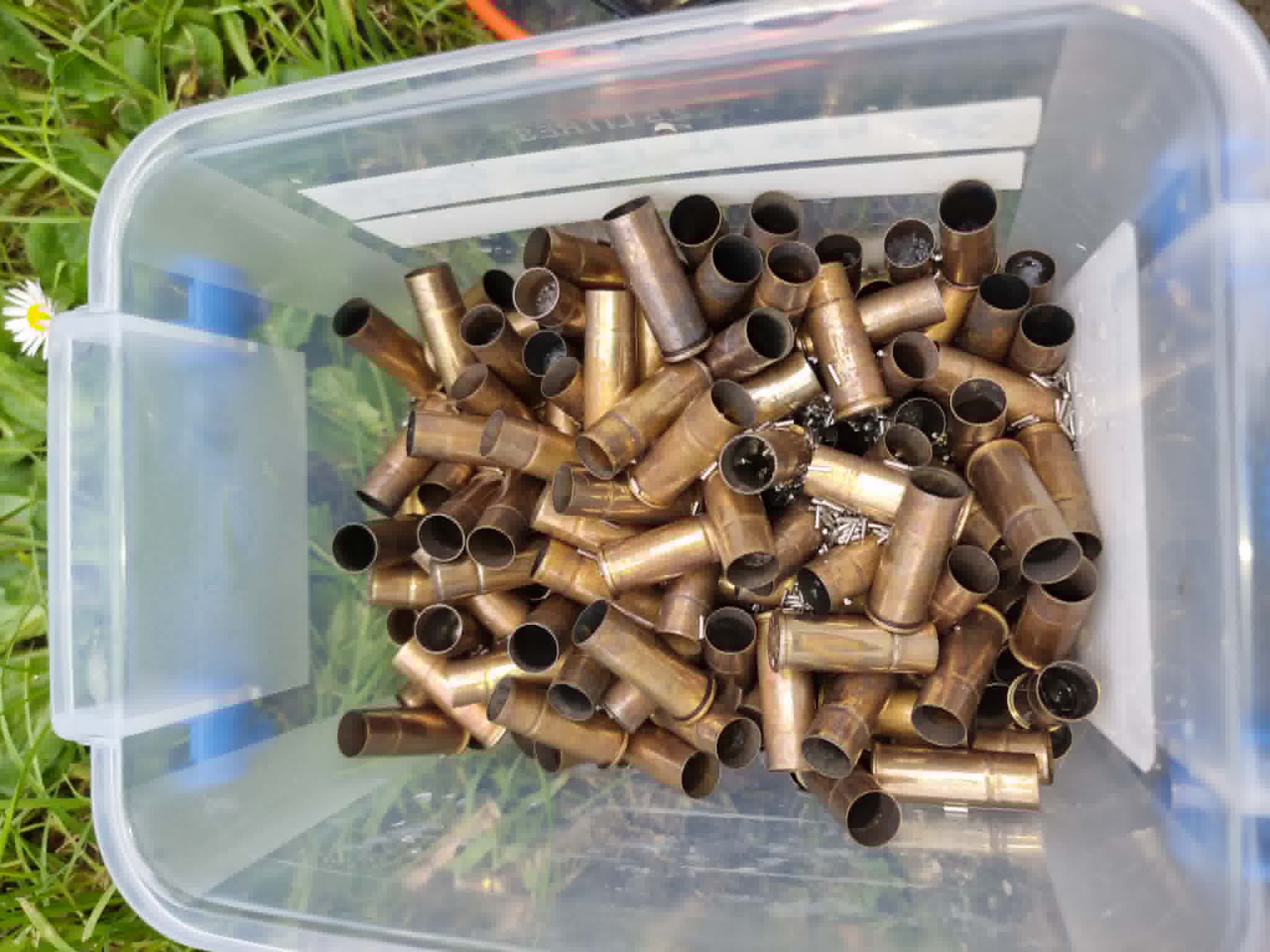

Left them in for about 2 hours, whilst I went for a run with the tank trailer to fill the lick tubs with Tru-Graze.
They came out perfectly good enough, not "new" shiny, but bloody good.
No expensive tumbler, so stuffing around. Dried them with a few swipes of a heat gun. Ready to load in 5 minutes.
Edit: quite a bit of scaly crap came out of the interior of the cases, it was obvious in the bottom of the white yoghurt bucket. Getting rid of that is never a bad idea.

Came out quite presentable and clean for cases that sat in a bucket with two teaspoons of powder from a supermarket? For a few cents.
If a tumbler is a bit much of an expense with then cost of everything else right now, don't feel left out at all.

I did a tumble of 240 .44-40 cases today, one hour and they came up very nice. Half were blackpowder handloads, half were new factory once-fired. I did have the blackpowder brass soaking in a bottle of soapy water from when they were fired so the carbon stayed soft.
Before cleaning but have soaked in soapy water for two to five days
Fill with water to cover the brass - 240 .44's in there
A teaspoon of citric acid
After 60 minutes of tumbling
I lay them out in the breeze to dry, not really any sun today. I also deprimed and sized a few as soon as they came out of the tumbler so I could see what the pockets look like. There is a little soot in the pockets still, but nothing I'm concerned about.
Primer pockets, still wet
I rinse the pins clean after every tumble. Just pick out the brass one at a time, shake out any pins, drop the cases into a tub. Generally I might drop half a dozen pins out of the tumbler into the sink while doing this, but they just go back into the tumbler. When all the brass is out I top the drum up again, reach in and swish the pins around, tip off the water, do it again. Usually a third rinse is all it needs, even with blackpowder brass, for the water to come off clean enough to look drinkable. Then I top up the tub of wet brass, swish them around to tip out any trapped soapy acid water, tip off the water, and do it twice more. Then dump it all onto a towel or a tray and put it out in the sun for a few hours. If it's raining I put it above the wood stove to dry.
