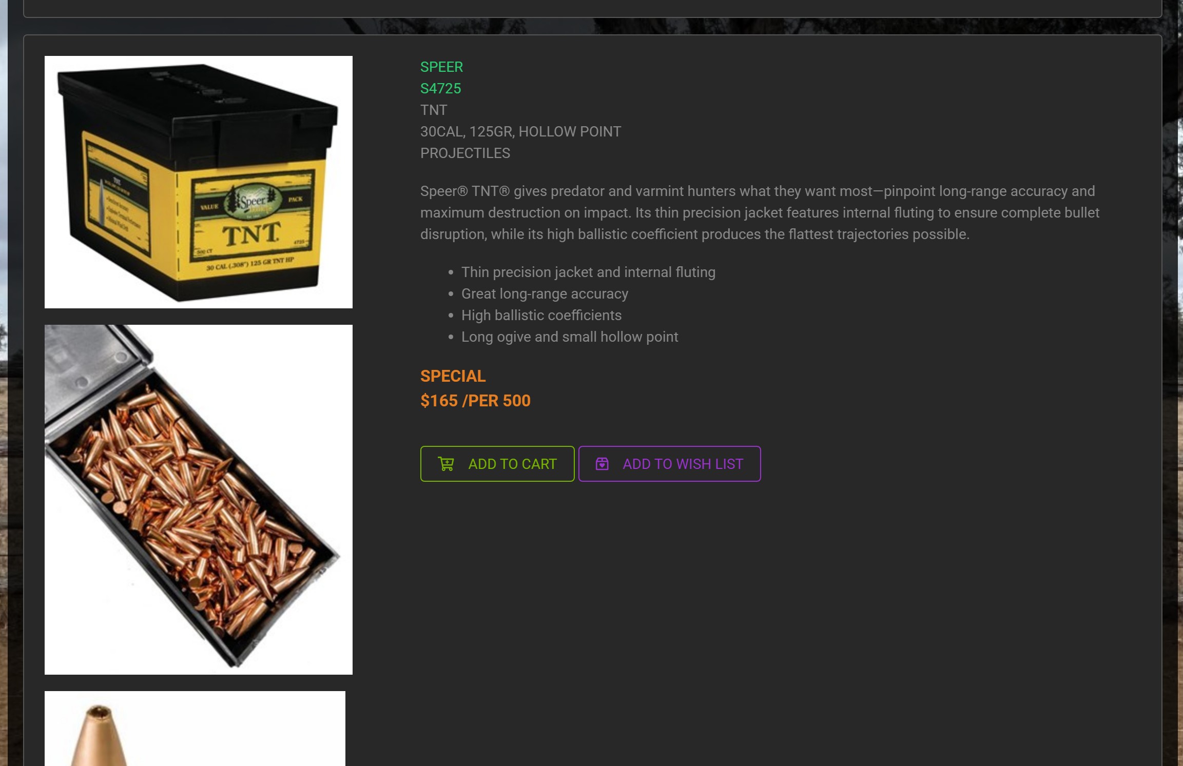

Anyway, I saw these online a few weeks ago, and sourced some.
Speer ad.jpg (282.13 KiB) Viewed 54 times
I thought, at that price, with the amount of shooting we have to get done, I thought I'd try some.

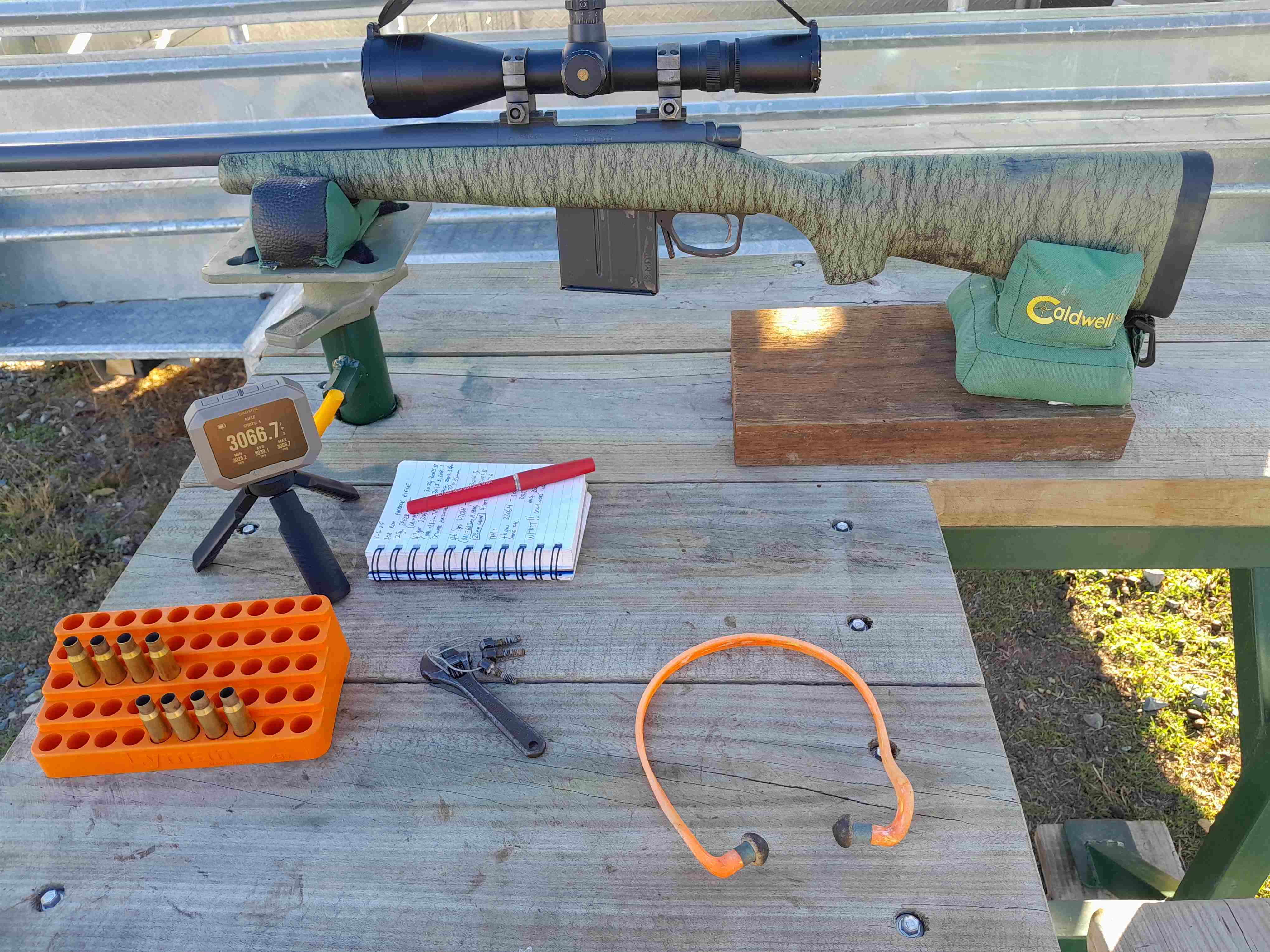

Used the old done-everything gun, over 6000 shots now conservatively. Home done chamber tighten, squared up action face with my home-turned mandrel, refaced crown and barrel face, ground recoil lug. In a HS alloy-bed stock, which has been lapped in the bedding "V" with a mandrel made exactly the same diameter as the action.
No skim bedding.
My standard range distance in the house yard, 110m.
Looked at the manual, tried 47gns 2206H. Not bad. Average well over 3100fps in a 20" barrel, bloody hell.
Went down, tried 46.5gns. Wow. Good deal, these bullets. Still average around 3080fps.

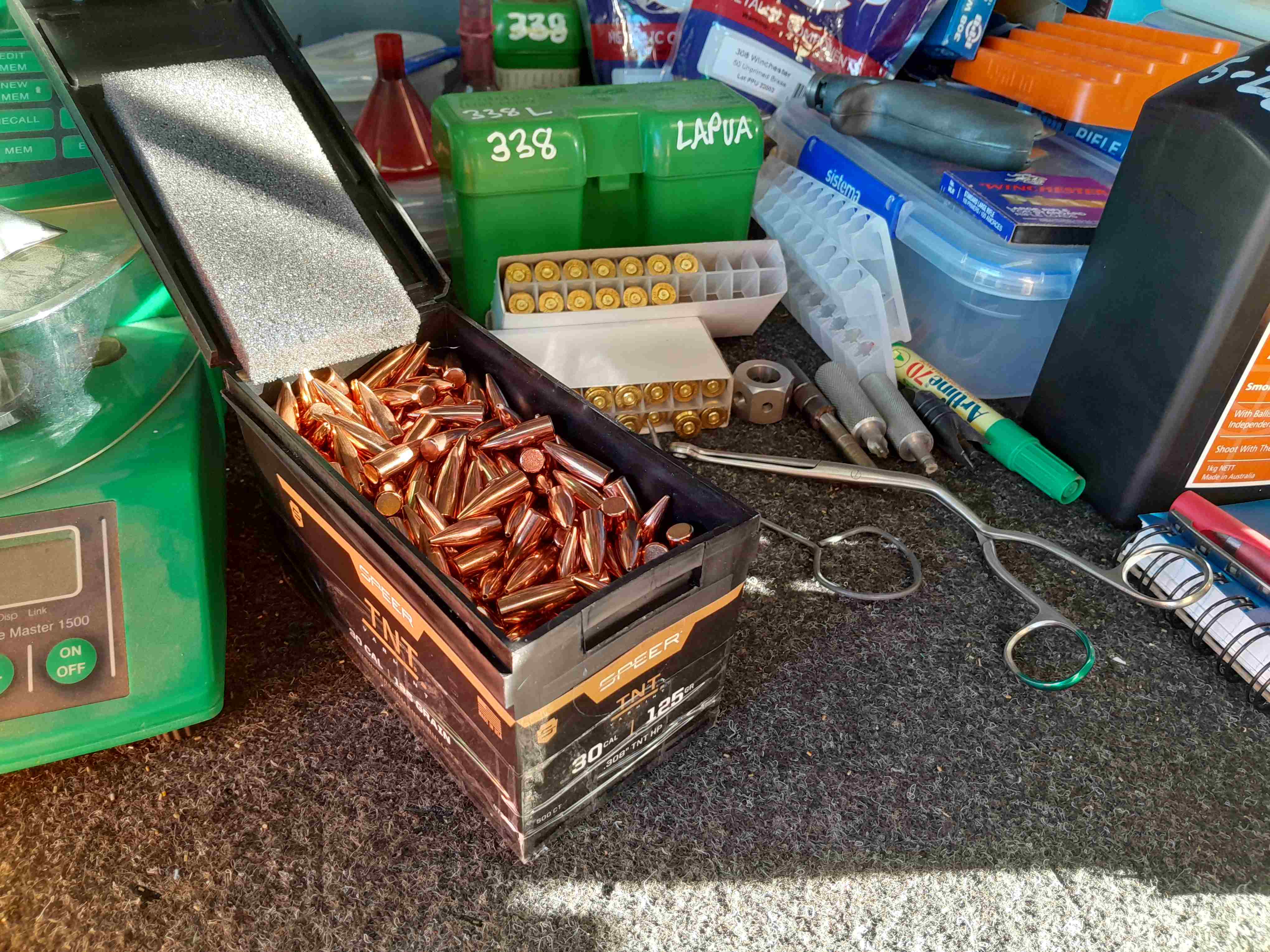

Bullets come in a 500rd. "ammo crate" :lol: Somehow, the postie managed to bust the box, hence the tape.

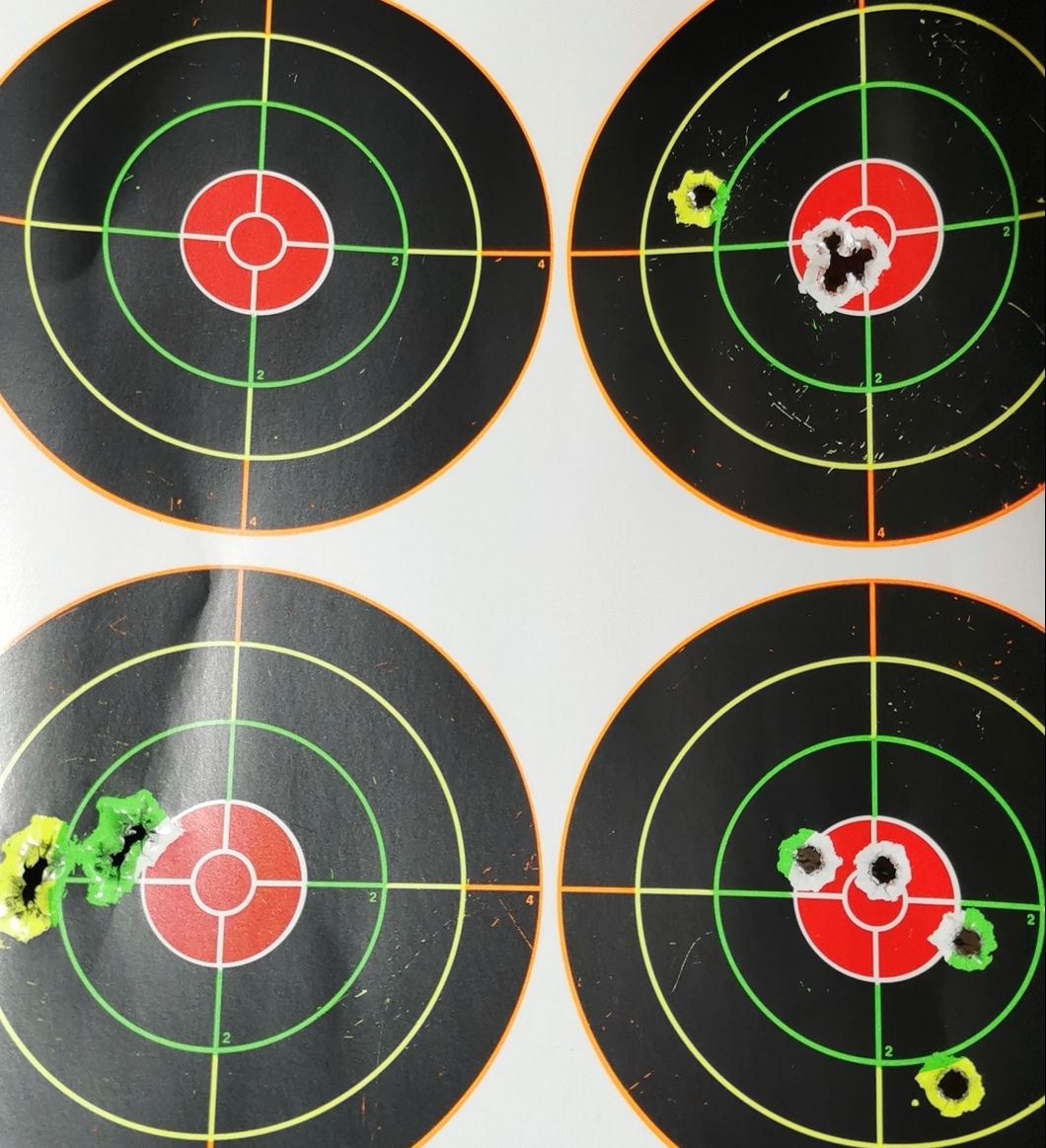

Then, tried 46gns. Holy crap. This is 5 shots at 110m, average speed was 3050fps.
Scope is a very battered 4.5-14x50 MK4 scope, unbreakable thing it's proved to be for 10 years.
As can be seen, these projectiles are capable of incredible accuracy, and the price, wow.
Those of you who reload, and do the type of shooting that can use the accuracy of these bullets, have a look, don't write them off because they don't have an expensive plastic tip and big glossy ad.
Head shooting is a small target that can move in an instant, doesn't hang around, and doesn't allow for stuffing around. The last thing you need is big groups with all that other stuff to worry about. Including the personal ability to be consistent.

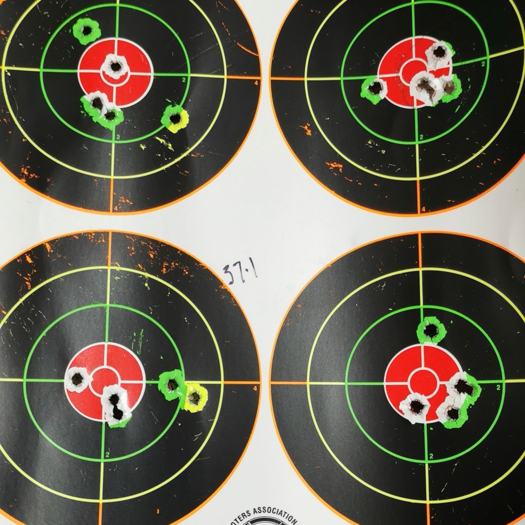

It was you that mentioned them a while back in another thread, so I went and got a couple of boxes of 75gr hollow points for my 243.
I loaded them up to what my 85gr sierras are using and they grouped nicely. Averaged 3050fps and about 1moa.
I also loaded a few a touch hotter and got an extra 100fps out of them on average but the groups had opened up again so I'll just stick with the other load.
Still can get under 1moa @ 100. That's good enough for hunting.

Post by Damo300 » 12 Jun 2026, 8:58 pm
The top right is a 6 shot group from the sierras for comparison.
Yes I pulled the left shot there, but I did follow it up with another through the clover, hence the 6 shots.
The ones under were another cooked load with the speer.
And bottom left is my 30/30 at 100.
It grouped 2 inches if you're lucky.
