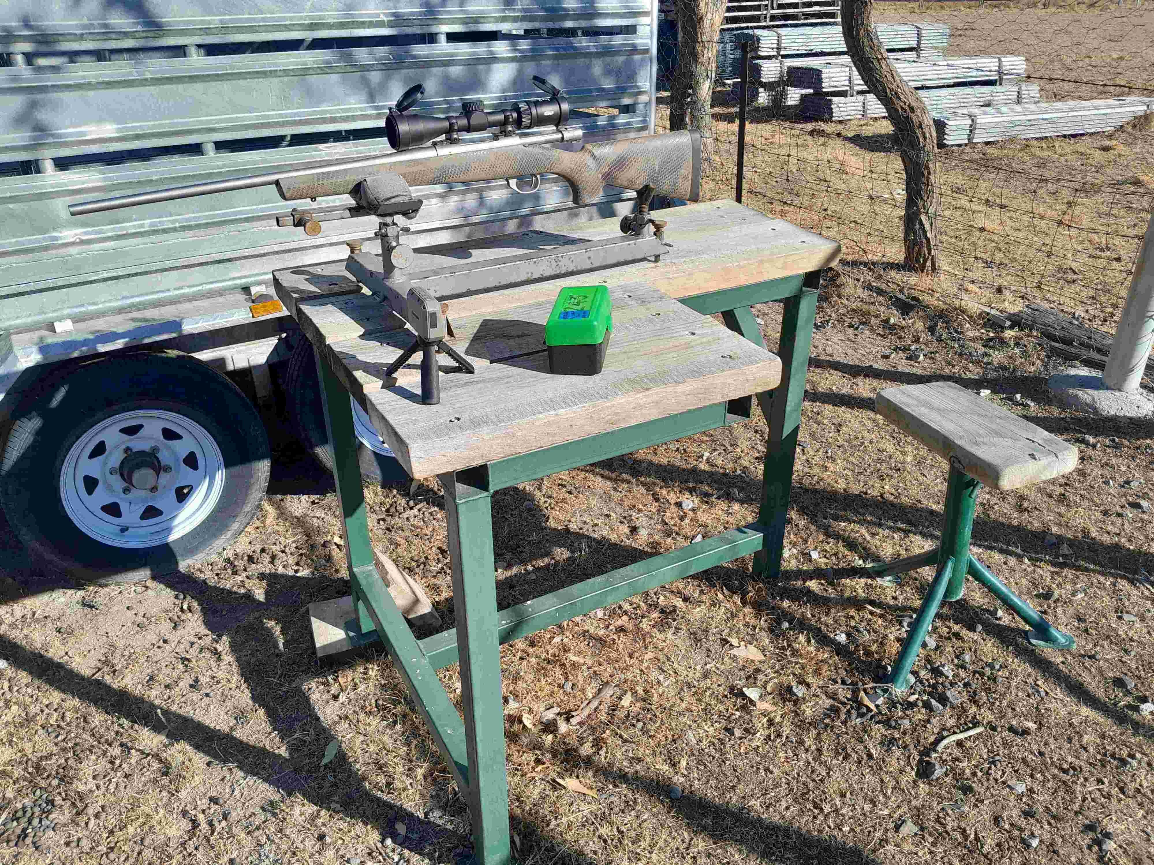

Home-made bench rest, made 25 years ago before those cheap spongy Lead Sleds were even invented. Made them for all my mates.
Home-made benchrest, from a throw-away box section frame that was for transporting cattle panels.
Top of warping pine sleepers, doesn't matter cost the benchrest has 3 feet.

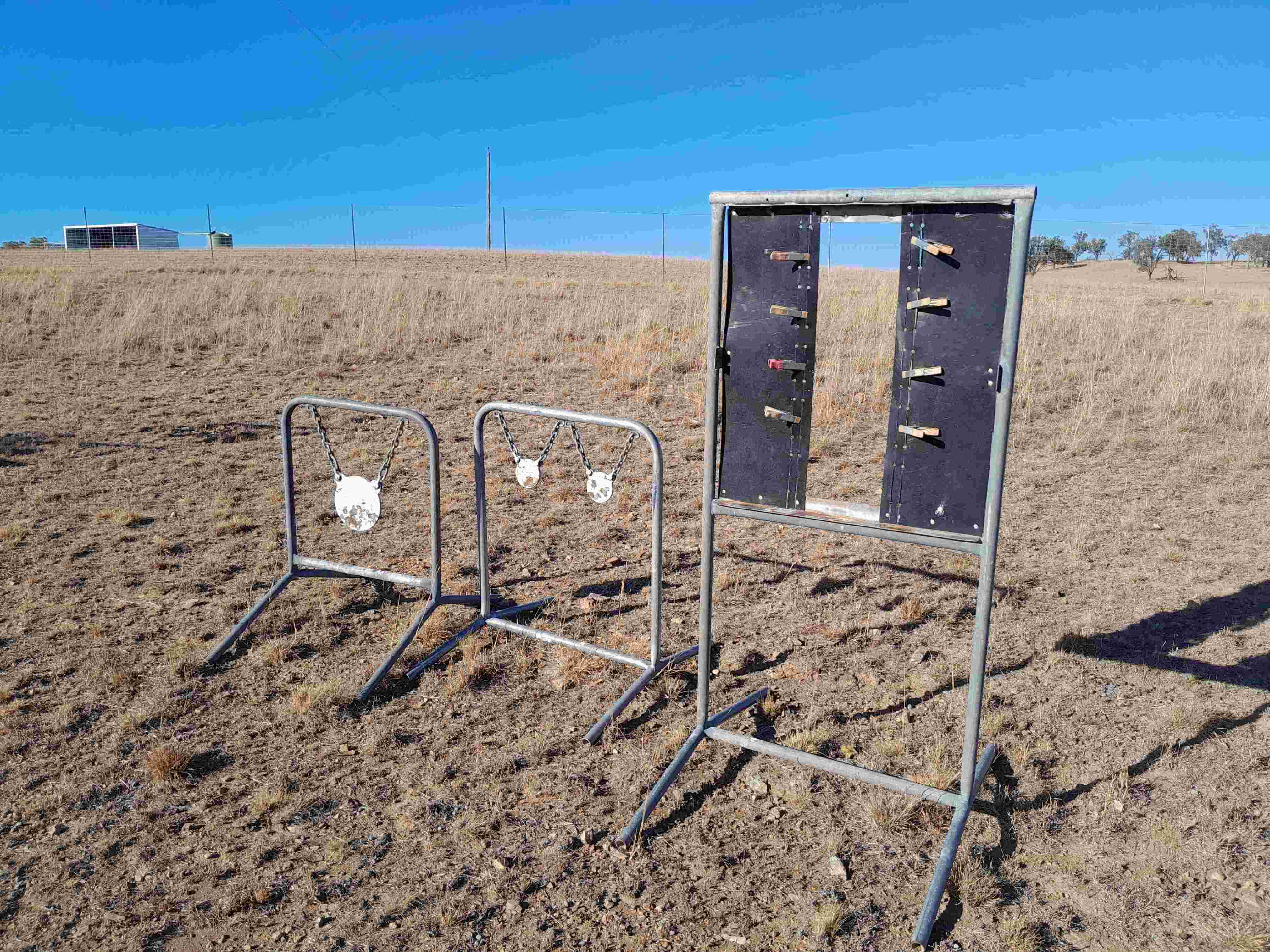

Everything homemade, target frames, targets from Weet-bix boxes inside-out, with cheap Ebay Shoot-N-See sticker spots to aim at.
All made from scrap, except the AR500 gongs, which I got off Ebay for half the gunshops price, posted to the big farm letterbox.
