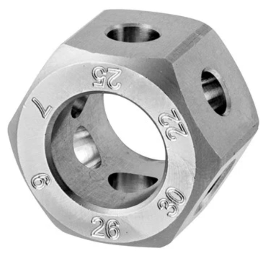

Damo300 post has reminded me that not all mesure properly .
Are you mesuring overall length or doing it properly with a comparator .
I use this works a treat

I get this when measuring rifling to bolt face dimensions to get a consistent number too, using a dedicated comparator tool, as well as the simple tool above that Dye posted up a pic of. I even get it with a OAL gauge set.
Some soft projectiles are just bastards (yes, big name copper jacketed ones), it's so easy to get the long tapered tips to stop in the measuring gauge consistently each time. Especially with the super-accurate dial calipers available now. They pick up this inconsistency every time.
