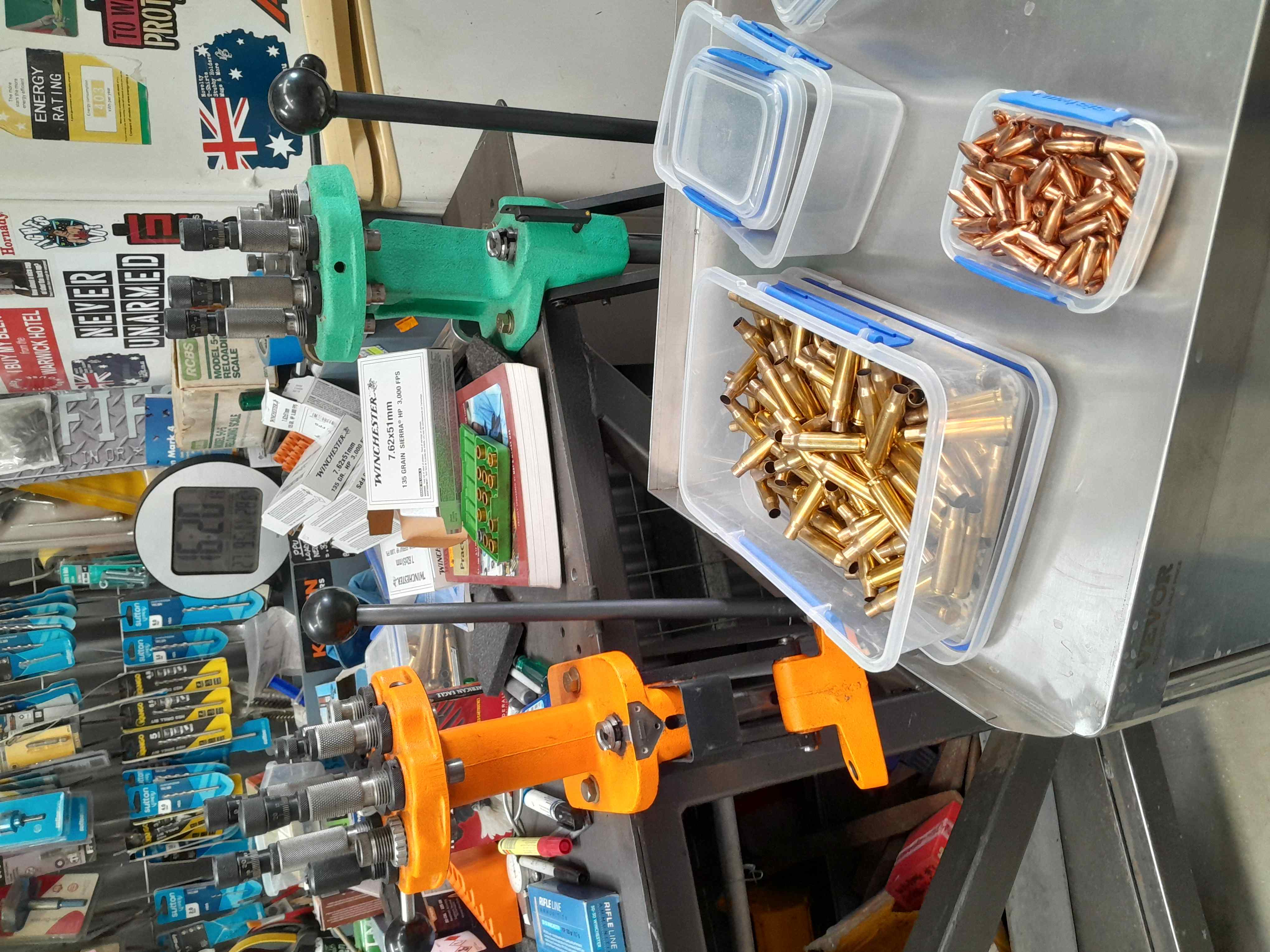

Anyway, I finally got around to start doing some more - pulling them, resizing the necks down again after pulling and was about to start up the RCBS thrower.
BUT I noticed this black, tarry sealant on the bullets I was pulling.
When tipping out the powder, I noticed a ring of ball powder stuck down inside the neck where there was a ring of sealant pushed down when seating the projectile at the factory. And the projectiles have this black sh*t on them still.

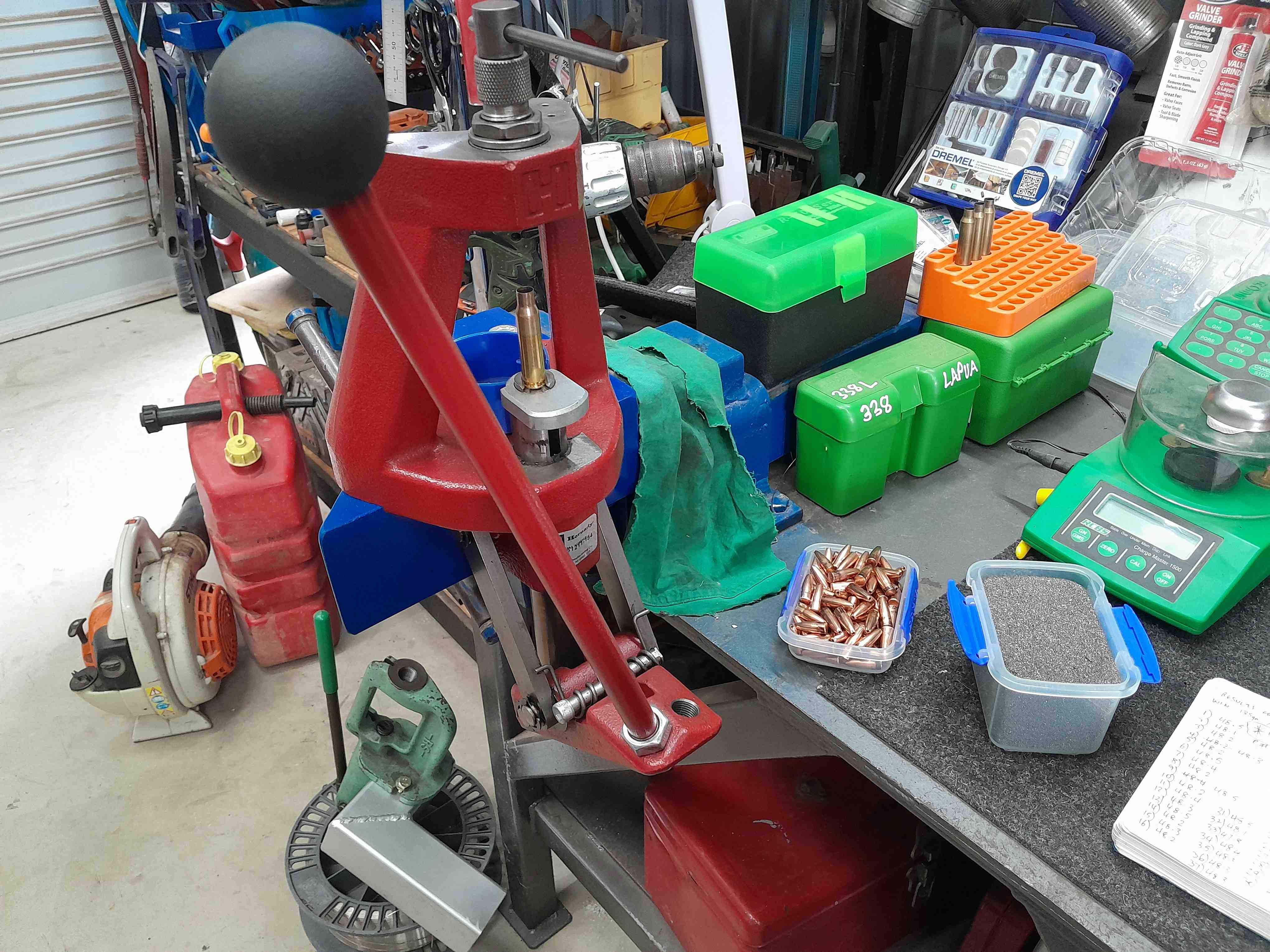

How I pulled the bullets, using a collet puller in an old press clamped in the vice on an angle frame, for odd jobs.
I don't know if you can see in this pic, the black tar on the projectiles that have been pulled.
