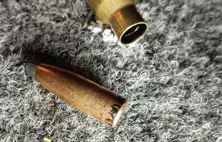

BUT I noticed this black, tarry sealant on the bullets I was pulling.

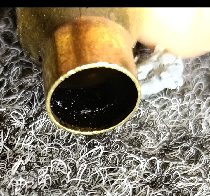

When tipping out the powder, I noticed a ring of ball powder stuck down inside the neck where there was a ring of sealant pushed down when seating the projectile at the factory. And the projectiles have this black sh*t on them still.
How I pulled the bullets, using a collet puller in an old press clamped in the vice on an angle frame, for odd jobs.
I don't know if you can see in this pic, the black tar on the projectiles that have been pulled.

Apologies, I should've taken a pic especially of the projectiles, I thought I did. But I've locked the shed up for the day, too lazy to hobble back down there.

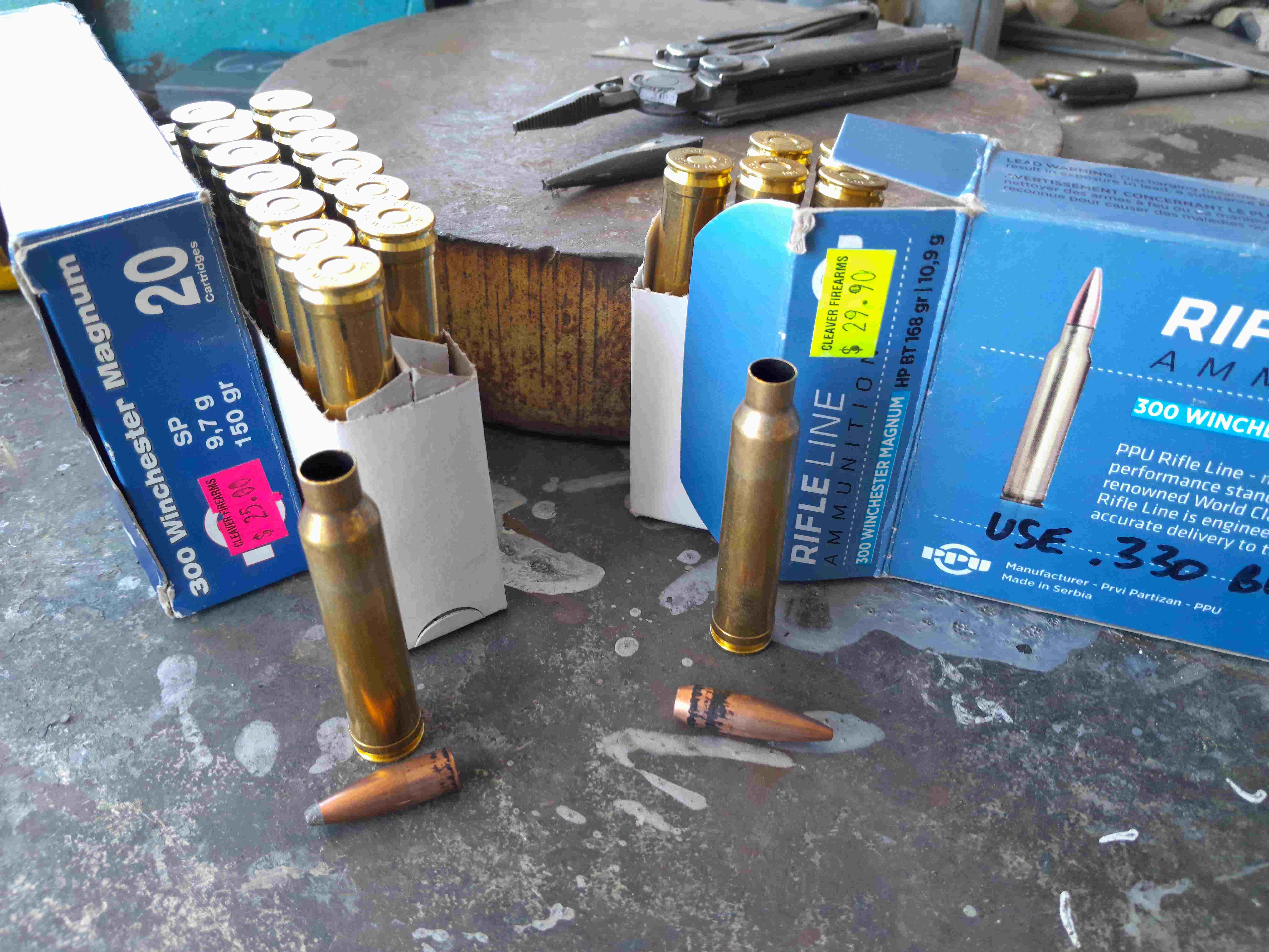

I just pulled a PPU 150gr / 9,7g 300wm and it's definitely on them.

Yuk!

Post by Wapiti » 30 Sep 2026, 7:10 am
A picture tells a thousand words Damo, thanks for posting that.

Hey Damo, there's sealant/tar on both types of 300WM projectile made by PPU I have too.

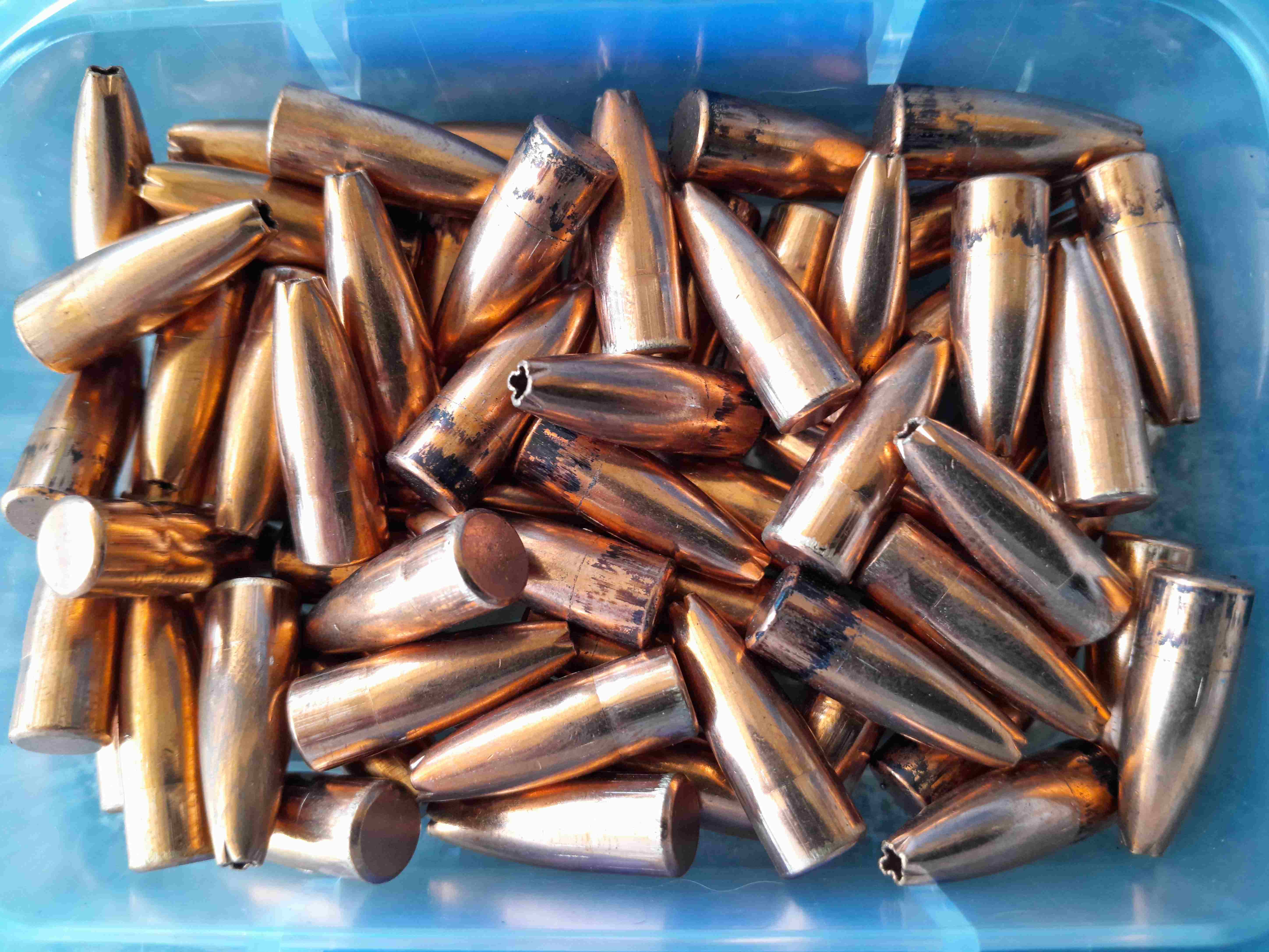

To all who've wondered, or those who are just bored, here's a pic of some of the pulled 135gn Sierra bullets from the WMA-21 headstamped 7.62x51 military-plant loaded ammo from the plain white boxed stuff.
