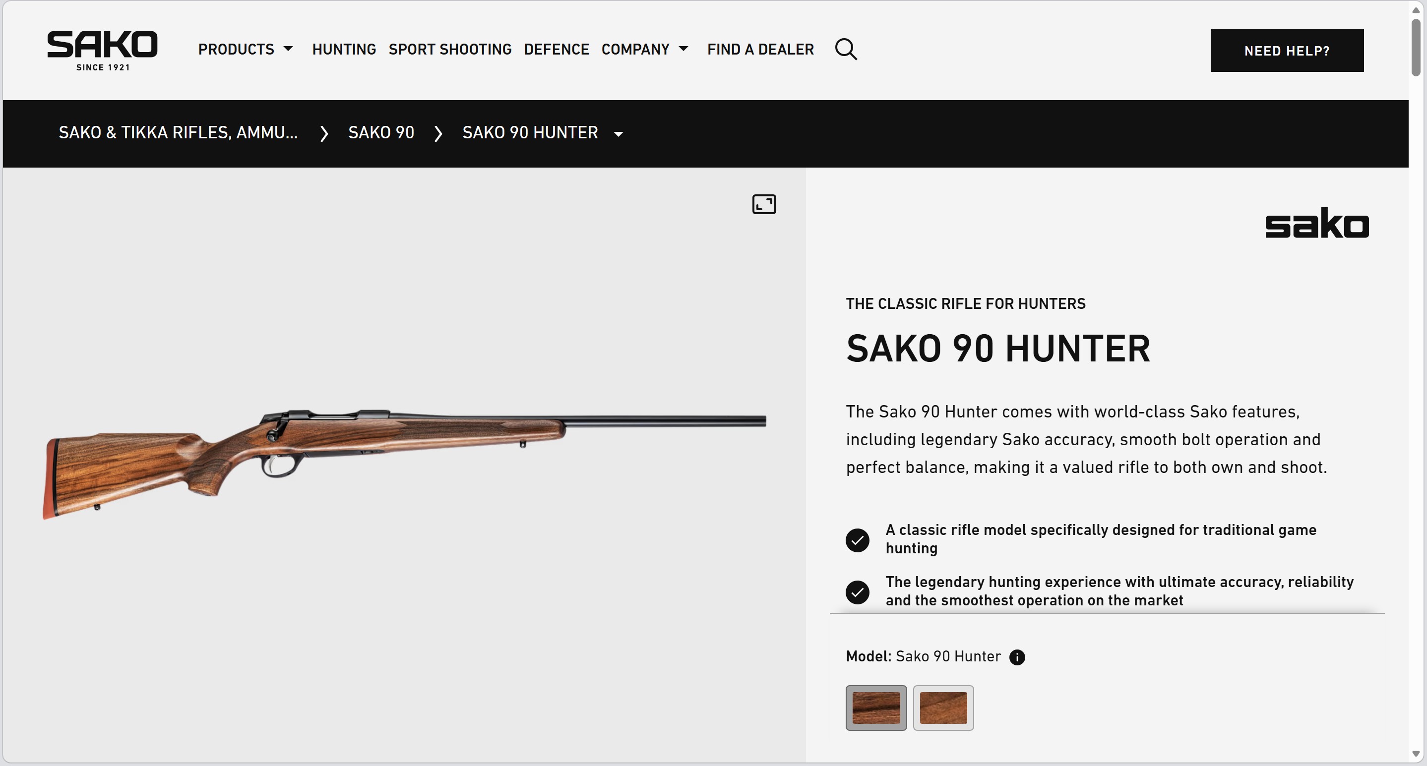

A .308 would make a handy ultralight mountain rifle, if I start looking at the bigger Sambar deer.
Howa are on the right track with those light rifles, .308 for men, and 6.5 Gaylord to sell a million.
