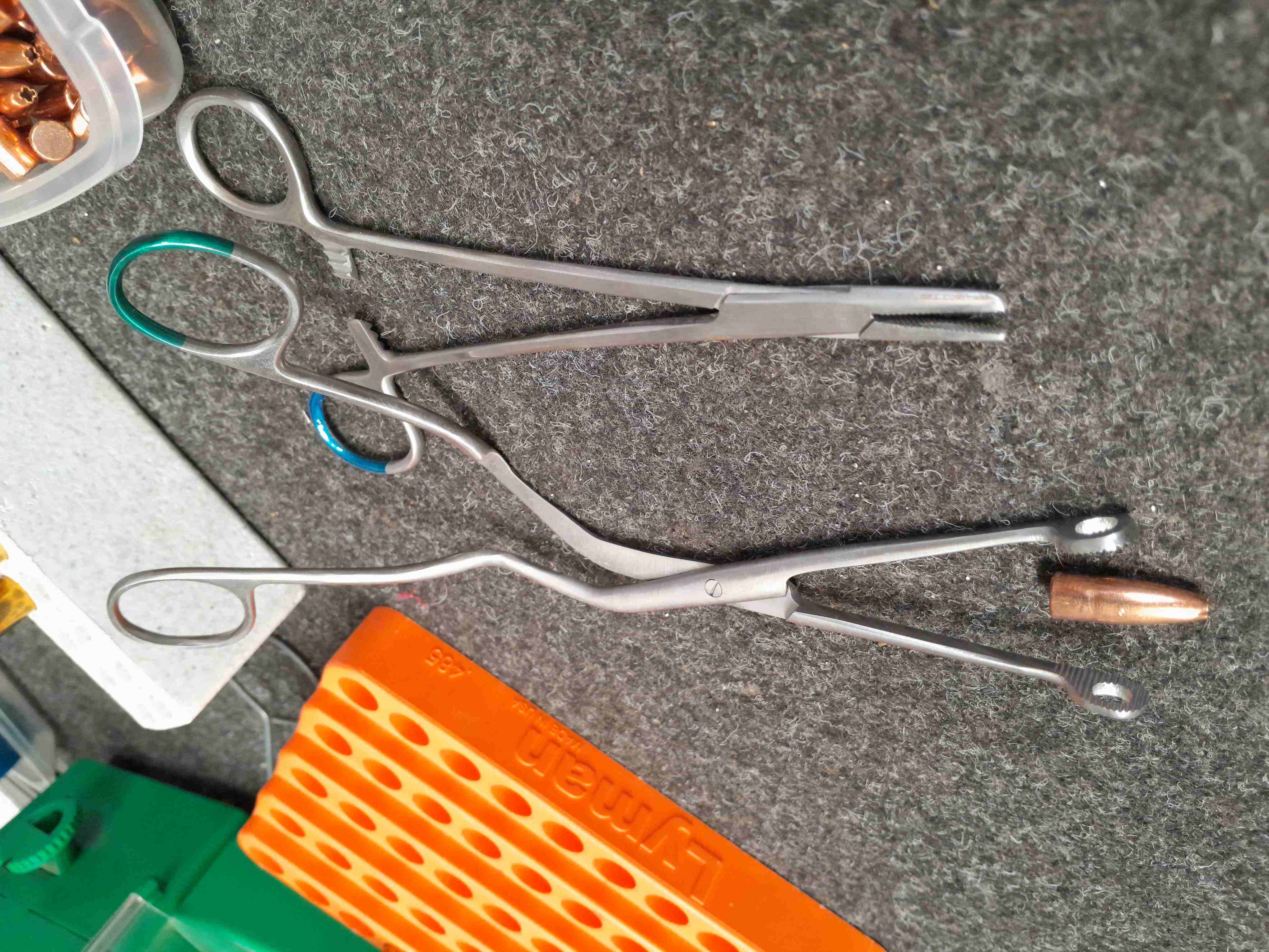

I use a large pair of stainless forceps with lumpy ends and bent shafts, leftover from operation kits, single-use ones.
I just grab whatever granules it will pick up, usually 1gn at a time, and just release them back into the hopper.
That way, the job is rally fast and I only have to pick up the pan once each cartridge throw. IF it accidentally overthrows.

Post by Wapiti » 03 Oct 2026, 10:42 am
Tweezers like this speed things up to rectify an accidental clump of powder when it falls out of the tube into the pan.
Just grab a bit of powder, drop it back in the hopper and usually the powder weight is spot on in the pan and on the display without trying to tip some out, reweighing etc

Post by Fester » 03 Oct 2026, 12:58 pm
My .223 Super roo load is 24.6gr of 8208 and it's a beauty, a bit flatter shooting to 2 and 300 than the original low node load of about 24gr.
I could get away with leaving the .1 overthrows, as I load boxes of weight-matched projectiles for the range, and unsorted for hunting and offhand practice.
Using the 2 weight-matched pans, it's only about 5 seconds to tip the 3 or 4 granules into the second pan, and go solo for the next fill.
I tip the granules into the filling pan, and back up to speed.
Wouldn't really have to re-check the readout, but why not?
I thought about some sort of tweezer-type thing, but never got around to searching the right instrument out.

Post by Wapiti » 03 Oct 2026, 8:13 pm
Mate. If you want a couple, PM me your address. I'll send you a few, for nix. I have access to gazillions.
