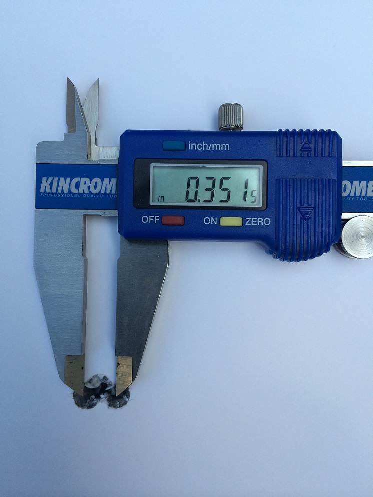

Thanks Tiiger for the info this topic sat stale with no answers for awhile :cry:
I set up the load work up on the weekend and worked through all the different powder charges and got some good results
I wanted to try out my new Magnetospeed v3 so I loaded twice the amount of rounds needed so I could test if it had any POI change or any change in group size when using it
The results for the Magnetospeed were there was NO POI change or change in group size despite what the LGS had told me when I was sold the item
And as for the initial load development 46 grains of 2208 behind a Berger 175g BT traveling at 2804 fps with a SD of 2.4 produced these results
3 shot group at 100m
Its a fairly hot load but there were only small pressure signs (primer cratering and faint ejector mark)
46 grains.jpg (164.64 KiB) Viewed 5493 times
