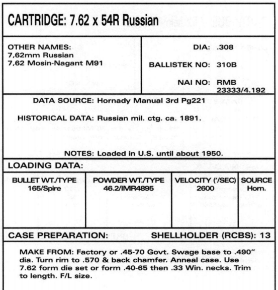

I'm looking to start reloading for 7.62x54r and most of the brass I've found is a bit expensive. I have a surplus of 30-30 brass and looking at the specs for both cartridges the only problems I can foresee is the 30-30's rim diameter is 1.5mm smaller than the 7.62 and the 30-30 is about 2mm shorter overall which shouldn't be a major problem.
Anyone know if the rim will give me major issues or know of any reason this wouldn't work?

Unfortunately no you can't, those two dimension difference you mention are huge problems but not the worst. the biggest problem is the head/webb area of the case is .046" too small and would rupture on firing.

You can use 45-70 GOVT Brass but they will probably be even more expensive.

looks like an investment in some virgin brass may be required... 30-30 is to small in the body apart from the rim dimension.... 45Gov too big in the rim and the body.... what kind of nugget? a carbine or a long rifle 91?

1290 wrote:looks like an investment in some virgin brass may be required... 30-30 is to small in the body apart from the rim dimension.... 45Gov too big in the rim and the body.... what kind of nugget? a carbine or a long rifle 91?
Yeah dam site easier to buy factory brass.
A bit easier to remove metal than add it if it's your only choice :cry:
