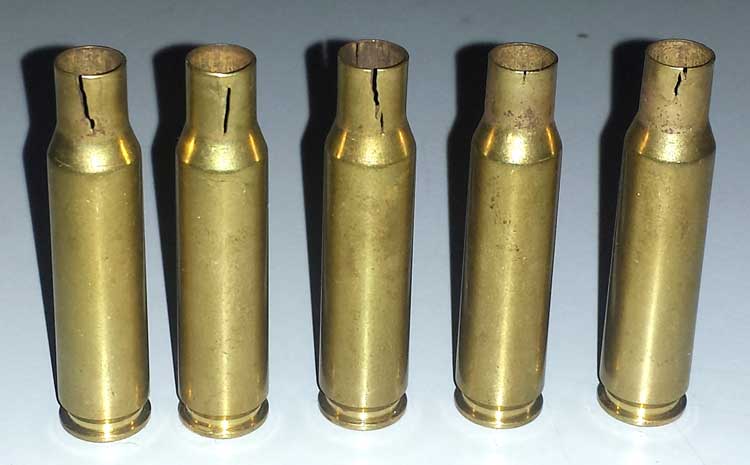

Post by Lorgar » 28 Jan 2015, 7:24 pm
Just sharing a bit of info here.
A friend gave me these few, brass from 100x Federal factory rounds loaded with 150gr soft points.
Each reloaded 3 times with 180gr pills and 42.5gr of 2206H (max load according to ADI) and fired. 4 shots total, 3 with heavy loads and this is the result.
All fired in a Ruger Scout. FL sized after shots. Only 100 cases so not a massive test but 6% failure rate after 4 shots (was a 6th case given that's not in the photo with the same problem).
Bit of info on life expectancy I guess for any choosing brass.
Lorgar

Post by deye243 » 29 Jan 2015, 12:46 am
As soon as I read the header I was going to write about the necks and then I opened it and wham there's your pic...
It was the same in my 7mm Rem Mag as I suspected when seating and neck sizing as they as hard as and in need of annealing.

Post by Jack V » 03 Feb 2015, 3:54 pm
That is the results of stress corrosion (age hardening). The brass hardens and shrinks hard around the bullet so when it fires the brass can't stretch much and splits.
The ammo could also have been exposed to ammonia from bore solvents which will speed up the process of hardening.
Also the brass could have been quite old and not ever annealed before it was loaded the first time.
Once stress corrosion sets in the brass is already fractured so even annealing might not save it from splitting, it might save some. Work hardening during reloading also adds to the problem.

Post by Lorgar » 04 Feb 2015, 11:25 am
Regarding possible causes in the reply above, I can add the following:
1) The ammo would not have been exposed to ammonia. I'm 99% sure he does not use an ammonia based cleaner and in any case I have reloaded with him and his setup and process is meticulous. There wouldn't have been any spill or transfer to the ammo.
2) The factory ammo the brass is from was bought new a maximum of 2 years ago, if not less than that. Plus however long it was on the shelf for.
3) The brass has not been annealed as part of the reloading.

Post by Jack V » 04 Feb 2015, 12:31 pm
sneaker wrote:How old does it have to be for hardening to start?
That is very hard to say . There are many factors . Purity of brass , annealed or not after manufacture , storage time and conditions , exposure to chemicals that speed up the process , number of times fired , how much work hardening has been done by reloading die system , cleanliness of stored fired brass.
New annealed quality brass un loaded will start to harden somewhat at about 7 years in good storage conditions . However as the case neck is not under stress it may not develop full stress corrosion .
If loaded the stress of the seated bullet will change things and it has been know to start in reloads at about 7 to 10 years . There have been cases of it happening much quicker under certain poor circumstances . It is interesting to note the Military try to fire off their small arms ammo at about 7 years or less.
In stored reloads it can happen quicker but the condition is variable . Some case necks will shown shrinkage below the bullet base indicating increased neck tension and others might not . Some may split on firing and some may not . Some thin brass can be work hardened so much by expander ball dies that the next time they fire the necks split but it may note be full on stress corrosion at that point if the were left loaded for a long time then it takes over and they could split without even being fired .
Once the neck starts to shrink and apply excessive neck tension a condition called neck weld can happen where the bullet starts to bond with the case neck . Again this is very variable but it can happen to a few in the batch and chamber pressure can rise quite high to move the bullet on that shot . In some extreme cases the neck can tear off the case and go up the bore with the bullet .
I can show photos of some of these conditions on 10 year old reloads that I did a storage trial on . Moly coating a bullet does help to decrease the problem of excessive neck tension due to age hardening and in my trial no moly coated bullet developed any kind of neck weld either in 10 years .

Lorgar wrote:Regarding possible causes in the reply above, I can add the following:
You don't know the history of the brass during manufacture and before loading in the factory.
It can be as simple as. Joe Blow the factory worker decided to swap his 15 year old but unused brass for new stuff at the factory. Old stuff chucked into the batch and new ones smuggled out in the lunch box.
The way some of the splits don't go all the way to the edge , and are crooked and jagged it just reminds me of stress corrosion. Without knowing exactly what happened from manufacture to loading to retail sale it's all guesswork.
You could also get chemical impurities within the brass during manufacture that could produce stress corrosion quickly within the brass or just plain fracture. Do a test and see how hard the necks are.
Jack V

Post by Warrigul » 04 Feb 2015, 7:50 pm
It is simply an overworked neck in my humble opinion.
The (small) problem with federal is it is good thick brass and a bit on the hard side to start with. Work it two or three times with a ball expander and this can happen, especially if you have a chamber on the upper tolerance and are squashing it all down with a fls die and flowing it into the neck area. Trim history would be interesting to see as to how much movement there has been.
I have also seen exactly the same happen with high count reloads that weren't annealed in time.
