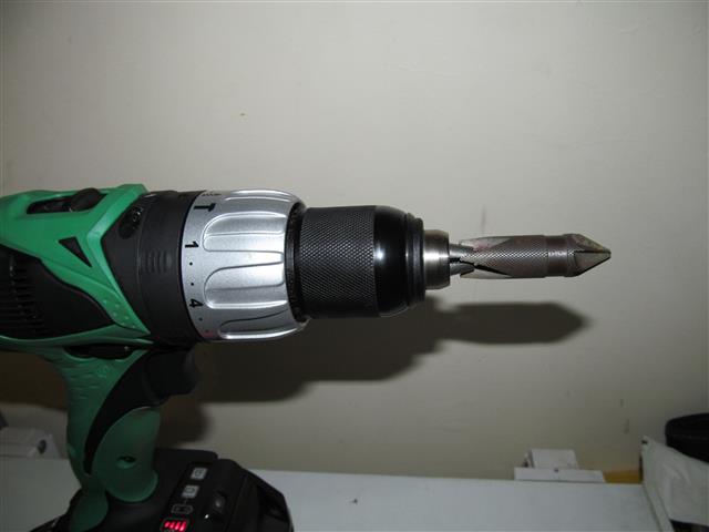

i use the RCBS one have done for more than 30 years
it works with all the pills i use from flat base to VLD
IMG_0708 (Small).JPG (29.83 KiB) Viewed 5824 times

Re: Which chamfering / deburring tool
Post by Lorgar » 16 Dec 2014, 2:29 pm
I'm using the same RCBS one as deye243 pictured above.
Has worked find in the half dozen calibres I've used it for.
Only comment would be that if you dig too deeply with it you can create thin, sharp necks but that's user-error, not a bad tool.
A light touch, just enough to remove the bars, and it's absolutely fine. Easy once you've had a few goes and got a feel for it.

Post by deye243 » 16 Dec 2014, 9:36 pm
yep a tad less that a second on the drill works just dandy

Post by pucker » 17 Dec 2014, 10:35 am
I never new the shape of the tool was to let you put it in a drill. Cool.
Any of you do it by hand with the same bit? or is it too hard like that?
pucker
Posts: 62
Post by Pilch » 17 Dec 2014, 10:36 am
It works by hand.
5-6 back and forths on the neck will do it.
