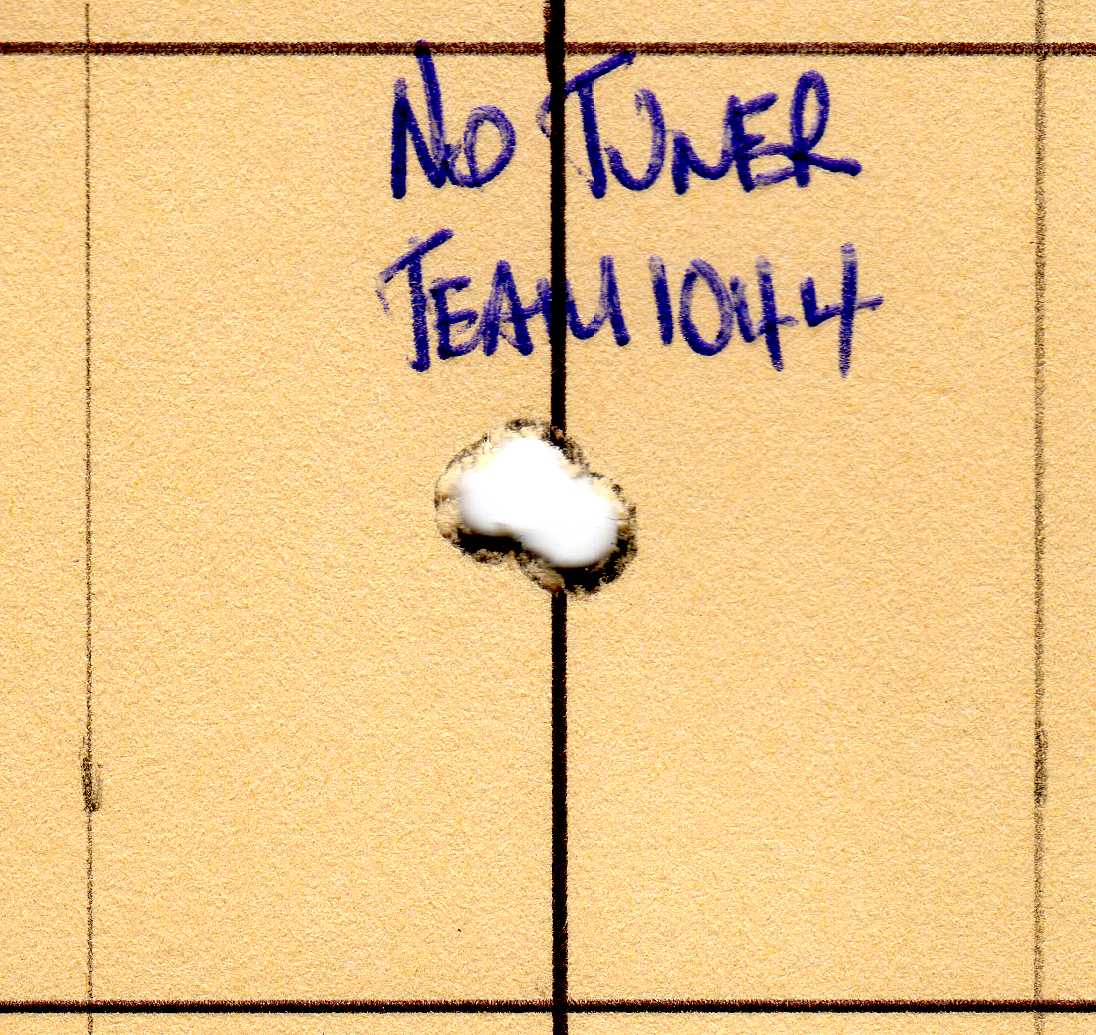

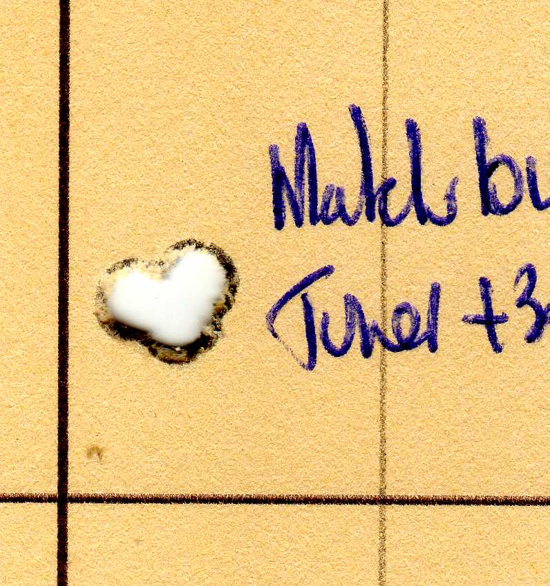

Anyone who knows about Rim fire Barrel tuners will tell you to look up the Purdie theory
http://wwaccuracy.com/showthread.php?18 ... experiment
It truly works as we at TEAM 1043 can attest to this :silent: :clap: :silent:
[email protected] (167.49 KiB) Viewed 7121 times

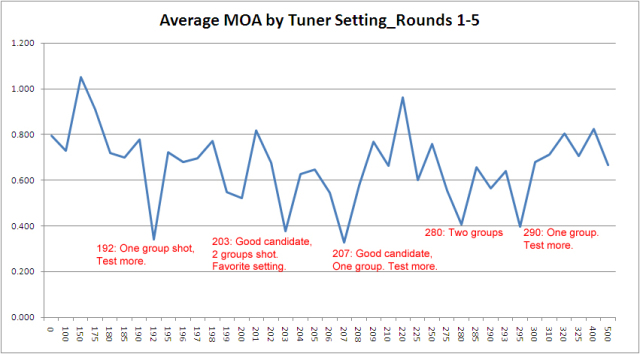

Post by huccl » 16 Mar 2015, 10:22 am
Interesting result from ingunowners.com website.
Group sizes plotted here as he went through the tuner settings, you can see a downward trend from about 0.8MOA average to the sweet spot of around 0.4MOA then starting to go up again.
Browning A-Bolt M-1000 Eclipse 308 Win
