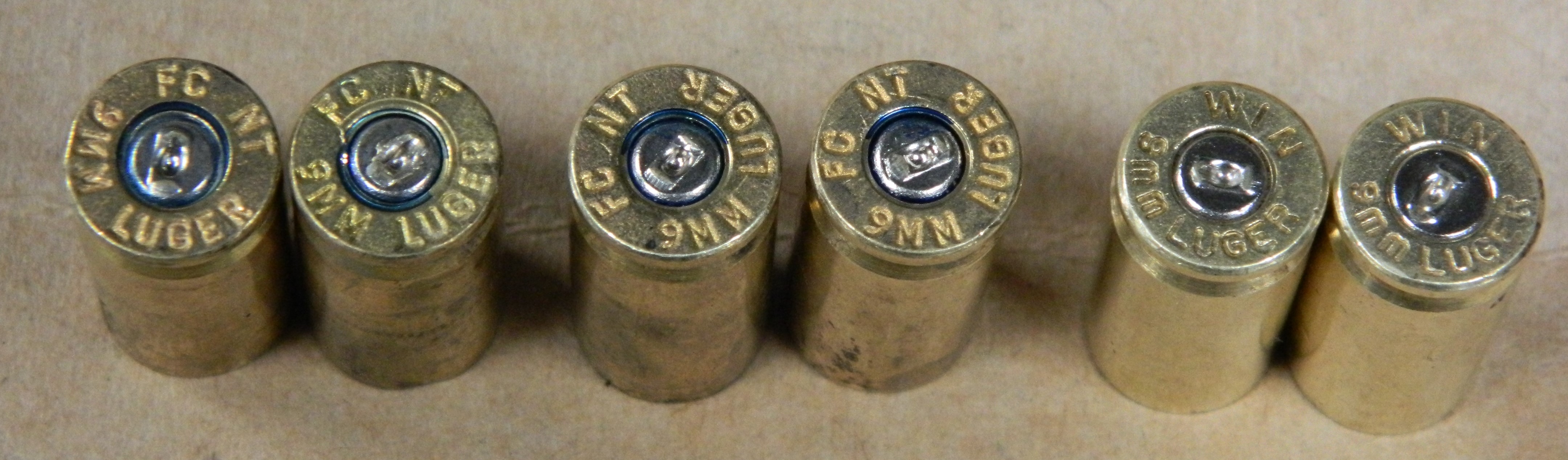

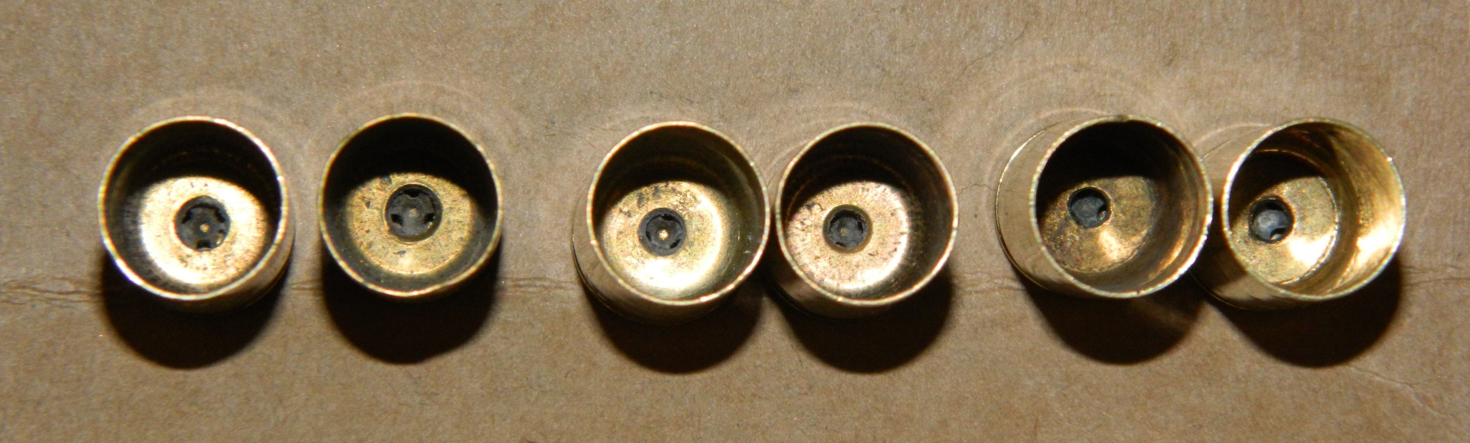

If you look at the primer flash holes, you can see that the left hand side two FC Non Toxic (NT) have large flash holes, the middle two FC NT have normal size flash holes, the same size as the two standard Toxic Winchester cases on the right!
From what I've read on this, because the primer Flash Hole is so much larger, it is recommended that you reduce your normal powder charge by some amount, to stop a large Pressure Spike from happening!
But then, I've spoken to some people, that have had no problems when using these cases.......................... but I don't know anything about what their normal powder charge is so???
Also, many of these NT cases, have their primers Crimped in place!
So to ease seating new primers, I De-Crimped them all.

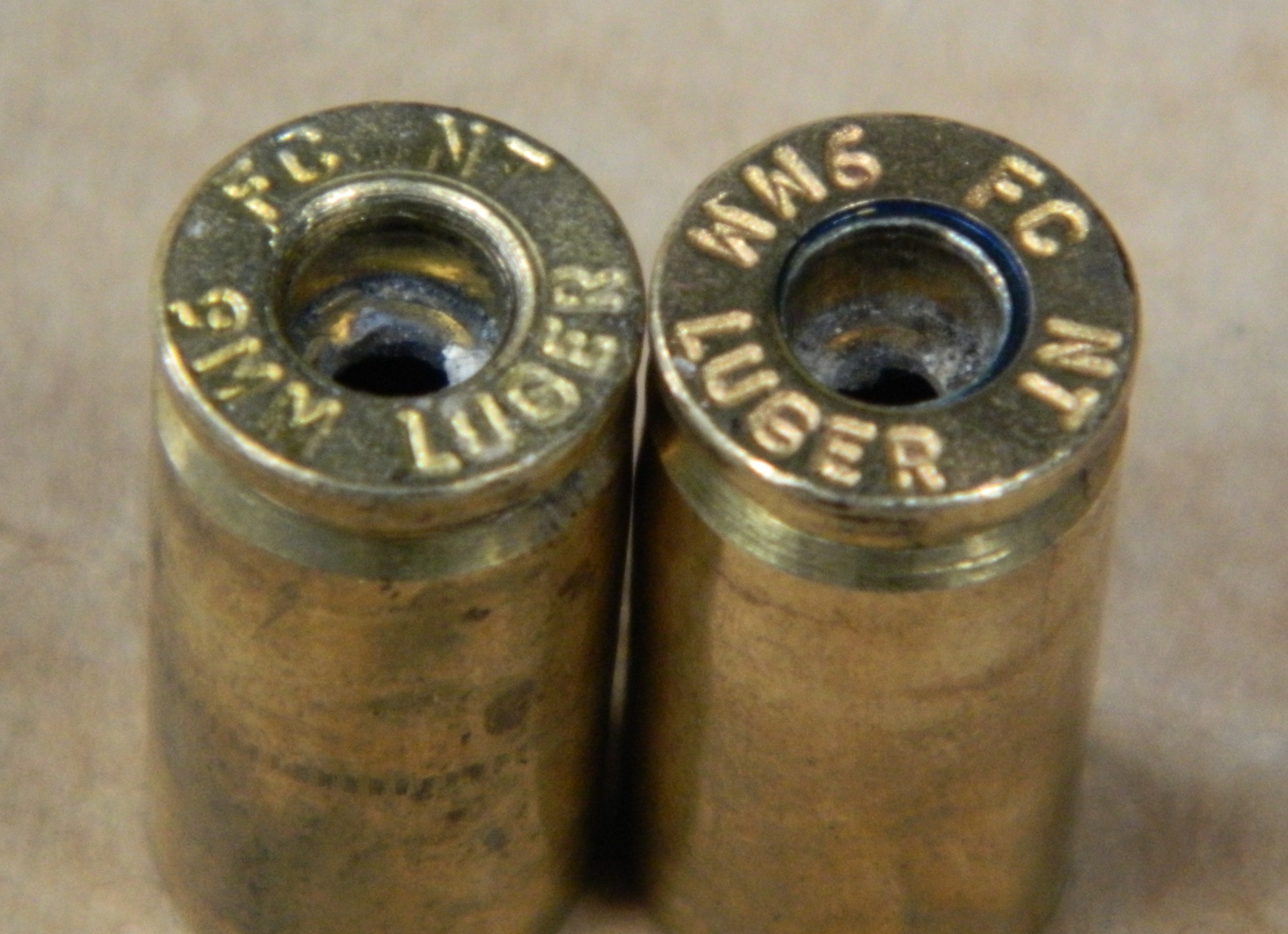

Here is an image of Before and After.

Could be the low lead/indoor safe ammo, that has a large primer, with enlarged flash hole, the NT bullet is light and the NT "green" primer isn't quite hot enough (internet lore, I'm assuming it's true, it makes sense), so they have opened the flash hole. The larger flash hole makes the crimp necessary to prevent primer blow back.

Larger flash hole would (arguably) change the accuracy/POI by affecting how the powder burns but I'm not seeing why it would necessitate reducing your powder load.
You're still igniting the same amount of powder as is supposedly safe with the smaller flash hole. There might be a change in curve of pressure but I don't see how it could push it so high to dangerous levels?

Basically Prettybird, the powder is being ignited faster, via the lager flash hole!
If another NT primer was used (with an appropriate powder type and charge for this primer), all would be OK.
But we are mixing things around and doing things that were never envisaged for these cases.
FYI, the primer flash hole, is like a restrictor or choke device to regulate the flow of the primer brisiance (sparks), into the powder chamber!
And similar to enlarging the Fuel Jet in an Internal Combustion Engine, this allows more "Go-Fast" into the system! Excuse my crude analogy on this but.......
So basically, the cases were cheap but they come with an additional need for Caution, when reloading them, hence this thread!!!
