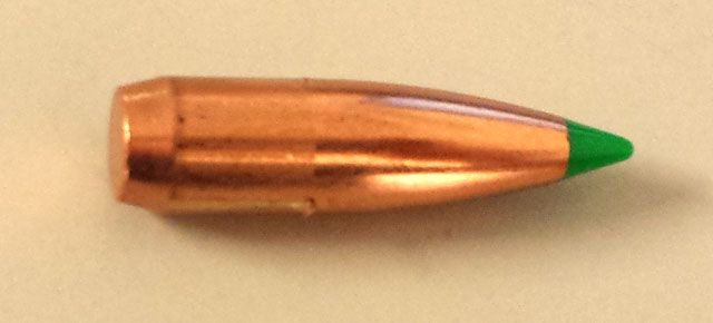

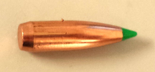

So I had a bunch of brass with I tumbled and trimmed a while ago and couldn't remember if I chamfered them or not...
I took a look at a few of the case necks and they looked ok, I thought bugger it, and wen't ahead with reloading them.
No surprise but had a few of these;
scraped bullet un-chamfered neck
Little orange peels of brass stripped from the bullets. Crappy photos of the bullets taken on my phone, but you can see the little barbs clear enough and the gouges in the bullet skins.
This is after I pulled them from the bras, there was more which came off while doing this.
Like I said, not really a surprise, but sharing for new reloads as a mistake to avoid.

Getting slack, Lorgar :P
You chucked those bullets after obviously? How many did it cost you?

One of the first reloading mistakes I made was exactly this. Easy enough to do lol

Yep. One of those ones where the benefit isn't immediately obvious and it's easy to talk yourself out of doing it.
