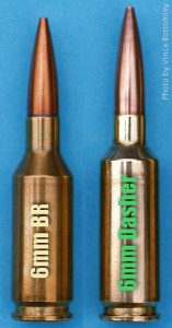

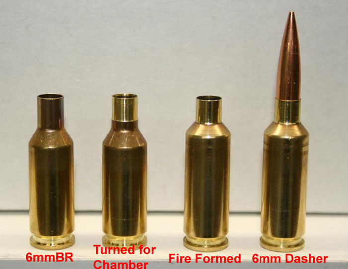

As you can see in the photo above the cartridges are the same except the shoulder of the 6mmBR case is lower than the 6mm Dasher case.
You fire the 6mmBR cartridge in a 6mm Dasher rifle and the pressure expands the case to match the Dasher chamber size.
Bit of a start to finish series here (just look at the cases, ignore the one bullet).

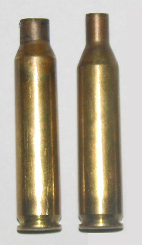

Here are the cases side by side.
It's quite a downsize and you might find you'd crumple the shoulders slightly when you size them. Also, case length of the .223 Rem is 45mm while the .17 Rem is 45.6mm so the necked down cases would also be slightly shorter.
Once you sized them down and loaded them though, then you would shoot them and that fireforming would reshape any crumpled shoulders and stretch the necks so you've had some good brass after that initial firing.

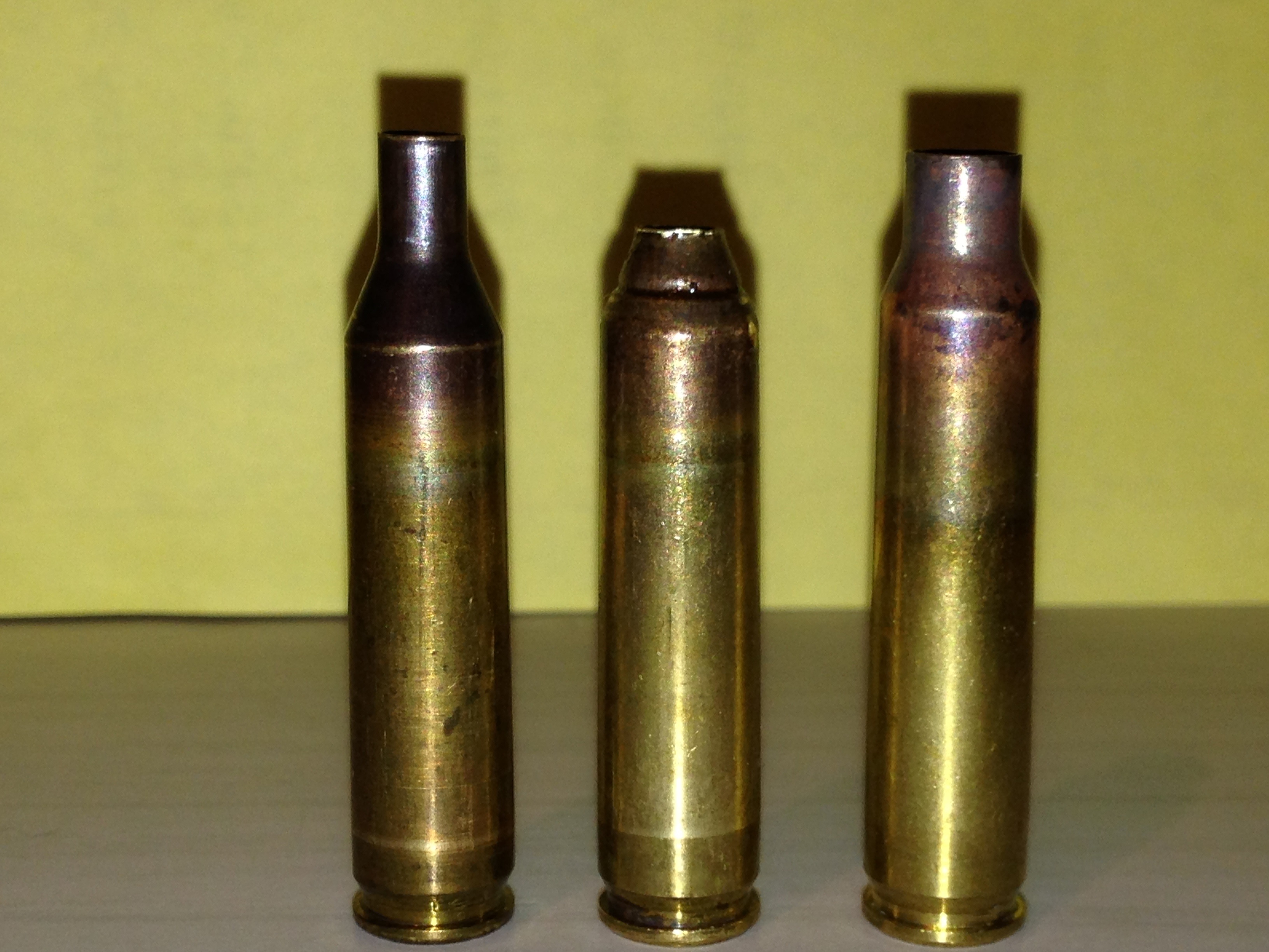

Post by ColJ » 19 Jan 2016, 5:26 am
So the.223 is on the right, the.17 on the left and in the middle is the "resized" case.

Post by Khan » 21 Jan 2016, 1:54 pm
Looking at that squashed case it's a big step down for once pass.
It's a whole other bit of gear and work to be done but I wonder about turning the neck first to remove some material first and make downsizing easier.
