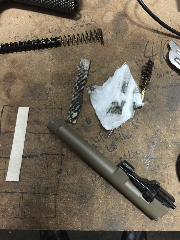

Hollywood wrote:Thanks brett1868, appreciate the advice on this thread. I'm struggling to get the fouling out of the concave sections of the rifling without physically scraping it out from the muzzle end. What solvent are you using?
Get some LeadAway.
I've run patches that come out clean (using Hoppes No 9 etc).
Then ran a patch of LeadAway through. With what came out, you'd think the gun had never been cleaned!
The 3.3 load that I mentioned, is using AP50, not AP70. I'm running 138gn Round nose pills, god knows how many times the brass has been loaded (I look for cracks etc - alot of time on my hands). This is with a Sig X5. My H&K USP eats anything, but, the Sig prefers round nose. Can't get decent groups with anything different.
Its amazing as to the variance with so many different issues affecting different pistols. You never stop learning with this hobby.
Get some LeadAway.
This the Birchwood Casey Cloths" Cut into a patch? or something different?
Maybe these?
http://www.db-shootingsupplies.com.au/kleenbore-lead-away-patches/

Brett, I use the exact brand that you've linked to. I think Kleen Bore and Birchwood Casey both make a lead removing cloth. You can either purchase patches already cut or buy a sheet and cut your own to size.
Honestly, if you haven't used this stuff after shooting lead projectiles, you'll be very surprised with what comes out on the patch, even after repeated use of typical firearm cleaners.

I cut a strip and wrapped it around an old brush before scrubbing a barrel I "thought" was clean....Took several strips of lead remover cloth and some scrubbing to remove all traces of lead. I dry patched it after each scrubbing and checked with the bore scope for any remaining deposits so I could scrub that specific area. Next experiment will be to shoot some lead and check the barrel with the bore scope then shoot some jacketed rounds and see if it removes the lead cause its far easier to clean copper then to scrub lead.

Brett, my cleaning procedure for pistol (I only shoot lead projectiles as jacket ammo and FMJ aren't allowed at my club):
1. Wet patch of Hoppes or similar (I've got every brand known...) using cleaner tip that has brass scrubber incorporated.
2. Leave for 5 mins
3. Dry patch
4. Lead remover patch
5. Dry patch
6. Lead patch again
7. Dry patch till clean
Oil the required areas or spray G96 everywhere.....
I use a similar method to above for rifle, but Sweets get used.
