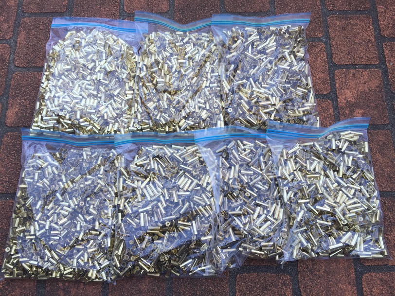

This month I've loaded a few hundred rifle which is down on average but I've loaded just over 10,000 pistol rounds. Not hard to load big numbers using the Dillon when you can punch out 400-500 per hour. I've been buying 30kg lots of once fired brass which I lube, resize and wash ready to load as seen in the picture below. Saturdays are spent preparing the brass which is then loaded over 2-3 nights during the week depending on family commitments because they come first.
25kg of brass prepared and ready to load
Re: How much do you reload?
Post by petemacsydney » 29 May 2016, 6:25 pm
brett1868 wrote:This month I've loaded a few hundred rifle which is down on average but I've loaded just over 10,000 pistol rounds. Not hard to load big numbers using the Dillon when you can punch out 400-500 per hour. I've been buying 30kg lots of once fired brass which I lube, resize and wash ready to load as seen in the picture below. Saturdays are spent preparing the brass which is then loaded over 2-3 nights during the week depending on family commitments because they come first.
hhhhhmmmm, brass... and lots of it! Noice!
