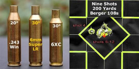

Hi guys another topic on my varmint build just thought I'd ask if anyone has experience with this cartridge if not what are your thoughts on it in very seriously considering it for a dual purpose varmint target round it appears to be from all accounts a lengthened 6xc case that can be made by simply full length sizing .243 cases which means I'll have no brass availability problems like the 6xc.its essentially a .243 with a 30• shoulder and long neck for more bullet and seating options It's also supposed to have better barrel life than the .243 with similar velocities.
What are your thoughts opinions?

If you were looking for something for target only id say go for a 6BR or 6 Dasher instead but as a hunting round the SLR packs a bit more punch.
I'm having a 6XC built and I just bit the bullet and bought 200 Norma cases and Wilson inline dies. Performance with similar weight bullets is supposed to be equal to .243 but less powder and the sharper shoulder should mean longer brass and barrel life. I don't normally loose brass and I don't see the point in chambering a new barrel in .243 trying to save 40c a case then spending more because you occasionally buy factory ammo and burn the barrel out quicker.
I know Matt Peroz at OLRP has built a few 6mm SLR's as well as a few .243AI's. But he's probably built dozens of 6BR's and Dashers as well as 6X47Lap's. Might be worth having a chat to him.

MalleeFarmer wrote:It's also supposed to have better barrel life than the .243 with similar velocities.
Just regarding that, I'm never convinced about such claims. Always feels like they tack it on the end of the write up as a nice little cherry for whatever cartridge they are talking about.
Put the same bullet down the same barrel at the same speed.... How one thinks barrel life will be significantly different here because it left a different shaped case I cannot say.

Post by MalleeFarmer » 06 Apr 2016, 1:10 pm
The sharper shoulder and longer neck supposedly keep the powder in the case better as it burns and helps to keep from torching the throat with burning powder exiting at full temp. Supposedly.

[quote="MalleeFarmer"Its essentially a .243 with a 30• shoulder and long neck for more bullet and seating options[/quote]
More bullet options? What goes in a 6mm super LR that wouldn't go in a .243?

Tonit wrote:[quote="MalleeFarmer"Its essentially a .243 with a 30• shoulder and long neck for more bullet and seating options
More bullet options? What goes in a 6mm super LR that wouldn't go in a .243?[/quote]
The longer neck is supposed to be able hold heavy bullets at ideal seating depth but also allows to seat shorter bullets out further towards the lands without having a marginal neck hold on the bullet. :allegedly:
