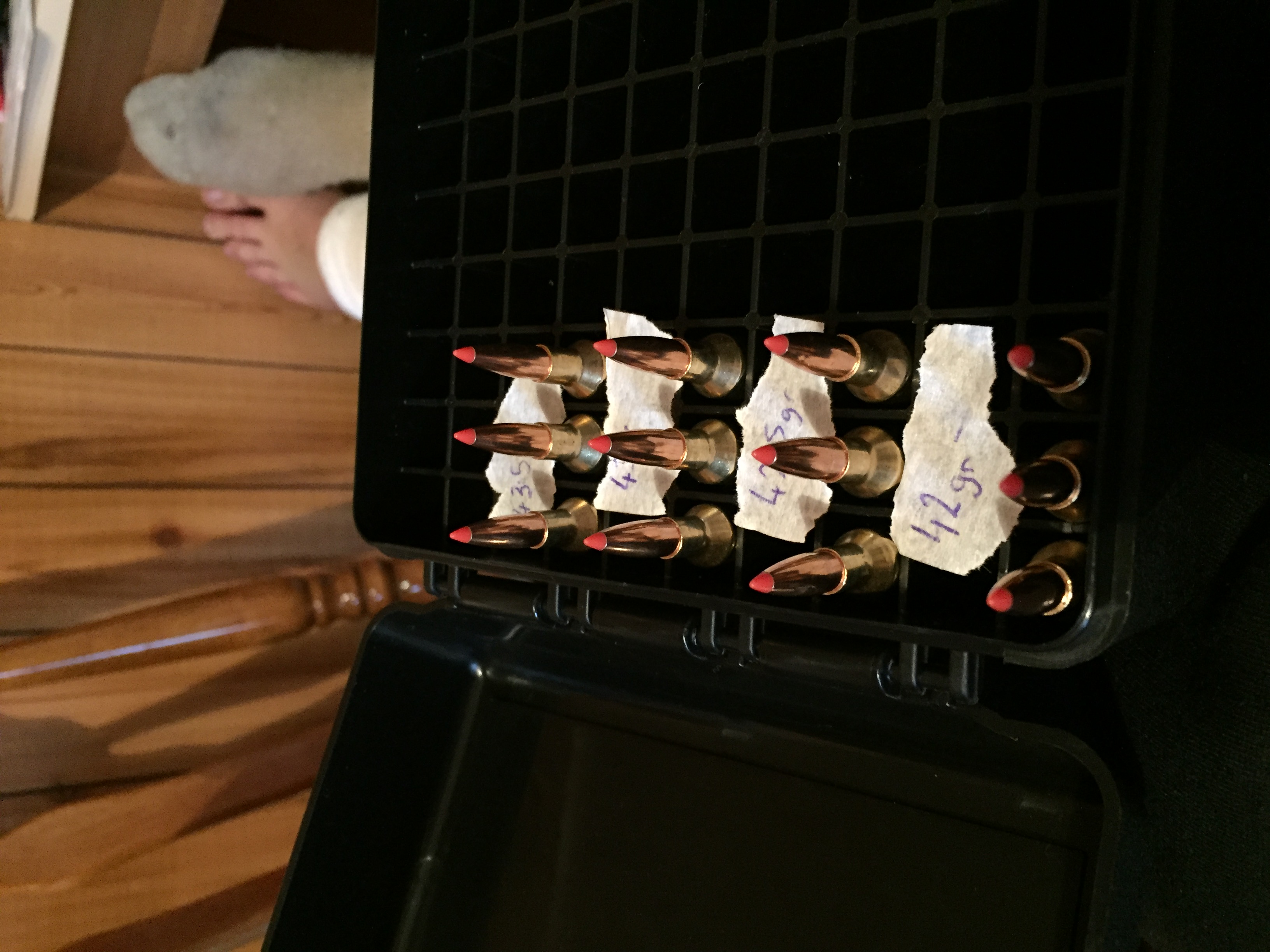

Post by MalleeFarmer » 19 Aug 2016, 6:04 pm
Ok so I liked Gwions system so I'm going with that for now. Loaded up 12 starting from the minimum of 42gr or AR2213sc up to .5 below max at 43.5gr just have to wait till my pillars are back so I can finish bedding my rifle and my leg is sorted so I can start testing.
