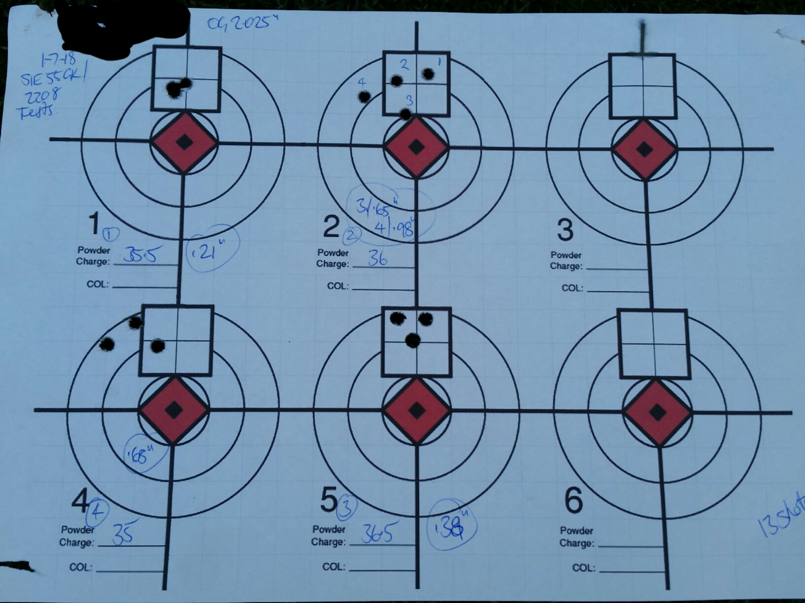

Post by Stix » 03 Jul 2018, 3:06 pm
Im curious to hear peoples opinions of where you would go next with either of these two loads....?
ALSO...im curious to know what other 22-250 users are loading & what velocities you are getting...?
The charges listed are the highest tested, & so far no signs of pressure that i can tell...
All at 100m.
The brass was all formed & neck sized prior to these shots, & all rounds were seated at .010" off the lands
Ive only chrono'd the zmax loads & not happy with the velocities--the 36gr load with 50gr Zmax is only reading 3490-3500fps, which probably means the 55gr SIE GK with 35.5gr/2208 is probably only doing hot 223 velocities...im not sure what to expect as a norm, but i intend to check that against a different chrono to see if my magneto is a bit crook.
(This is the rifle i was getting some double grouping with--i pulled it out of the stock & replaced it with an extra 5in/lbs on the front screw & it appears to have fixed the problem--touch wood...! not one double group out of nearly 40 rounds :thumbsup: )
Anyway, any thoughts on where you would further proceed appreciated...
Thanks. :)

Second load...
SIE 55GK/2208
SIE 55gr GK/2208
2018-07-03 14.02.52.jpg (1.1 MiB) Viewed 19851 times

I wouldn't worry about chasing velocity at all, accuracy beats velocity every time.
I probably wouldn't be making a decision based on just four rounds. I shoot at least two five-round groups when looking for an accurate load. Shoot the first group with each charge, then shoot the second groups with the same charges. With Trailboss loads I prefer to shoot four 5rd groups, but twenty-round sessions are hard on the rifle with full-power loads in hot cartridges. Your 35.5gn load looks like it has potential with both bullets. But you could find that your test groups were anomalies, the good ones and the poor ones, so you make up a hundred rounds that don't group as well as they did in the test.

Your groups have a fair bit of vertical, either a lack of speed or gun handling. Check your front bag or rest, your rifle needs to come back to the same point each time. Don't lift your head from the stock between shots. good luck with it.

SCJ429 wrote:Your groups have a fair bit of vertical, either a lack of speed or gun handling. Check your front bag or rest, your rifle needs to come back to the same point each time. Don't lift your head from the stock between shots. good luck with it.
The setup i used for the day wasnt ideal, & i did get a bit of fatigue part way through the day, but when you say speed, I assume you mean speed in the bullets velocity...?
And what exactly do you suggest checking for in the front rest SCJ...? (I used the same bag i throw over the bonnet for a fox).

You will find that if the stock is sitting at a different place for each shot on the front rest you will get more vertical. You may also find that slow speeds also have more vertical, when the speed increases and you get it into a node, the vertical goes away.

SCJ...the rifle is an ultra light & i find i get way too much muzzle jump if i shoot off of a 'solid' rest-no matter how relaxed my shoulder is.
I have to a point tried free recoil but the trigger is too heavy for that given how light the rifle is (still original tikka spring wound back to its lightest). But im pretty sure my rear rest os the problem.
Thanks for the tips on technique...
