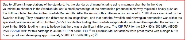

Post by No1_49er » 12 Nov 2018, 8:55 am
For anyone who has doubts about the strength of the "old" Swede service rifle, check what is said here about proof loads.
6.5 SKAN proof load
6-5 x 55 SKAN proof load.JPG (68.15 KiB) Viewed 13186 times
This includes the M94s, some of which still exist, but even I would probably only be looking for an accuracy load rather than "full house"!

Re: 6.5 x 55 Swede Top Speed
Post by bigrich » 12 Nov 2018, 9:20 am
Yeah, I’ve heard and read about the over proof loads and that the old Swedes are stronger than people give them credit for, but loading up full house loads in a 100 plus year old rifle isn’t something I want to put to the test . I have heard of receivers being stretched from heavy loads
