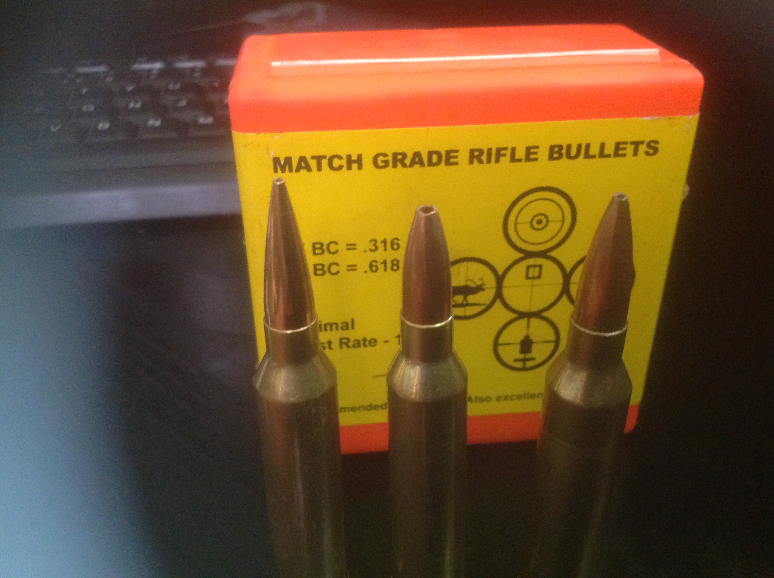

Post by duncan61 » 03 Mar 2019, 6:38 pm
The topic is about bullets so check this left to right the 168 Berger VLD, 100 sierra game king and 168 Matchking.the ogive on the VLD is considerably longer than the Matchking.will test them soon
Re: Difference between gamekings and matchkings for targets?
Post by Kelsey Cooter » 03 Mar 2019, 9:08 pm
The shape of the vld looks kind of odd when you compare it to the other 2
