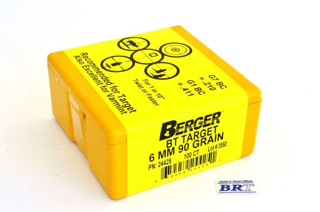

Post by duncan61 » 28 Apr 2019, 9:21 pm
From what I can deduce 90gn will be my heaviest bullet that will stabilize in my 1:10 HOWA.Has anyone developed a target load for .243

I have a target load for my 1.10 Sako I think it is 1.10. I also use those Berger 90 gr BT Targets. The bad part is I am in hospital just now and wont be home till next week. If you can wait until then happy to divulge. On another not I also shoot a couple of 105 grn hunting bullets with very good accuracy out to 500yrds.

sungazer wrote:I have a target load for my 1.10 Sako I think it is 1.10. I also use those Berger 90 gr BT Targets. The bad part is I am in hospital just now and wont be home till next week. If you can wait until then happy to divulge. On another not I also shoot a couple of 105 grn hunting bullets with very good accuracy out to 500yrds.
