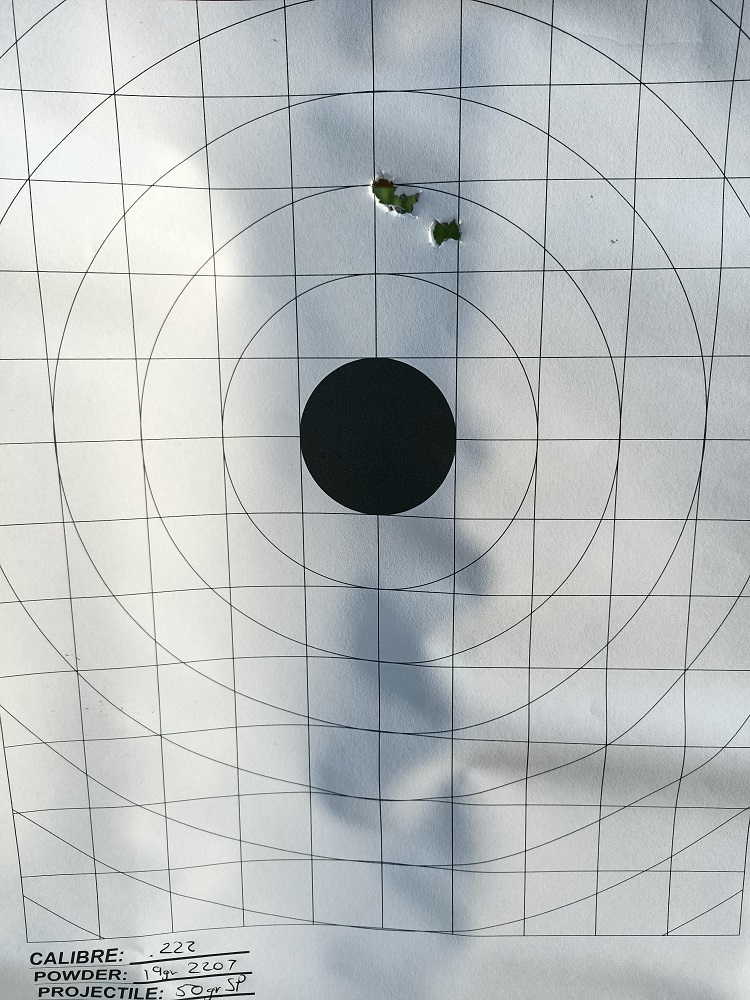

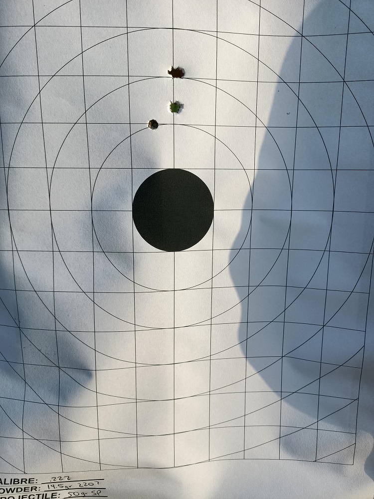

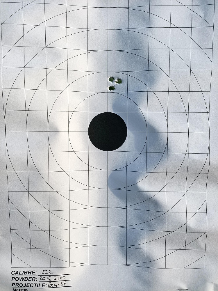

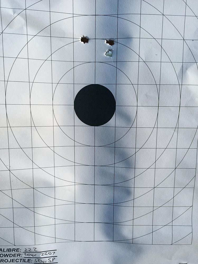

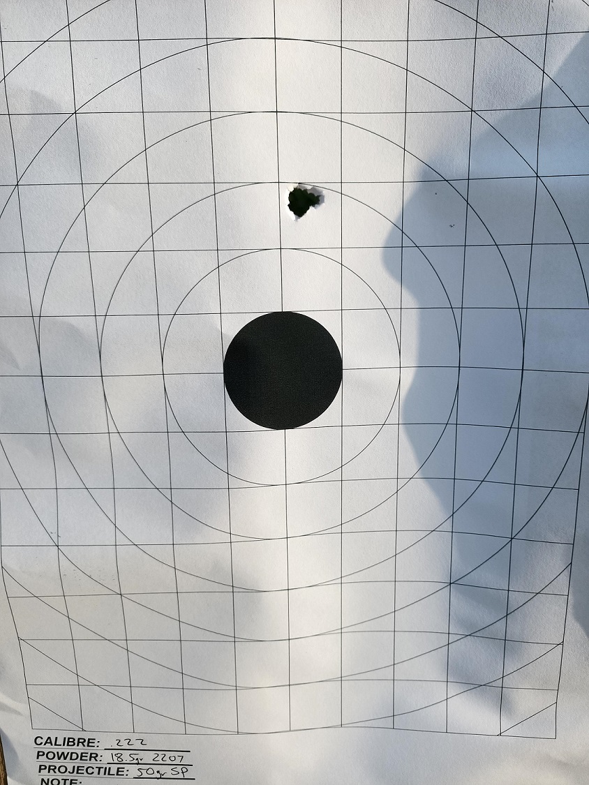

Post by Am88 » 20 Jan 2020, 8:55 am
Done some testing Saturday morning for one of my new second hand .222’s, wondering if anyone has some advise on a next step, 5 x 3 shot groups at 100m, with 18.5, 19, 19.5, 20 and 20.5 grains of 2207 behind a 50gr Sierra Soft point, bullet #1330. The gun is quite capable of shooting well as shown by the 18.5gr group. Unsure however on the next step, they all seem to have a POI very much the same, so would I be better off sticking to 19.5 or 20 grains and tuning with OBT method? or maybe loading up 3 with 21grs to see if there is any pressure signs and it keeps same POI, and tuning length of the 20.5 load? I wanted to keep it on the zippier side of things for a .222.
There were no pressure signs at 20.5 grains either it showed no flattening of the 3 primers. Powder charge is in the bottom left corner of the photo.
18.5gr 2207.jpg (324.11 KiB) Viewed 8143 times
19gr 2207.jpg (291.55 KiB) Viewed 8143 times
19.5gr 2207.jpg (278.54 KiB) Viewed 8143 times
20gr 2207.jpg (307.81 KiB) Viewed 8143 times
20.5gr 2207.jpg (313.02 KiB) Viewed 8143 times

Post by marksman » 20 Jan 2020, 9:38 am
it certainly likes the 18.5
adi max loads can be a bit conservative so l would give it a go myself as long as you do not see pressure signs
l think you will find you are heading to the next node :thumbsup:
the rifle shoots well all the groups although differing in size clock the same
l also like how you have gone for big changes in powder (.5 gr) most people would start off with smaller weights
it takes away a lot of fuss and when you find the sweet spot you can do a smaller OCW for fine tuning :drinks:
looking good to me :drinks:

Post by Am88 » 20 Jan 2020, 9:57 am
It definitely does marksman, what I forgot to mention is included in the 18.5gr group was the first shot, which was also cold bore and had a snake run through it with hoppe's a couple of times with no fouling shots, because I forgot lol. Im also fairly confident that the low left shot in the 19.5gr group I pulled.
What sought of length variation do you try with the OBT method? never tried this way of doing things. 0.02"? 0.05? etc.

Post by Stix » 20 Jan 2020, 10:34 am
That looks excellent Am88... :clap:
Id agree with whats been said already...
If you're so inclined, being sensible, go higher--looks like the node isnt far away at all-- give it a try...but personally, id double check around the 18.5 mark...
I only shoot in increments of .3 because from my experience with my gear, its almost impossible to tell the difference in .1 or .2 of a grain diff at 100 with a factory rifle (or the ones i have anyway).
Having said that, none of mine shoot as good as what you have there...
Im not the expert, but if i got that result, id try 2 steps in either .2 or .3 grain increments above & below the 18.5, twice each, but include 18.5 as well...
(In other words...3 shots of 18.1, 18.3, 18.5, 18.7, 18.9--then repeat it again...)
Id also load another 9 (3x3 groups) of the 18.5--shoot one group of that on a clean barrel to start the test, & once finished use another group for any minor scope adjustments...
And even if you dont need them for the testing, you're still gonna shoot out a bunny's pupil & exit out the other at 100...even if you find a better load... :)
And although it means nothing in comparison to your rifle, my 222 loves the lower end of charges with 2207 as well....

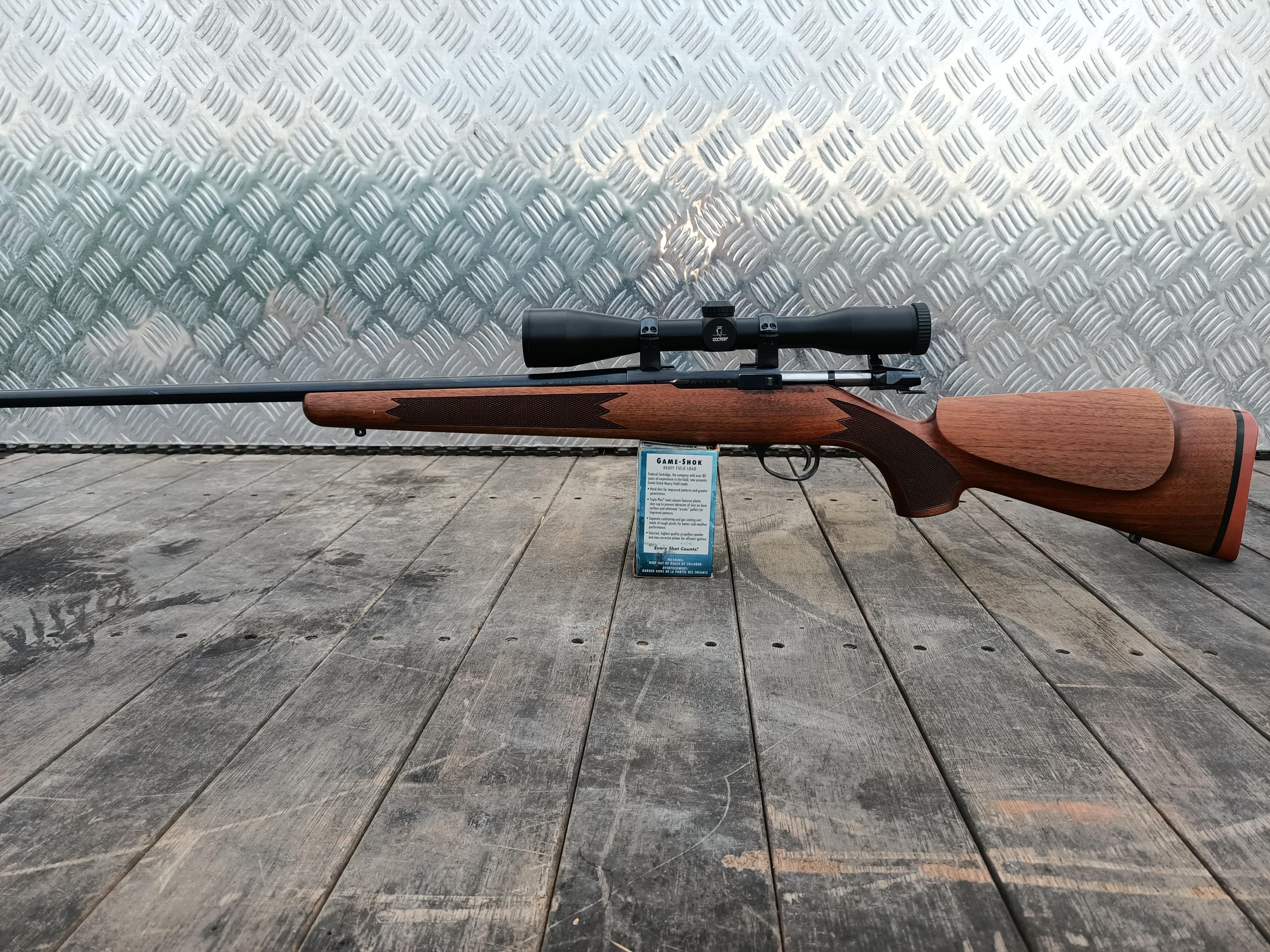

Good stuff going on there...contact me if you want to get rid of that rifle... :) :mrgreen:
Well done... :clap:

Post by marksman » 20 Jan 2020, 10:49 am
Am88 wrote:It definitely does marksman, what I forgot to mention is included in the 18.5gr group was the first shot, which was also cold bore and had a snake run through it with hoppe's a couple of times with no fouling shots, because I forgot lol. Im also fairly confident that the low left shot in the 19.5gr group I pulled.
l really dont think you are going to need to do this but l will usually start at 20 thou jam, touch, 20thou jump, 40thou jump and usually you will have found something, l really dont think you are going to need to though
what Stix said is what l would be doing :drinks:
that rifle is a keeper do not let anyone talk you into selling it to them :D
Re: OCW test .222
Post by SCJ429 » 20 Jan 2020, 11:10 am
I like 20 and 20.5, not a lot of vertical. Depending on what pressure signs you are seeing, I assume none, I would shoot them again along with 20.7 and 20.8. Even go further if you are shooting well with no signs of pressure.

Post by Am88 » 20 Jan 2020, 11:18 am
This is good to hear so thanks for the replies, I'm happy that other people say i got a good result means Im on the right track, never tried this OCW stuff, I will do some loads in the 18gr area at the same length, that of which is the length given by all the manuals I got info from. I mentioned keeping it zippy, as I got this rifle as a walk around to head or neck shoot Chital which I did as seen in my other post with some 50gr soft point remington factory loads. the #1330 sierra is classified as a varmint bullet but a high velocity bullet made for the .22-250 and .220 swift as seen from this snippet from the sierra site.
"This bullet is slightly “hard” at 222 or 223 Remington velocities, but are especially well suited for velocities from 22-250 and 220 Swift cartridges"
would being on the slower end of the spectrum get me into trouble here? I fully understand shot placement is key in all this. I've made more chital fall with a .222 then anything else, and truth be told it's mostly 50gr vmax's.
I don't think I'll part with this one Stix :lol: I cannot remember the gunsmiths name for the life of me now, but I bought this rifle of an elderly gentleman maybe mid 70’s now at best guess, who got it off his father when he died, his father bought the rifle new, straight to the gunsmith, it has front and rear action bedding, a beautifully light trigger, approx. 100-150 shots he said doing load testing before he died. He had 23gr of 2205H behind a 55gr Sierra boat tail #1365 for head shooting red deer.

Re: OCW test .222
Post by Blr243 » 20 Jan 2020, 7:15 pm
I wood do more testing with the 185 and the205 loads

Re: OCW test .222
Post by SCJ429 » 21 Jan 2020, 9:48 am
Jumping up by 1/2 a grain is huge for a 20 grain load. You could jump past a node with such a large increase. A 20.7 will help revalidate your 20.5 load. I would think that both 18.5 and 20.5 could both be nodes, you just shot 18.5 better. Next time 20.5 might be a smaller group.
If your keen after that you could try 20.9.

SCJ429 wrote:I like 20 and 20.5, not a lot of vertical. Depending on what pressure signs you are seeing, I assume none, I would shoot them again along with 20.7 and 20.8. Even go further if you are shooting well with no signs of pressure.
So you dont like the one hole group that has the least vertical...?
Im curious why you prefer those groups...?
Re: OCW test .222
Post by SCJ429 » 21 Jan 2020, 2:14 pm
They are a whole heap faster than 18 grains, the 222 is only a small case and you need every bit of speed you can get. Also 21.5 fills the case better. When shooting small samples, three shots, you can make loads look better than others. If you reshoot either load, I am betting that they end up around the same size in aggregate.
You can always go back to 18.5 if 21.5 does not work out, I am betting that 21.5 is in the node and a bit of extra powder, 21.7, might be pretty handy too.
Re: OCW test .222
Post by marksman » 21 Jan 2020, 5:37 pm
having a look at your load in quickload shows the
18.5gr load as a light load doing 2987fps @36119psi and 84,3% fill
21gr is as high as l would go doing 3310fps @51586psi and 95.7% fill
the max psi for this round is 53664psi
lMHO the 18.5gr is a safe load but l wouldn't go down any further and the 21gr is just under as high as l would go
l think you are just about at the next node and should try up to 21gr but as SCJ429 has said maybe do an OCW in smaller increments to 21gr
your 20.5gr group is a good group and is doing 3248fps @48061psi with a 93.4 fill
worth a bit more testing :drinks:

Post by Am88 » 22 Jan 2020, 10:33 am
Thanks for that marksman, I will do some more loads up to try. 18.5 grs is actually quicker then I thought according to your program. I was expecting a lower speed. Thanks all for the input.

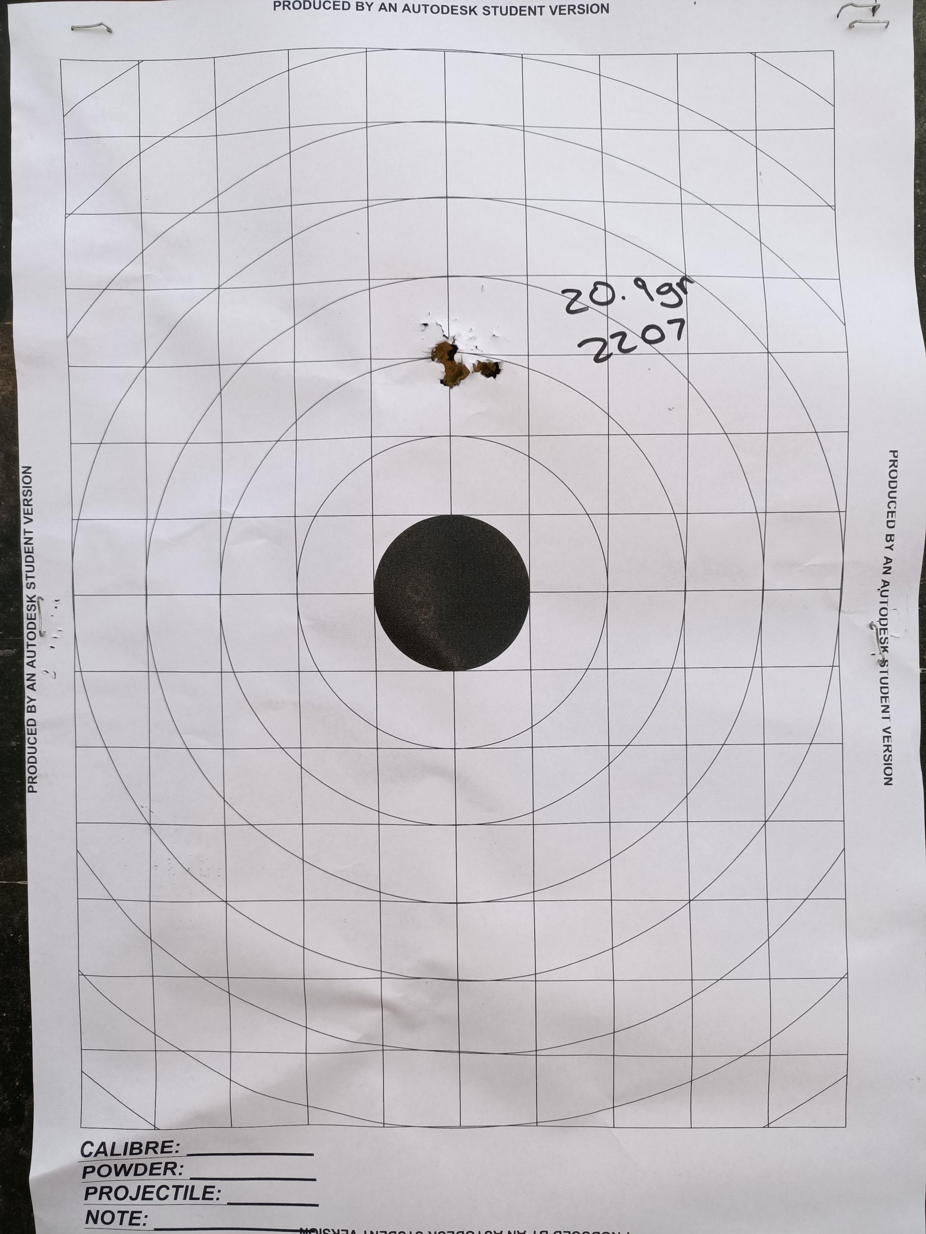

Post by Am88 » 26 Jan 2020, 9:33 pm
So didn't get alot of time but this afternoon tested 20.5gr, 20.7gr and 20.9gr. No primer flattening at 20.9gr either. Tested 4 of each. 20.5gr pretty much came out the same so didn't bother posting. POI doesn't seem to be changing which is good. I also have no doubt in my mind I pulled 1 if not 2 shots on the 20.7 group. Also I forgot my bloody sand bags so was a very poor rest setup I used was a bit unsteady so no doubt it would improve. Also threw in a pic if the rifle, my A1 with Doctor 6x42 Classic. Loving it.
Am88
Posts: 294
Re: OCW test .222
Post by Stix » 27 Jan 2020, 6:34 am
Looks good AM... :thumbsup:
How big are those squares/grid graduations on the target...?
