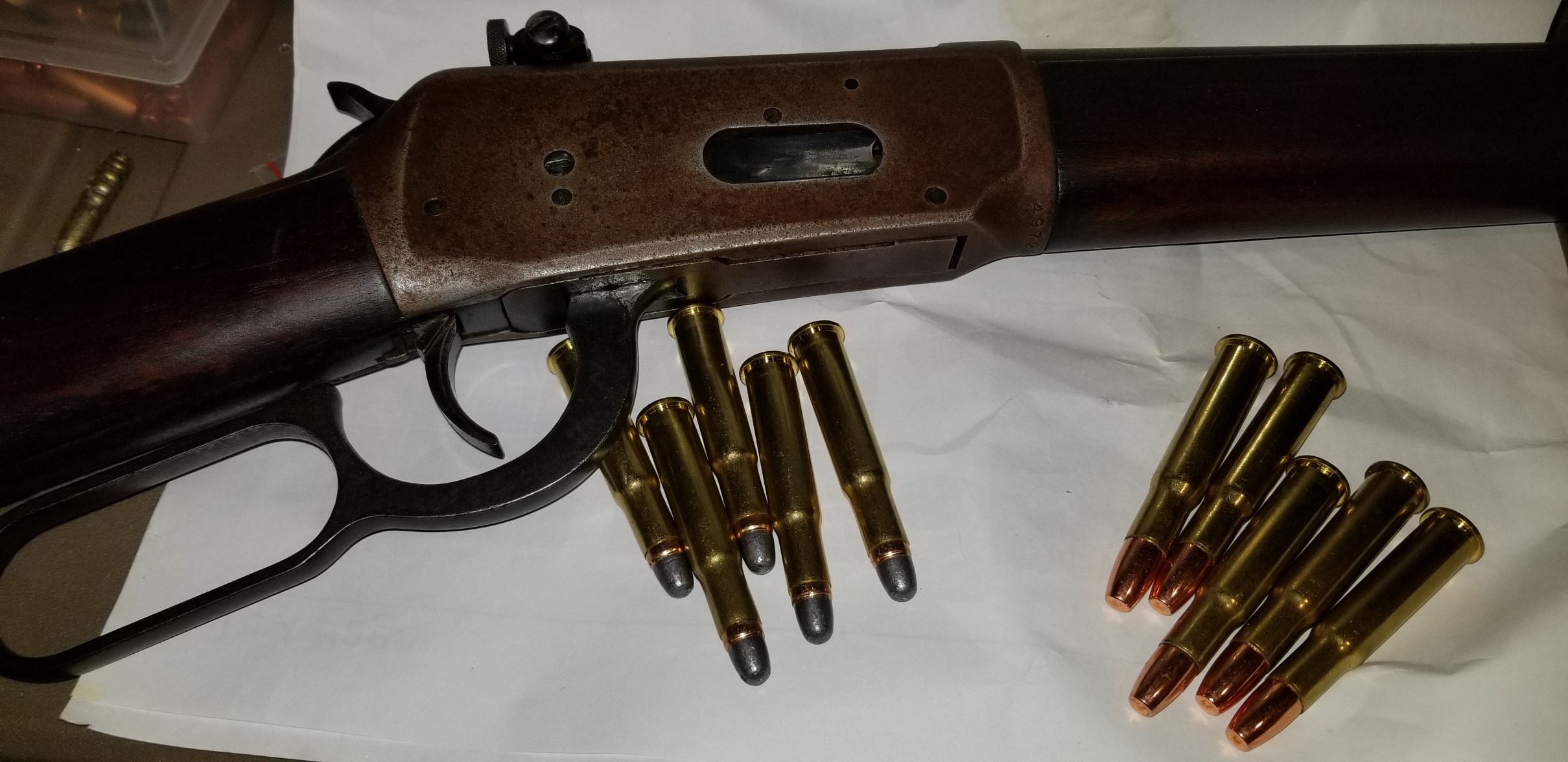

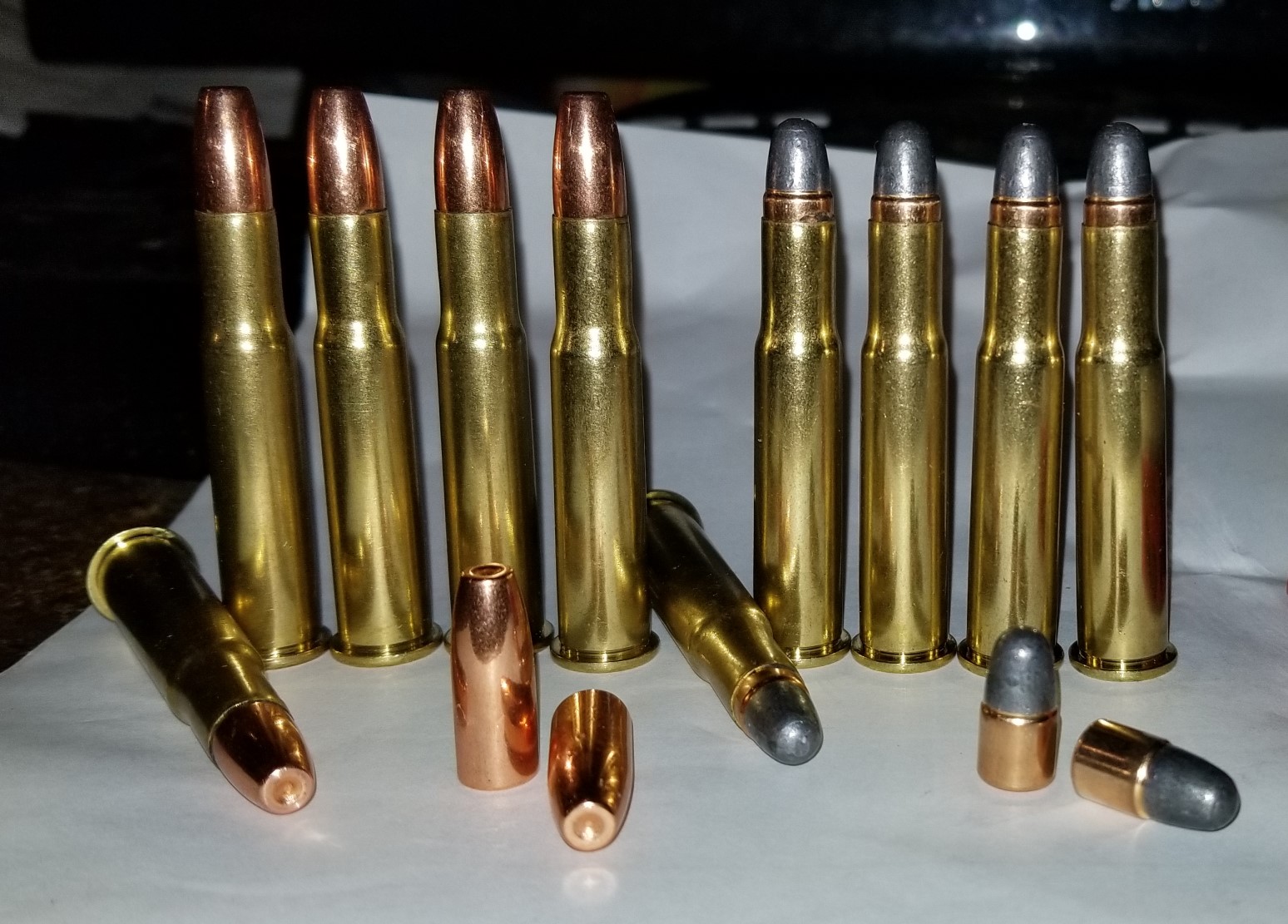

I bashed together five rounds of 6gn of Trailboss under the 150gn Berry's and 100gn Plinker just to get a baseline load velocity so I can work up or down to find 1080fps.
