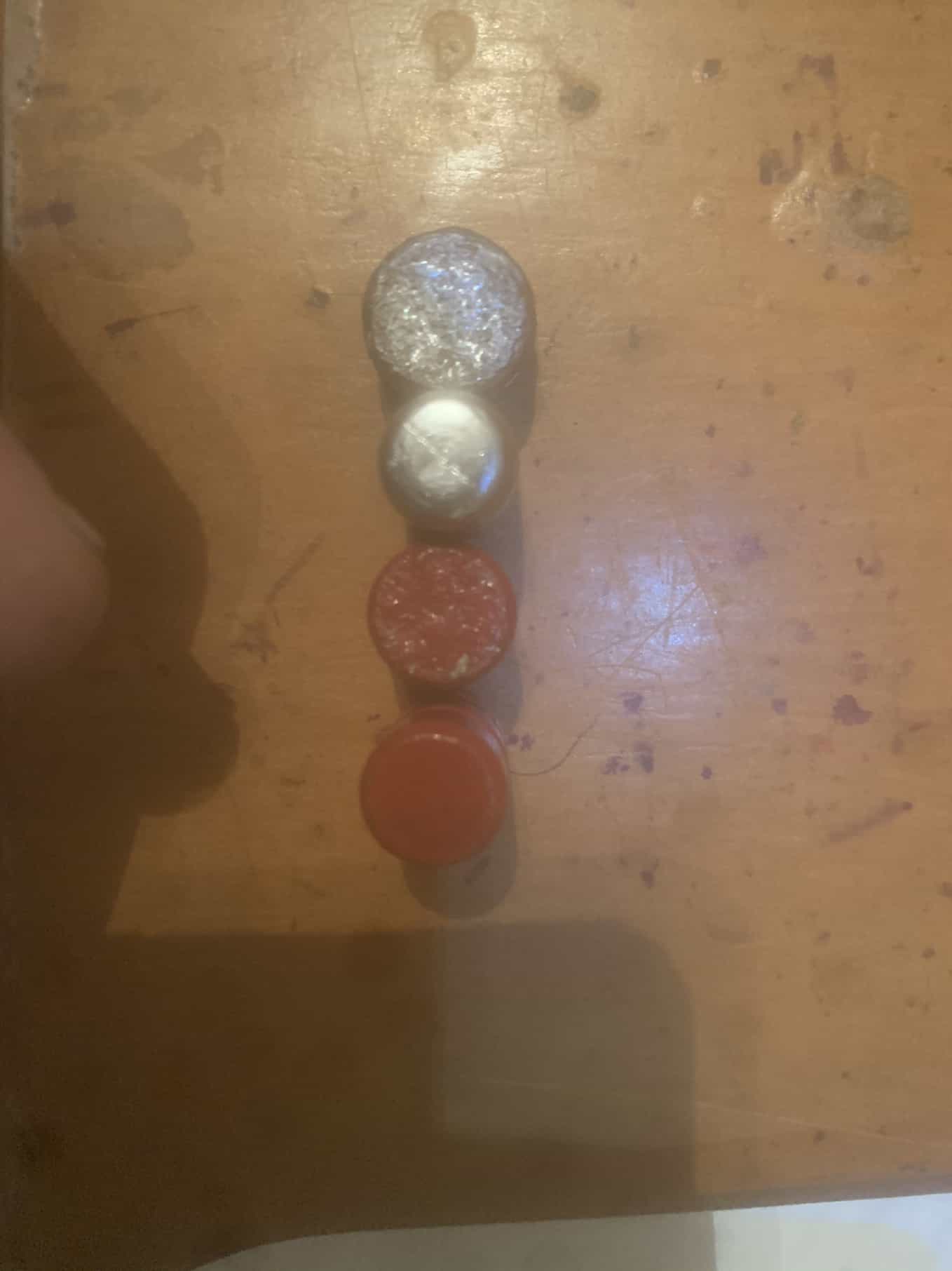

Post by Blr243 » 04 Jun 2021, 9:01 pm
I would never cast for target loads. Too many cheap good products available. I cannot expect reliable expansion from commercial casters who are making hard Bullets to prevent leading. So I’m roof flashing lead 98 and 2 per cent Tin. I dropped a 5 kg weight from 1500 mm onto my own and onto shop bought Bullets. Field resting will have to wait for now. I’m glad to see a significant level of improved flattening in my test of theirs vs mine

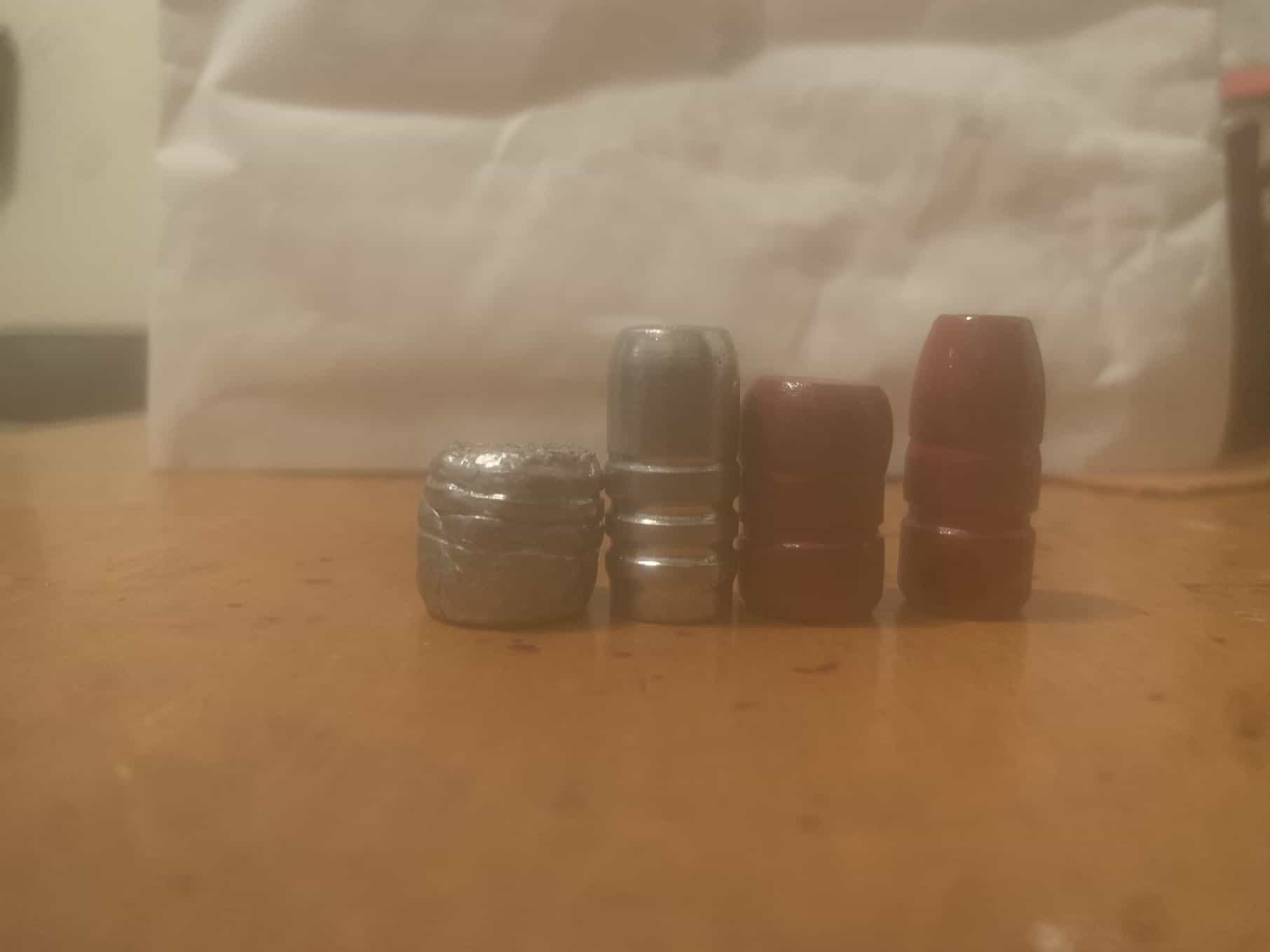

Post by Blr243 » 04 Jun 2021, 9:20 pm
Minus 23 per cent height shop Bullets ....minus 45 per cent height my bullets ... I’m thinking it’s well worth the Effort to do my own. I def won’t be at the range I can’t stand it. Can’t wait to go bush again. Too much bloody work goin on at the moment ... reckon I’ll prob send these 405 bullets at maybe 1250 / 1300 FPS .. I have some gas checks but prob won’t need them. The lube is just the standard CBE LUBE I have not lubed mine yet. I will have to look into that. I’m very new to casting ... pigs are my main focus .. taking ten days off early July. I’m glad u mentioned mp moulds. I heard of them a while back

Re: Casting my own for 4570
Post by Blr243 » 04 Jun 2021, 9:26 pm
I reckon they do ob . If I end up buying a .7 cal musket I’ll prob still be chaseing the flatted disc result. Here’s a pic of the diameter improvement mine vs shop Bullets
Post by LawrenceA » 04 Jun 2021, 9:32 pm
Oldbloke wrote:With 45-70, do they really need to expand? Lol
There is a saying that a 6mm can expand but a 45 dont shrink
But why not have it expand? The old BP express bullets work well for this.
Did some 577-450's for a mate. He took out a massive boar with one of my hollow points and yes it was a perfect mushroom and on the far side under the fighting pad.

Post by LawrenceA » 04 Jun 2021, 9:42 pm
1300fps is std black powder velocities.
You can easily go harder than that if you choose.
Just make sure your bullets are 2 thou over bore.
Basically you can run to about 1500 with pure lead then hard cast to like 1800 then powder coat to about 2000 then gas check to 2200 to 2400sh.
This is just rough.
Get it right and you can push harder if you like.
At 1300fps you wont get the shock and devastation of high velocity calibres. For that you need to get over 2000fps or more.
You will get good penetration and a large damn hole. I use the Gould BP express 330 grain Hollow point going at about 1800 in hard cast in my Marlin. Works well.

Post by Blr243 » 06 Jun 2021, 7:36 am
My home cast 405 4570 Bullets are 98 roof flashing and 2 parts tin. At 1200 FPS in a new marlin 1895 , do I have to lube or powder coat Bullets in order to prevent leading ? Or can I try dry ? ...only lube I have is CBE in a little bottle so I guess it’s very easy and quick to tumble lube them in a plastic container
