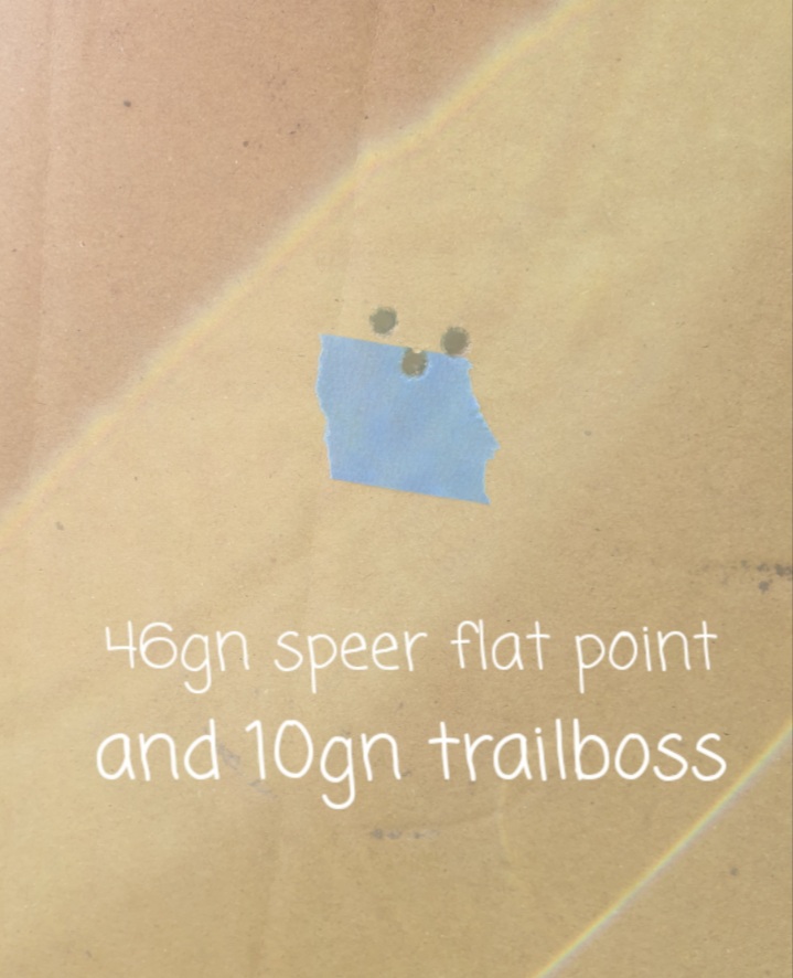

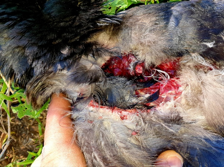

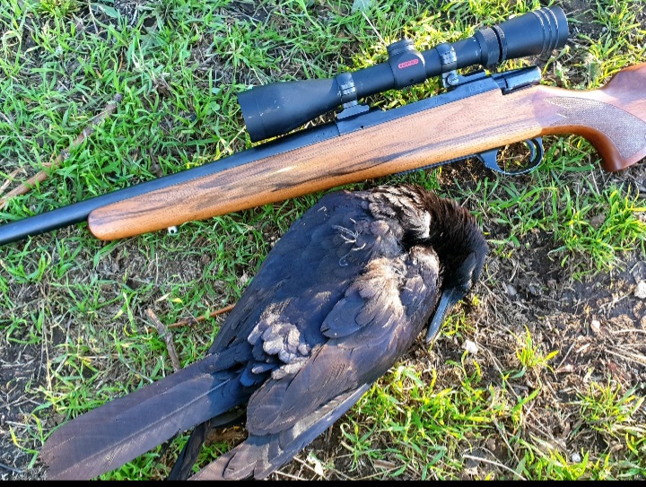

I've just loaded the rough equivalent of 22 mag in my 22-250 using trailboss,its freaking awesome and hits to the same poi at 60m as my full noise loads. No reason at all why you shouldn't experiment with it.
Group at 60m,no change in sight settings
Crow at 20m
Nice sized exit wound
