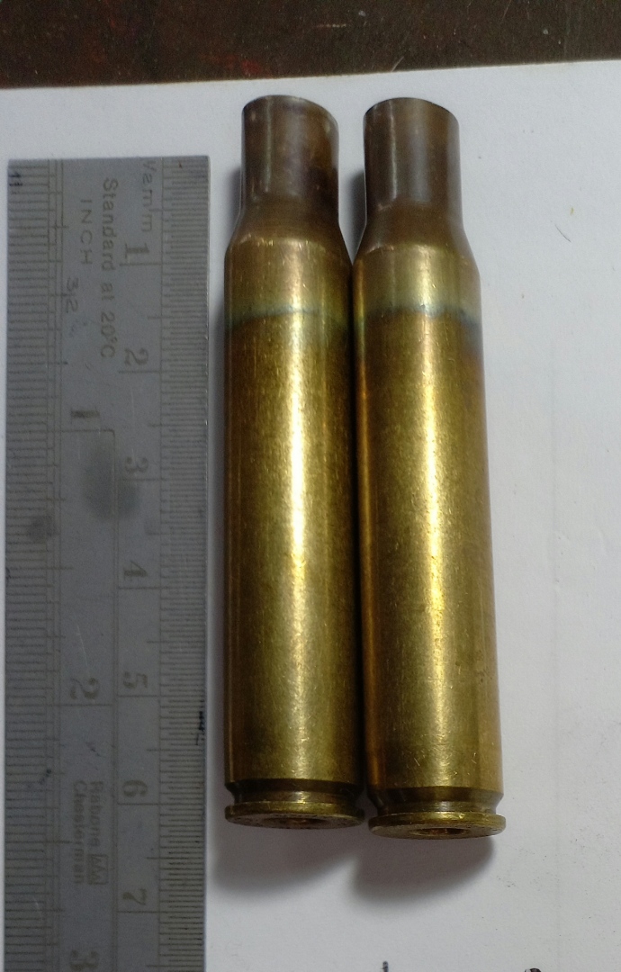

You MUST only anneal to just below the shoulder. Any you have annealed to the head are buggered. Strongly suggest you toss them out.
Are you using a neck die or FLRs die?
Did you lube the cases? Including inside the neck?
A couple of 30.06 cases I annealed. Note the blue line. That's about right.
