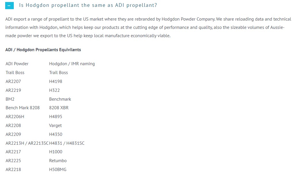

Re: load data request - 6.5 creedmoor hawkie m77
Post by bladeracer » 10 May 2022, 8:14 pm
fxdwg28 wrote:i can't get h4350....2209 i have as well as 2208
thanks ...No1Mk3
hoops
AR2209 is sold in the US as H4350.
AR2208 is Varget in the US.
http://www.adiworldclass.com.au/faq/
ADI Powders.jpg (71.1 KiB) Viewed 10646 times
