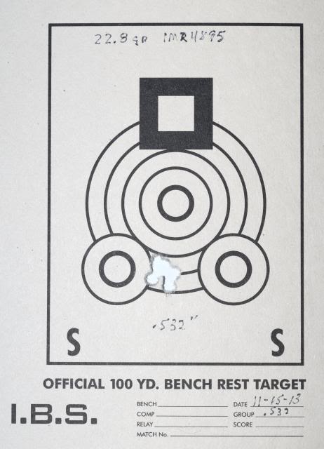

Post by Seconds » 29 Apr 2014, 9:48 am
Googled this for your L461 Vixen.
(from castingboolts website member ColColt, not my data or shooting)
22.8gr IMR4895, 52gr Sierra's 0.53" group.
L461 Vixen group
IMR4895 ADI equivilent is 2206H according to their site.
Not far off your current load, might not take much to tighten it up...

Re: How much difference do primers make to accuracy?
Post by horter » 29 Apr 2014, 9:50 am
Apollo wrote:Really a reduction of that powder load may be more accurate and worth a test dropping the powder load but I think you would more benefit from a change to something fsater like Bench Mark 8208 or Benchmark 2 for that weight bullet.
Looks that way from Seconds group photo too. Only .7gr off the current load, so I will try that first.
Next will be another powder.

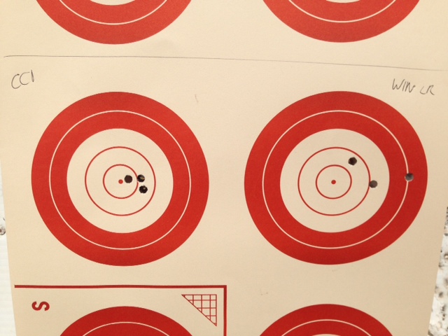

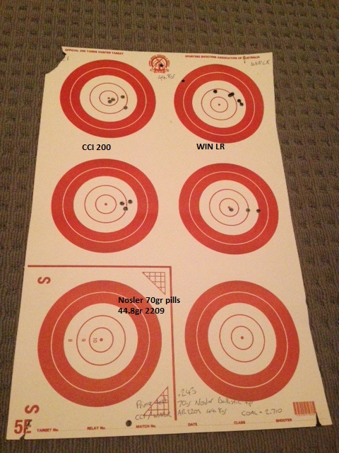

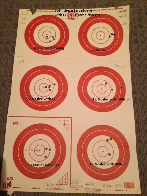

Post by 5Tom » 01 Jun 2014, 9:46 pm
Been out to the range today testing my current recipe. I loaded up the following:
10x rounds with CCI 200 primers @ 44.5gr of charge.
10x rounds with WinLR 200 Primers @ 44.5gr.
10x rounds with CCI 200 primers @ 44.8gr.
10x rounds with WinLR 200 primers @ 44.8gr.
I used only AR2209 powder, all cases were fully prepped, flash holes debured, COAL is 2.710 +/- 0.0015, Projecile used was the Nosler 70gr Ballistic Tip. The picture I uploaded here shows a comparison only between two groups, but the other test groups proved to be rather consistent with this picture. Overall, for me, CCI 200 primers produced tighter groups.

Post by 5Tom » 02 Jun 2014, 9:49 pm
Here's the pic.
As per above post, The hand loads were made as identical as possible with the primer being the only difference. The rest of the test groupings had similar results. Just to add too, before I fired a test group, I waited for the barrel to cool to try to eliminate barrel temperature.

Post by Warrigul » 02 Jun 2014, 10:08 pm
5Tom wrote:Here's the pic.
Is this really a fair test? You would need at least three groups of each for an average and to try and rule out the human factor.
Also seems to be more windage variation than elevation.

Post by 5Tom » 02 Jun 2014, 11:27 pm
Here are the full targets from yesterday.
All with 44.5gr of 2209
photo 1.JPG (125.75 KiB) Viewed 10717 times
All with 44.8gr 2209
photo 2.JPG (126.02 KiB) Viewed 10717 times
As an average, CCI worked best for that load.
