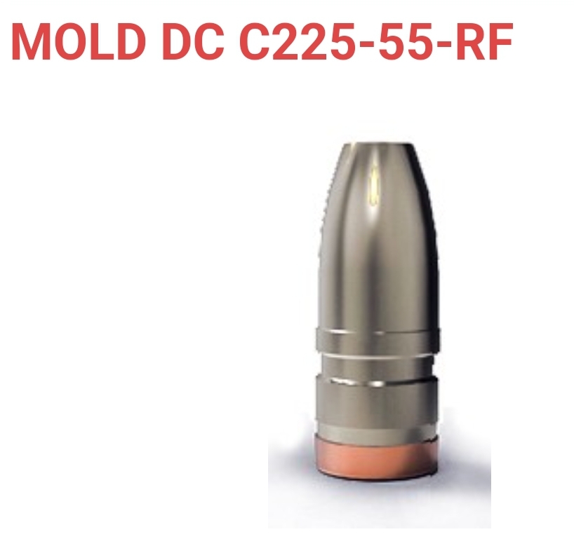

Lee do a mould 55gr .225
If you powder coat you will get those velocities. First 150 bullets you cast will pay for the mould.

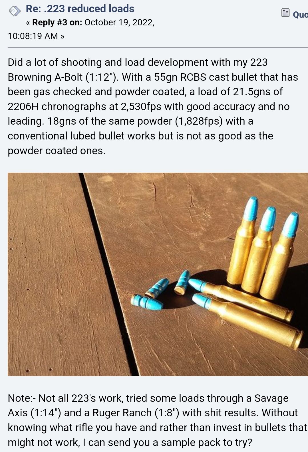

Post by Oldbloke » 04 Nov 2022, 7:57 am
Here.
