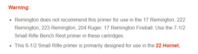

Peter988 wrote:I hand loaded the 222 for 40 years and now the 223 for the last few. I have always just asked the shop for small rifle primers. Now with the difficulty sourcing primers I find I have size 6.5, 7.5 and 4.45mm across different brands. I don’t do any range shooting - only game. The primers all go bang and the rifle shoots minute of head. So no complaints there. Just wondering what the purpose of different sizes is ?
The Remington 6-1/2 is a low-pressure primer, not for use in .223Rem, the 7-1/2 is the standard small rifle primer. Haven't come across 4.45mm, is that RWS?

Post by bladeracer » 24 Nov 2024, 3:54 pm
Peter988 wrote:When you say the 6.5 is not for use in the 223. What is the likely problem ? The 4.45mm are RUAG. Looks German. They came from Cleavers a while back.
https://www.rebelgunworks.com.au/products/remington-small-rifle-primers-6-1-2-100pk?variant=39461574836301
Screenshot 2024-11-24 165312.jpg (28.4 KiB) Viewed 9553 times
Yes, RUAG is RWS.
