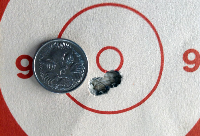

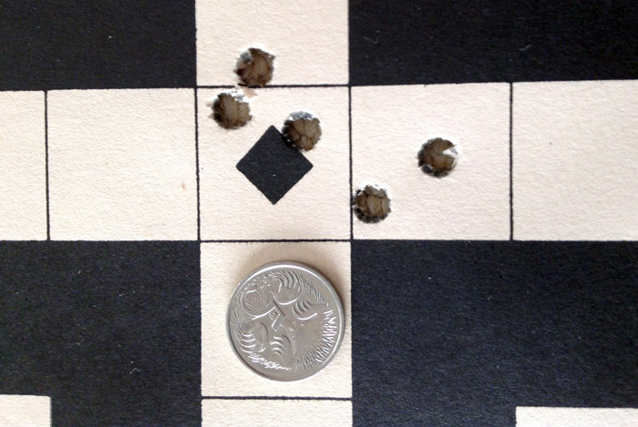

Post by Westy » 13 Jul 2014, 12:03 pm
Well here's something I prepared earlier, what happens to a rifle when the Coal is modified and the right amount of powder and the right primer is used :D :) :D
Picture 1 is 3 @ 100m
6.5x55 Swede 3 shot group
Picture 2 is 5 @ 200 and a old bugger at the trigger :lol: :P :oops:
6.5x55 Swede 5 shot group
Please be patient old Fart trying to work out how to upload Pic's!!!!!! :| :oops: :|
