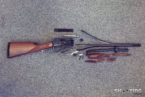

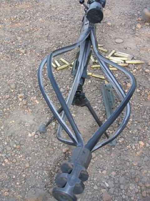

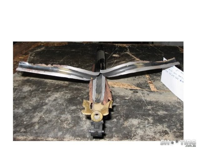

Re: Pressure Signs: What, Where and Why?
Post by deye243 » 10 Feb 2016, 9:16 pm
this is what you call excessive pressure
Posts: 2791
Post by Redwood » 16 Feb 2016, 12:54 pm
Never seen anything like that last photo where the unfolded brass is still embedded :?
