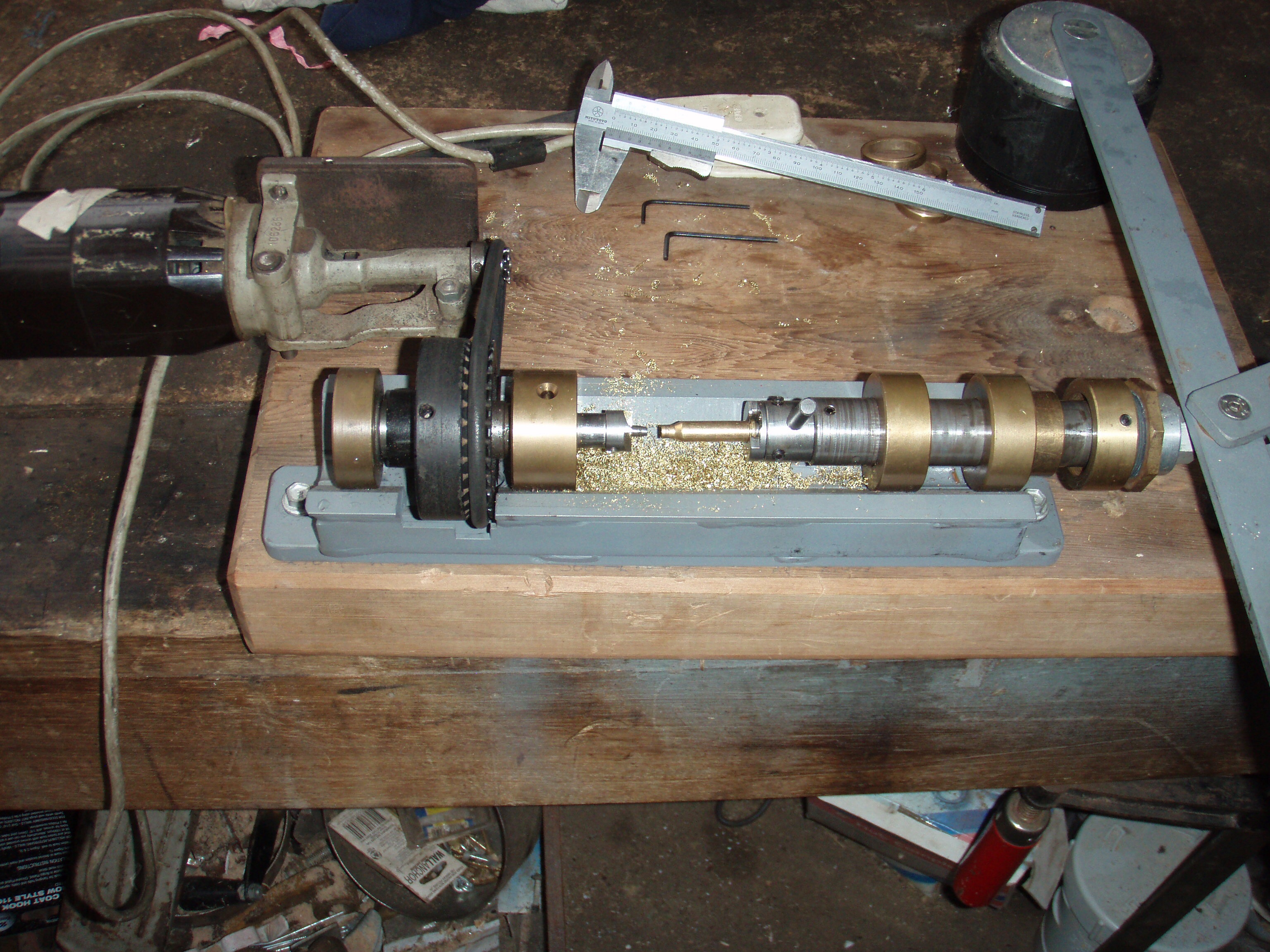

Post by Bills Shed » 23 Jan 2016, 6:09 pm
I built my own. I took the idea of a RCBS trim pro and built a quick change chuck that used a multi start thread, made a sewing machine motor mount to run the cutter and built a adjusting nut that was super large but with a fine thread(.5mm) for easy fine adjustment.
It is the best of all worlds. Quick case change, power cutter with a foot panel, Easy fine adjustments and bomb proof ( solid steel) with roller bearings in the cutter.
If I had to buy one it would be a trim pro as it does most jobs well.

Post by Bills Shed » 03 May 2016, 9:37 am
Bills Shed wrote:
Rakk wrote:Request for pics +1
Sorry Gents,
I will be away from my equipment for the Moment. I will post when I am back on deck.
Bill
OK, for those that wanted a pic, Today I sized my old KHornet cases back down to 17 hornet which made the cases far to long and so out came the trimmer. Made short work of removing that .020+"
As you can see it is not small and does not have pretty colours but it is accurate, solid, easily adjustable and motorised. Cost a bit of time and the rest came out of the scrap bin from various place.

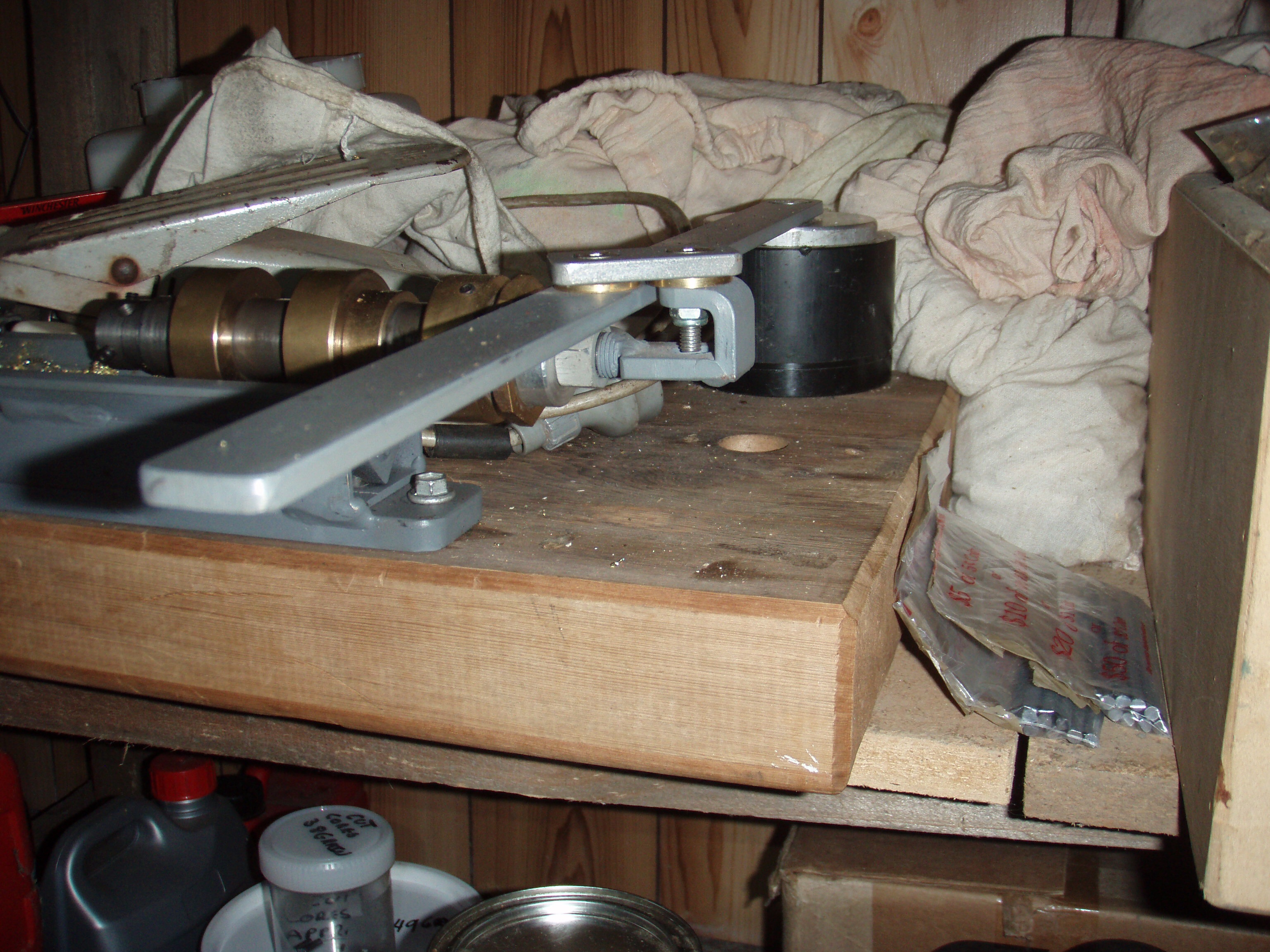

Post by Bills Shed » 06 May 2016, 6:35 pm
Bourt wrote:Any chance of some more pictures showing the arm better?
Would like to see the whole thing.
I think this is what you wanted to see. The actuator arm attaches to the main shaft via a short linkage and bolt setup. I made shouldered brass bushes for each pivot point, but they are really not required but make excellent spacers between mating surfaces. I had lots of time on my hands to tinker with this.
I agree the Lee timer is a good piece of kit if you only need to remove .010" or so but when reforming cases to other calibres and a lot of trimming is involved there is nothing like a motorised carbide cutter. Maybe I need to invest in a modern type cutter head that trims and deburrs at the same time.
Bill

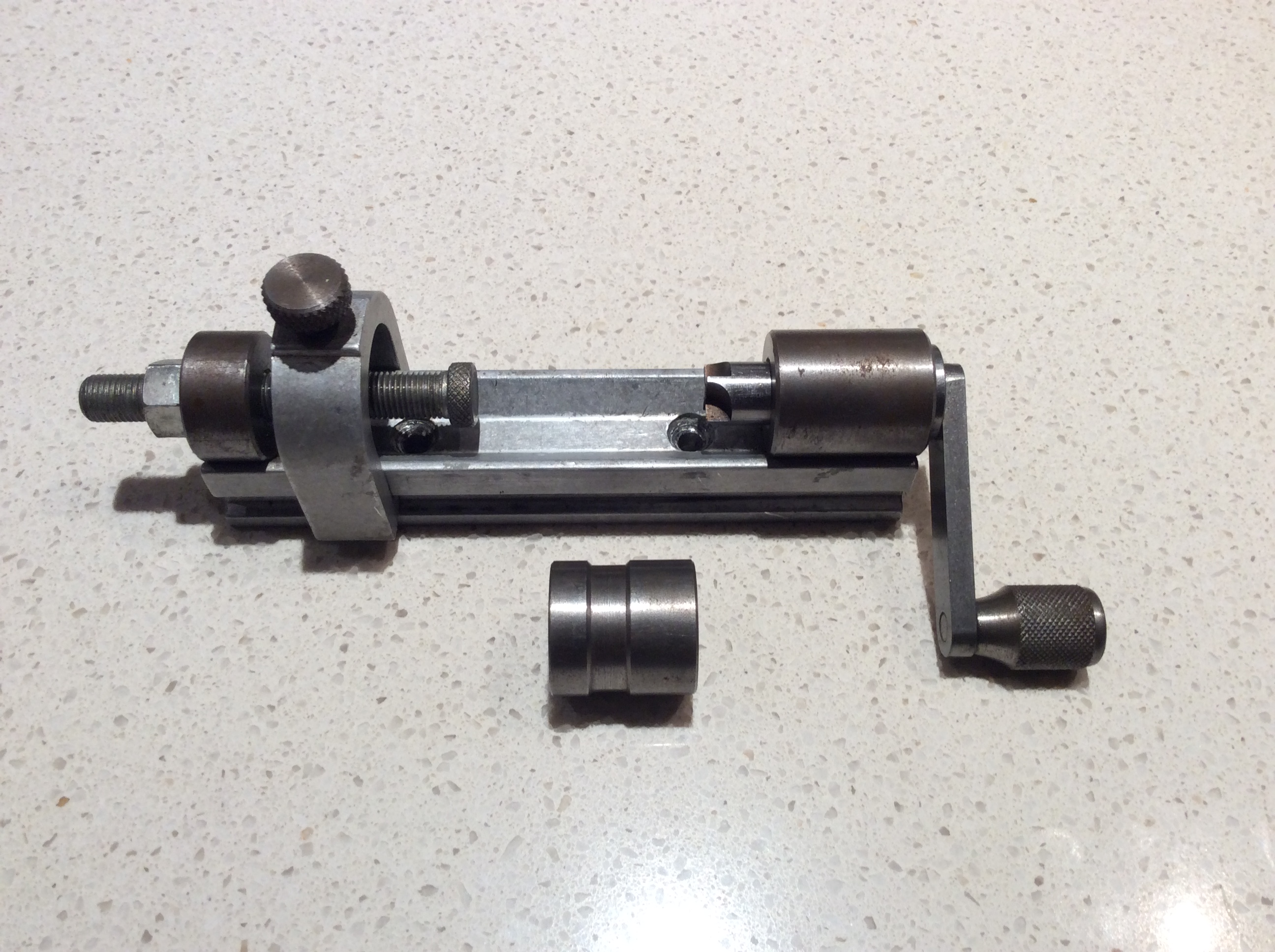

Post by KennyA » 16 Jun 2016, 8:03 pm
Hi, I'm coming back to reloading after about a 25 year absence. I purchased a case trimmer from gun shop in Wodonga Vic. About 25 years ago. It was an Australia made copy of the US made L.E Wilson trimmer. I'm now looking to purchase a 223 case holder, does anyone know here or if I can still purchase the Aussie made product..? The only other option is to purchase one from the states....!!!
Case trimmer...Aussie made

Post by Bills Shed » 17 Jun 2016, 7:14 am
KennyA wrote:Hi, I'm coming back to reloading after about a 25 year absence. I purchased a case trimmer from gun shop in Wodonga Vic. About 25 years ago. It was an Australia made copy of the US made L.E Wilson trimmer. I'm now looking to purchase a 223 case holder, does anyone know here or if I can still purchase the Aussie made product..? The only other option is to purchase one from the states....!!!
Hi KennyA,
I have/ had the exact same trimmer bought from the same shop 28 years back. I was so new to reloading( pre Internet) and did not know anybody that reloaded ammunition. I walked in and asked to look at their trimmers, they showed me that hand trimmer, but failed to tell me that I would need a die/ collet to actually hold the case. I got it home and thought it was very under designed and needed some sort of case support and so turned up a die to fit. Used it for years but hated that little crank handle. Ever since then I have been building better units that had some sort of motorisation.
As to your question, where do you get a die, in Aust ?...... After that I would measure up the the OD of your current die / case holder and find one on the net, try Sinclair reloading. They have great gear. Of you have a machinist friend it would not take much to turn one up. They do not need to be hardened, just of the correct OD and a neat fit at the neck and at the other end so that it is held square and level to the centre line of the cutter.
Bill

Post by KennyA » 24 Jun 2016, 8:14 pm
Thanks Bills shed.......
I have purchased the the 223 case guide from Sinclairs reloading.

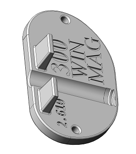

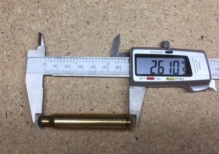

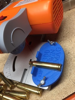

Hi all,
This is a little old, but here is what I did.
I bought a cheap small bench-top mitre drop saw ($80 on eBay) and designed holding plate for my 300 Win Mag cases.
Saw trims to 2.6105 and deburring will bring it back to 2.610.
Happy days.

Re: Case trimming equipment
Post by Bills Shed » 02 Oct 2018, 7:46 pm
Hi Raf,
First welcome to the forum. I like your efforts to find a better way of building a mouse trap. You are right it is a older post...but still relevant.
I have a saw of similar quality and size in my shed. I use it to cut 22 mag cases shorter for 69 gr projectiles. I am sorry to say that it is a real inaccurate piece of kit, and really struggles to make a square cut. There is just to much flex in all the plastic.
I like the idea but I think the quality of the "trim" may leave a bit to be desired. If it works for you, all is well but I would seriously look at a more rigid setup.
Keep us informed on your builds as we are all looking for a faster better way.
