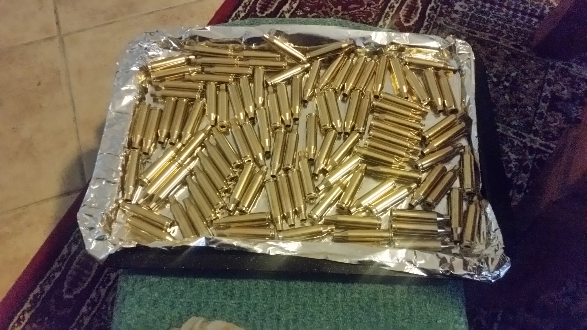

So today was the day i started my reloading journey. With the crap weather that was around today i thought i should have a crack. Set up my dies resized and decaped checked everything twice. Fired up the stainless tumbler i new they worked well but didnt think that well. I was primming the cases mostly ppu shells no big deal i had 20 geco cases man were the primers hard (er) to get home has anyone else reloaded Geco or had the same issue i dont have any concerns. Just though it was odd

Post by Squiddy » 19 Jun 2016, 6:11 pm
Daaaaaaaaayum, shiny!
When you say stainless tumbler do you mean stainless media?

Post by AZZA'S HJ47 » 19 Jun 2016, 6:21 pm
Stainless wet tumbler got it from Aussie sapphire on the sunshine coast gave it about two hours they look better than brand new even the pockets were spotless. Highly recommended.

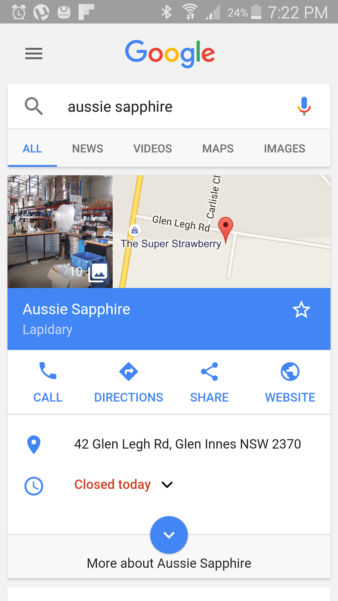

Post by Mongrel » 19 Jun 2016, 7:09 pm
damn there shiny.
I just checked out there site, you said its on the sunny coast, but when i checked there site it says nsw?

Post by AZZA'S HJ47 » 19 Jun 2016, 7:29 pm
Mongrel wrote:damn there shiny.
They may be nsw i thought they were up north i got one of there kits off ebay. 10/10

Post by brett1868 » 20 Jun 2016, 1:18 am
Another convert to wet tumbling I see, once wet you'll never go back to dry. One tip, debur and chamfer post tumbling / drying cause the wet tumbling tends to knock the mouths around a bit though more an issue on the bigger cases. Forget the tin foil lined trays in the oven...get yourself a Sunbeam DT6000 Food dehydrator. I use one for everything from 9mm up to 50BMG, only mod was to buy some aluminium flywire, cut it to size then tie into the trays with fuse wire so the 9mm brass didn't fall through the try. Can dry 2500-3500 9mm cases at a time and I generally give them 8hrs overnight. As a bonus it can dry fruits or make jerky :D

Post by brett1868 » 20 Jun 2016, 4:25 pm
happyhunter wrote:Why the obsession with shiny brass?
Clean brass is happy brass and happy brass performs better :D

Post by brett1868 » 21 Jun 2016, 10:26 am
A bit more of a serious answer, clean brass is an aid to consistency which is key to precision. By starting with brass that's surgically clean both inside and out you are removing a few variables. Carbon build up within the primer pocket can lead to inconsistent seating depths and flash patern into case. Carbon build up within the case will affect the "Burn" differently which leads to variations in velocity and therefore precision. Carbon build up on the case neck / shoulder will affect case clamping force on the chamber and impact velocity, leading to lower precision. I'm chasing less than 10fps deviation per 5 shot group which takes a huge amount of prep to achieve (in the calibres I shoot), my best so far is 15fps standard deviation (5 shot) though I can get that consistently. Case prep is but a part of a larger process, Bullet prep is just as time consuming but that's a whole other topic.
