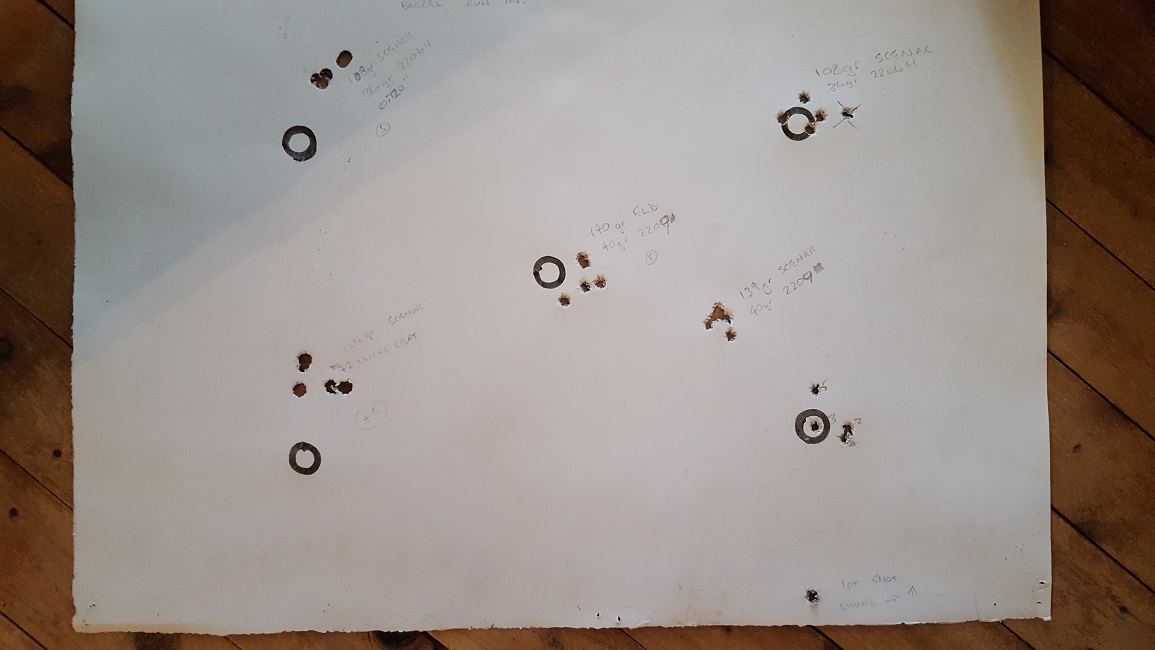

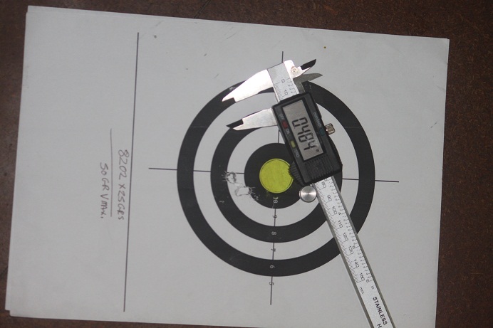

Post by deadkitty » 27 Sep 2016, 6:06 pm
I bought the same kit from Midway via ebay, just added the collet die this week, but the standard Lee die set has been giving me good results ....for a novice reloader like myself.... I did improve groups by using the crimping die....still aiming for a load that gives me the almost mythical one ragged hole though. .223 Savage 50gr Vmax, best powder so far is 2206H

Re: which dies
Post by Bills Shed » 27 Sep 2016, 6:40 pm
deadkitty wrote:I bought the same kit from Midway via ebay, just added the collet die this week, but the standard Lee die set has been giving me good results ....for a novice reloader like myself.... I did improve groups by using the crimping die....still aiming for a load that gives me the almost mythical one ragged hole though. .223 Savage 50gr Vmax, best powder so far is 2206H
Please do not to wrapped around the axles about trying to get a group with all holes touching. Reality will bite and you can spend a lot of time and money trying to achieve something you do not need. Think about what you really are going to use the rifle for. If you are a paper punching then tight groups look impressive but if you are trying to put a hole in a foxes chest, it will not care where the next four shots go. It is the first one that counts. MOA is usually more than good enough for hunting purposes.

Re: which dies
Post by Gamerancher » 27 Sep 2016, 6:53 pm
Well said Bill, I've seen blokes trying to get a "cheap" hunting rifle to shoot miracle one hole groups. Once in a while they almost fluke one, most of the time they don't.
The benchrest boys spend upwards of $5-6k on a rifle, over a grand on rests and then many years/shots learning how to load, tune and read wind to shoot tiny groups.
Anything around an inch @ 100m is more than adequate for hunting purposes.

Re: which dies
Post by deadkitty » 27 Sep 2016, 7:19 pm
Bill, yep you're right of course, but I really enjoy reloading in between shooting the odd dog, fox and cat, A guy needs a hobby....other than shooting fishing and chasing the missus around the house.....

Re: which dies
Post by deadkitty » 28 Sep 2016, 4:34 pm
Gamerancher wrote:Well said Bill, I've seen blokes trying to get a "cheap" hunting rifle to shoot miracle one hole groups. Once in a while they almost fluke one, most of the time they don't.
Yeah and I've seen blokes spend a motza on a fancy gun who can't shoot for s**t...... here's what the basic Lee kit can do with a novice reloader behind it...before I try the new collett die

Re: which dies
Post by Mongrel » 28 Sep 2016, 6:17 pm
Nice groups there kitty
Was that at 100m?

These groups were shot @ 100m while running in my latest build, 6.5 Creedmoor on a Model 70 Winchester action. Loaded using LEE DIES. After bore sighting, first shot went low(see bottom rhs) adjusted up and got on with it. They are 1/2 inch circles. She looks like she might shoot. :drinks:
I'll be using it this week-end at the Silhouette Nationals in Canberra. Anyone interested in coming along? :friends:
6.5 Creedmoor run-in.jpg (149.25 KiB) Viewed 8167 times
