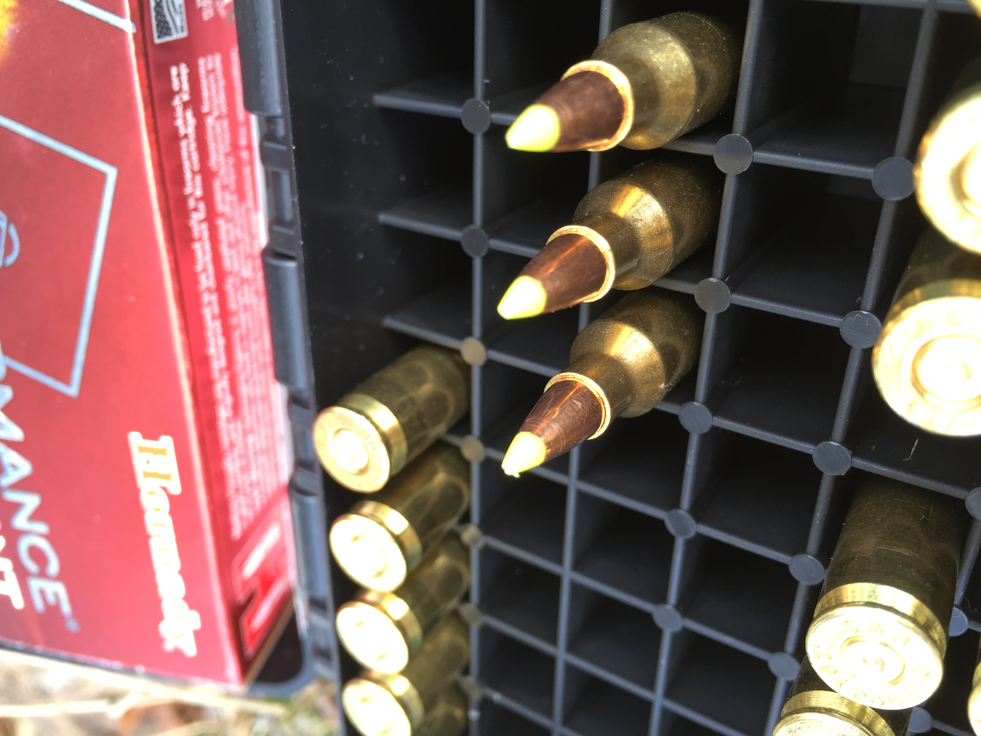

Still early days. But I loaded up some 32gr Zmax and 40gr Vmax. I have a new Howa mini action which I believe has a 1 in 9 twist. I put 12 shots of factory through to sight I and tried some staring loads using AR2208. I have benchmark 8208 and AR2206H. But I thought I'd start somewhere and I have heaps of AR2208. The 32 Zmax were fine. But the 40gr Vmax have a problem. See pictures (having trouble loading- pictures) will try again

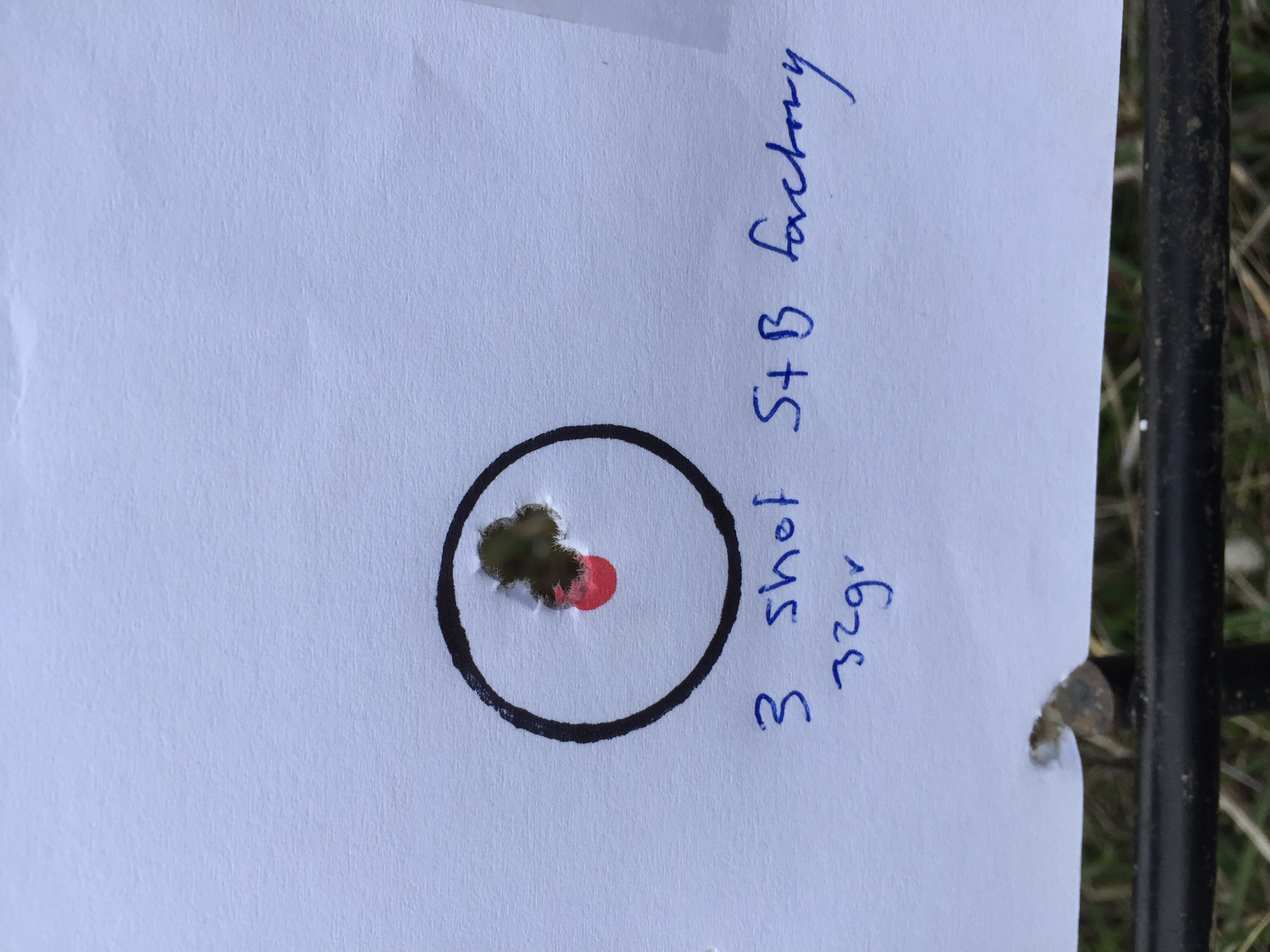

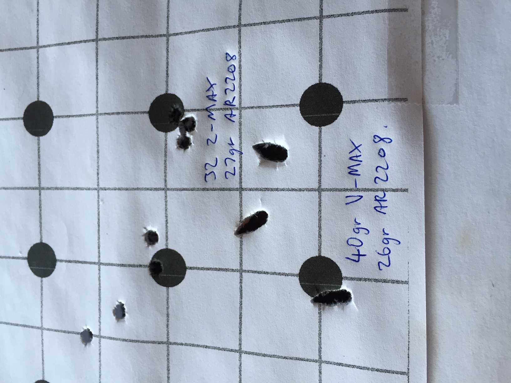

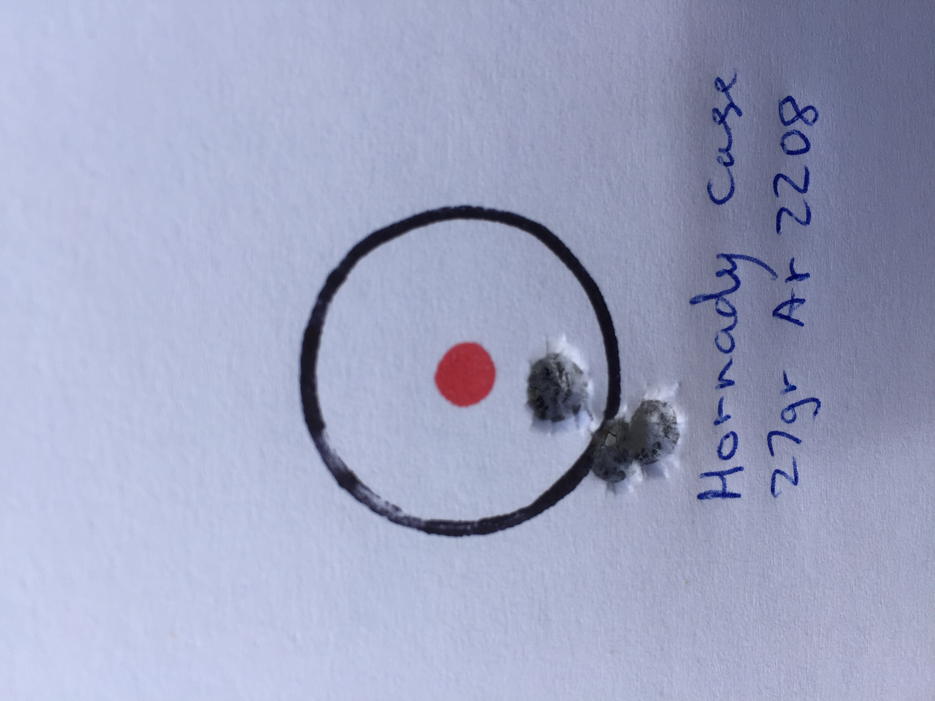

Well three velocity checks in I decided I won't be using my Magneto speed of my 204 again. With the 40gr VMax I'd already decided it would be a bit risky with the bullet tumbling so dramatically.
Third shot in using 32gr loaded with Ar2208 27gr bullet failed to reach target (splatter or muzzle blast slightly marked Magneto speed) first two shots were fine. Bullets holes touching each other 3180fps average.
Tried the 40gr Vmax's loaded with 26.6grs of benchmark 8208. I'd only loaded two. Both tumbled. Gun doesn't like 40gr Vmax's
Tried both factory Hornady and Sellior bellot and both shot incredably well. Probably .3 or .4 (only at 63 metres)
Fire the rest of AR2208 loaded ammo. Not as good factory but still only half an inch group size.
Still have no idea what caused 32gr Zmax to fail to reach target. The only think I noticed is a slight bit of damage to some of the ballistic tip from a sharp edge inside the Lee bullet seating die. Will try clean up sharp edge inside die. Only a very slight nick on the tip. Dunno?

Post by Cooper » 07 May 2017, 3:17 pm
Not a very clear picture of damage to ballistic tips

Post by bigfellascott » 07 May 2017, 3:38 pm
I'd be upping the charge if it's only reaching 3100fps with the 32s way too slow - you should be able to get those up around 3800fps if not more. They factory shoots well by the looks of it any idea of velocities with those?

Post by Apollo » 07 May 2017, 6:45 pm
3,100 fps is even slow for a 40gr Bullet in a .204 Ruger. For 32gr Bullets you should be around 4,000 fps or better. Even mild loads should be above 3,900 fps.

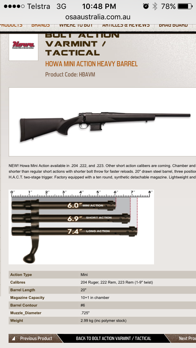

According to this the Howa .204 is a 12"-twist?
http://www.howarifles.eu/resources/HOWA.pdf

Post by Cooper » 08 May 2017, 10:54 pm
That must be old? I thought all the Howa .223 were 1:9 in now not 1:12.
I have the mini action which I was told was 1:9. As per pic. Guess I need to measure twist to confirm!
Cooper

Post by Apollo » 08 May 2017, 11:03 pm
The link is to Howa 1500 Rifles. That's NOT what is being discussed here.
"Cooper" has a Howa Mini Action with a Heavy Barrel which is 20" and 1:9 Twist Rate.
http://www.osaaustralia.com.au/products ... vy-barrel/
Any of the info about loads mentioned so far are from people with a Howa 1500 Short Action 1:12 Twist and 24" Barrels as best I can tell. They aren't the same beast.

Post by bladeracer » 09 May 2017, 3:38 am
Cooper wrote:That must be old? I thought all the Howa .223 were 1:9 in now not 1:12.
Yes, the .223 is 9" twist - but I'm unable to find anything anywhere that indicates any Howa .204 as being anything other than 12" twist rate.
http://www.brownells.com/rifle-parts/receiver-parts/receivers/barreled-receivers/1500-barreled-action-mini-action-heavy-blue-204-ruger-prod94580.aspx?psize=96&avs%7cManufacturer_1=HOWA
I did see on a forum somebody that custom barreled one to a 10" twist.
I would definitely measure your twist yourself.

Post by Cooper » 21 May 2017, 7:30 pm
Well I'm shooting half inch groups with both 8208 and 2206h. I actually had reduce the load with 8208. Now running 27.3gr which is below the staring load in the ADI manual. I've ordered 1000 32gr Z max and need to get some new Norma or Noslar brass as I've already had a few neck splits with the Hornady brass.
