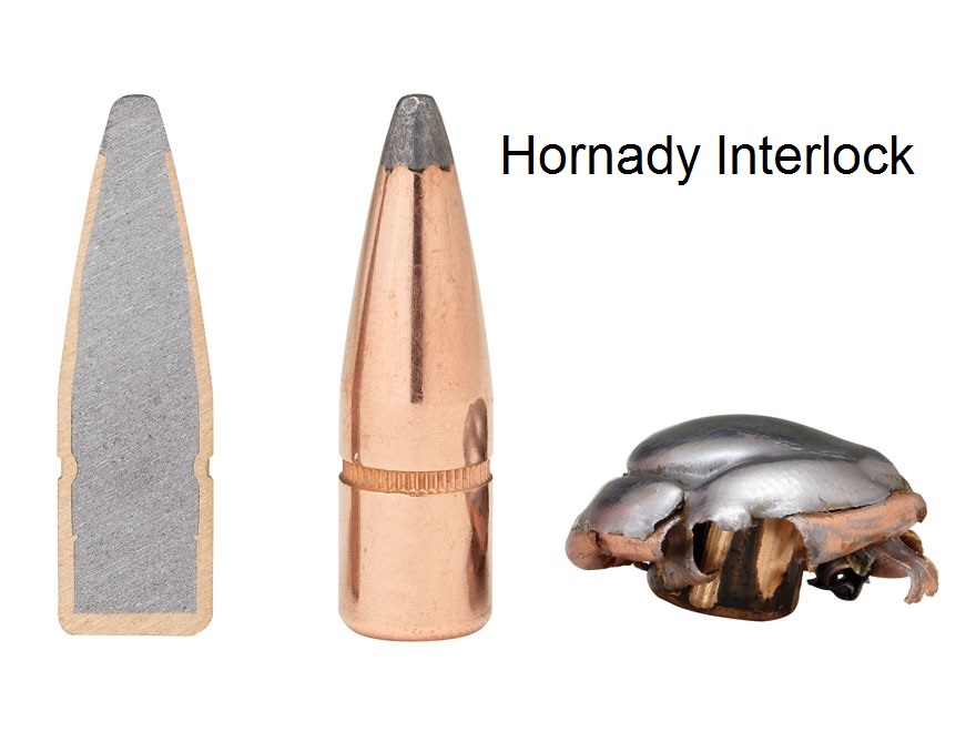

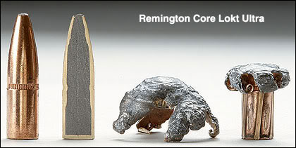

Yep, those Lee kits are great value. There is also an Anniversary kit, with just a few differences to the challenger kit. Both about $250. I don't have one but all reports say they are good.
For a 308 I would settle on a "General Purpose load first" say a 150 to 170 gn projectile. This will take care of goats, pigs & sambar if placement is good and range sensible. (up to 200 mtrs) The 308 will struggle with a 180 gn projectile. Hornady interlocks or similar are OK. If you want to pay more.
AR 2208 is about as flexible a propellant that you can get. I load my 223 & 3006 using it. It can be used for 338 too. May not get the very best result but always pretty good and saves on wastage or the possibility of getting confused with loads resulting in a huge fack up. Get on line and down load the ADI loading manual.
PS this is not rocket science.
This link to another topic will provide links to a couple of free manuals off the www
viewtopic.php?f=3&t=7963
Hornady Interlock.jpg (83.73 KiB) Viewed 10472 times
Rem corelok tultra.jpg (21.81 KiB) Viewed 10472 times
