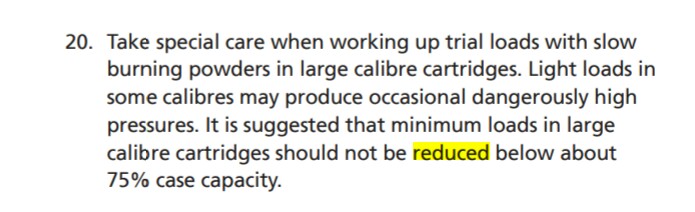

First I will post this from ADI.
reduced loads .jpg (39.15 KiB) Viewed 9875 times
Reduced loads 60% max 2206H.JPG (72.59 KiB) Viewed 9875 times

Reducing below powder manufacture minimum should be discouraged. You can cause an explosion rather than a burn if too much case capacity is open to a certain powders. You’ll blow your face off. Else you’ll get incomplete burning and useless loads.
southeast varmiter
Posts: 271
Re: Loading Below Minimum
Post by Oldbloke » 26 Mar 2018, 5:28 pm
southeast varmiter wrote:Reducing below powder manufacture minimum should be discouraged. You can cause an explosion rather than a burn if too much case capacity is open to a certain powders. You’ll blow your face off. Else you’ll get incomplete burning and useless loads.
Correct. It is revered to as a SEE. (secondary explosion effect) But if you follow the above that I posted should be OK.

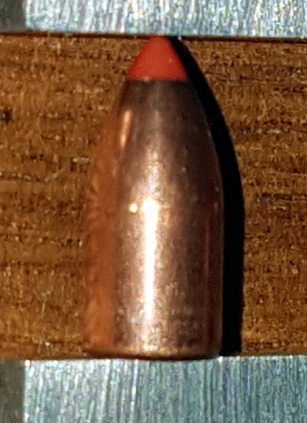

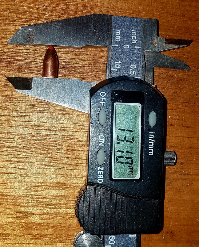

Post by Gaznazdiak » 26 Mar 2018, 8:51 pm
Sorry, should have mentioned, but I was lurking on the hill above the sheds, just over 100m and had missed 2 in a row, so I just banged the question up and got busy and forgot about it.
It's for my Howa 1500 .223, 24" 1:9 twist.
I have been worried about not seating the 35gn Hornady V-Max deep enough as they are so short, flat bottomed and only 13mm long, with only 7mm of bearing surface.
I mostly use Nosler 50gn Ballistic Varmint, as the rifle really seems to like them and they group about the size of a 1c piece at 100, but when I'm shooting around the sheds I've had the solid base of the 50's go through the rabbits and hole the sheds, so I tried the 35's as when they hit only tiny shrapnel exits with the innards.
I weight batch all the brass to within .5gn and keep the batches together till they are done and make sure the ammo stays as close to room temp as possible, yet I was getting no end of flyers. Of the 60 of them I've fired at rabbits only 21 were hits, yet with the 50's it's closer to 95% hits from 100-300m.

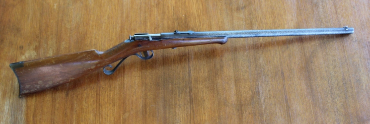

As to the .22, I have one, he's actually my favourite rifle, having been given to me by my Mum for my 13th birthday, but he's a Winchester Model 04, somewhere between 91 and 114 years old. He still shoots as straight as ever, but a combination of iron sights and my multifocal specs mean I can either see the sights in focus or the target but not both, and I'm like a bat without the specs. And no way I'm going to spoil him by modifying to fit a scope.
I have been considering a cheapo .22 to put a scope on just for the shed area, but I also have a 29yo Range Rover with 460,000kms on it that has been a money pit for the last year, and it's a 35km walk to town, so I've had to be boringly sensible.
