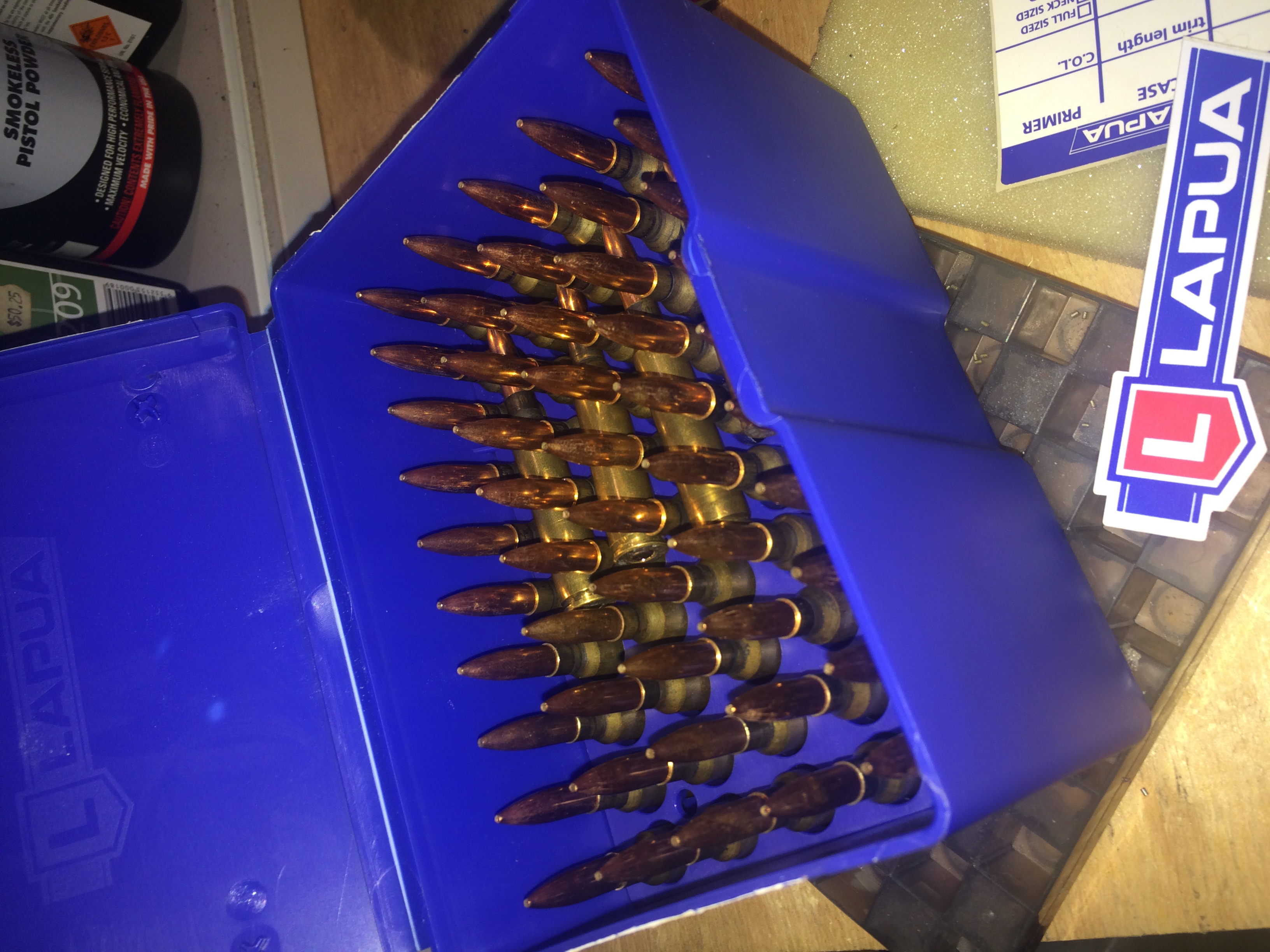

Post by Lumbajak » 06 Jan 2018, 3:34 pm
Cooked up a batch fresh off the press..
Lapua brass, 140gr Nosler cc, fed 210 primer with a pinch of 2209 seasoned to taste.
Best served hot. :thumbsup:
