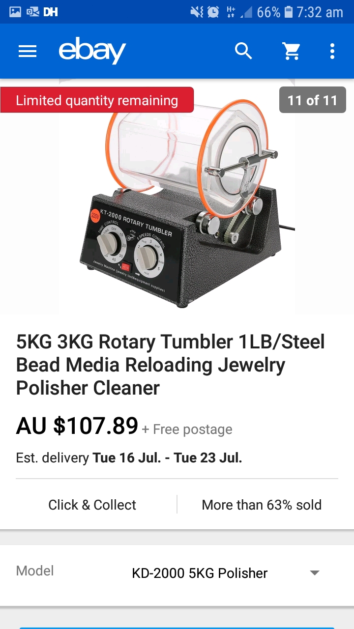

I’ve got an ultrasonic cleaner and it’s okay - not great...
Anyone tried these cheap as tumblers?
https://www.ebay.com.au/itm/5KG-3KG-Rot ... 9-YovZwYoA

yep thats what ive got...
My lid leaks though...pitfa...!!
S o i put hot water in it & pressure helps seal it after the water cools down..but get a good bit of water out first. :thumbsdown:
But ive not heard of anyone else with the same problem...
Wow thats cheap compared to what i paid a few years ago...!!!

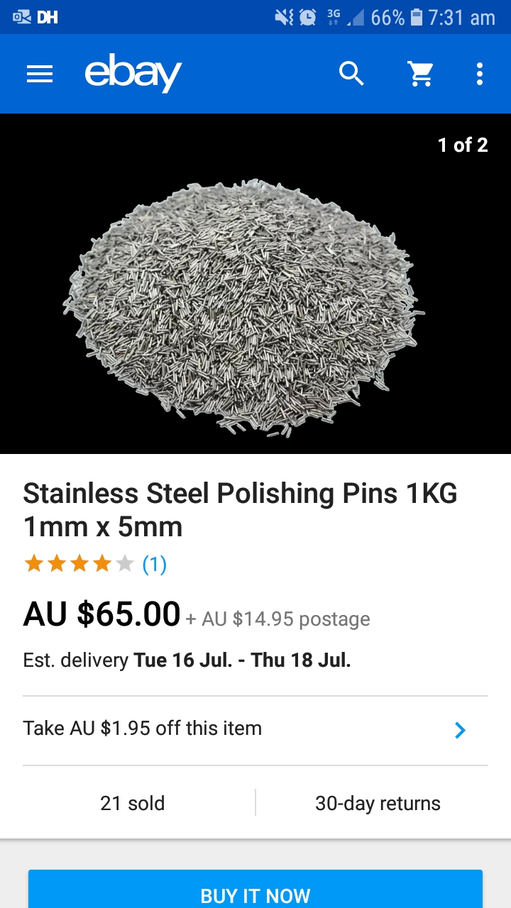

Stix wrote:I didnt even know there were different sized pins available...so i use whatever my tumbler came with...1mm dia x 10mm long from memory...
I do 204, 22-250 & 308 with them...
Thanks Stix
That's about the same as the one other internet search result that I found that said .040" x .250"
I don't want to end up with 50 cases filled with jammed ss pins.

I have that exact tumbler. It has changed my life. It does a fabulous job for next to no dollars. I use car wash with citric acid and the brass comes out very shiny. Initially had a bit of an issue with tarnishing but I now dump them into a towel to roughly dry and then give them a spray with wd40 and then ruffle them in the towel again and there is enough of a coating to stop tarnishing. One tip though, fill the barrel with water completely as it needs that weight to hold it down on the rubber wheels . If you use less water it slips on the drive wheel.

How do you find a 3 kilo size?
Will the 3 kilo comfortably take 50 x 308 / 253 cases?
I'm yet to decide between 3 and 5 kilos, I won't be cleaning more than 50 at a time.

on_one_wheel wrote:How do you find a 3 kilo size?
Ive found my tumbler is more efficient the fuller it is...
So i try do a couple of batches of diff cartridges at s time...so for example 50x304 & 50x7-08...
So if you only going to do 50 at a time, maybe go the smaller one...
Re: Wet tumbling with stainless steel media
Post by deanp100 » 13 Jul 2019, 8:26 am
The 3 kg will take 50 308s easily, probably a lot more. My biggest batch was probably 150 mixed 222, 221 and some 308’s. Only took 20 mins or so.
Just checked my eBay profile. Mine was listed as a 4 kg unit. Looks the same as the other ad. Looks like you can buy a large 4 kg or a small 4 kg.

I had a 3kg one and I dont think it took the 50 308 cases easily. I would say just. The 3 kg one is also much harder to use. The opening is hard to get your hand in and out of. My 3 kg one could not hold as many pins worst of all it broke after maybe just a year.
I then purchased a 5kg one and it really is much better, stronger and will take the 50 308 cases without a problem. You dont want all the cases and pins jammed in there. The units work much better with some space so everything can mix and move easily.

Hi Sungazer, why do you think the 5kg version much better than the 3gk? Is it simply the bigger size or is there something else about them?
I don't go through a lot of cartridges so the 3kg version might suffice. The other alternative is the Lortone 3A Tumbler from Aussie Saphire which looks like a good quality unit but is nearly double the price.

Question regarding the 3 or 5kg ones. How many pins do you put in the jar and anyone got a link for good pins on Ebay

I just use the ball bearings they sent and I tip,them all in. With the barrel on its end they are probably an inch deep.

Wondering though if the ball bearing ones will clean out the primer pockets as well as the little stainless steel pins? ie the ball bearings aren't going to get into the corners of the primer part of the case etc like the pins will. But hell the stainless pins are pretty expensive though ... cheapest I've found is the $45 for 1kg from Saphire.

I guess the primer pockets aren’t shiny like the rest of the case but the chemicals alone give them a good clean

Post by sungazer » 13 Jul 2019, 10:59 pm
In the 3 kg one I purchased it came with no pins as advertised. I kicked up a stink with the ebay seller and got a part refund. With that I put it towards the kg of Lyman pins which I had already ordered. These are great no rust what so ever I keep them in the tumbler under water all the time. I did get pins with the 5Kg one dont think I have used any. This was through the Australian seller he changes plugs and may swap out pins. Most I have heard that come cheap with pins or balls the pins rust and the balls dont work very well.
The 5kg unit is a bit larger in every way and I think it is a stronger machine, however being Chinese longevity I think is always hit and miss. My 3kg tub did leak which I fixed with silicon. The thing I least liked about it was the size of the tub and being able to get cases out with you hand. I would never go back just absolutely no pros to the 3 kg unit.

The pins cost almost the same as the tumbler :lol:
Post by Mark » 14 Jul 2019, 8:13 am
These are the pins i use, from .222 to 300wm no dramas
https://www.gemworld.com.au/products/mo ... t-1kg-pins

Look like pop rivet pins cut in half
